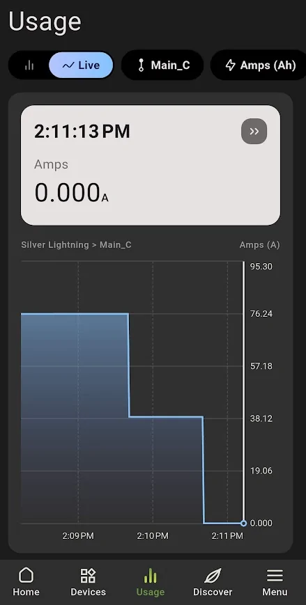

Yesterday afternoon I also was able to derate from 80 amps to 70 amps and the FCSP complies for the entire charging session, 10% 80 to 90% session, actual throughput was ~64 amps.
I've since updated it to 80 amps, looking forward to a future charging session, maybe today or Thursday to see if it went back to my normal 80 amp setting, in the past these adjustments were not reliable.
I'll try bumping mine back up tonight as well. If that takes, I'll also try adjusting mid charge. Thus far, the history still seems to be accurate on both the FordPass and Insight page of the FCSP.

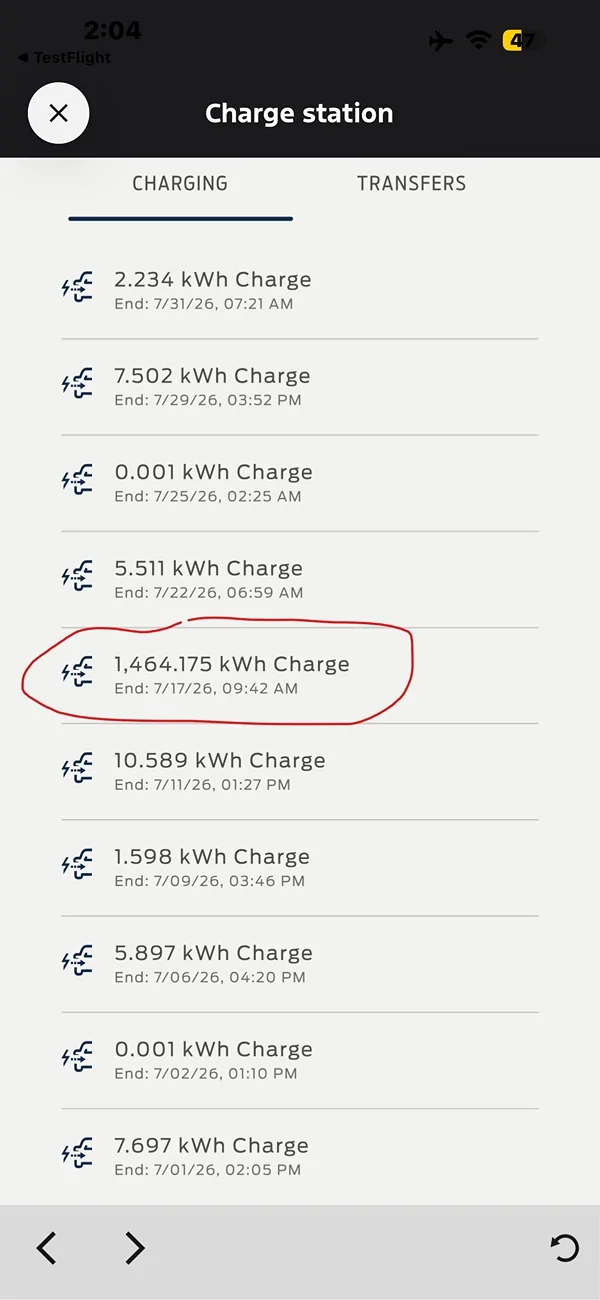

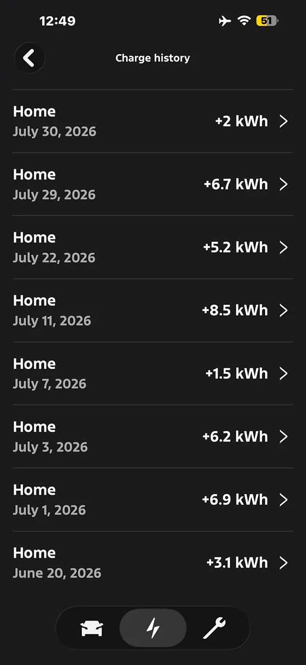

Here's what the Charging History section on the Charging tab in the Ford app says was my truck's true electric usage for the month of July. A total of 37 kWh.
Remember, that's battery KWH as opposed to AC power consumption, so if the 37 is accurate, then around 41 AC consumption. Confirm that you drove less than 100 miles in the entire month?
2,836
3,121

Actually, instead of going to the Cost tab in the Ford app under Charge Station, if one goes to Insights, Charging, picks the month view and then below the graph, one taps "View All Events," one gets a daily view the appears to show the TOTAL power consumption by the FCSP, as opposed to the Charging History view, which, as you say, is likely just kWh added to the HVB. Below is the View All Events vs. the Charging History view for the month of July. One can see in the Charge Station, Insights, Charging History that a single spurious event is reported on 7/17/26 where the truck apparently consumed 1,464 kWh in one day!
BTW, I've now joined the Lost Connection crowd. Can't connect to FCSP itself either in the Ford app or the Ford CSP Pro Setup app.

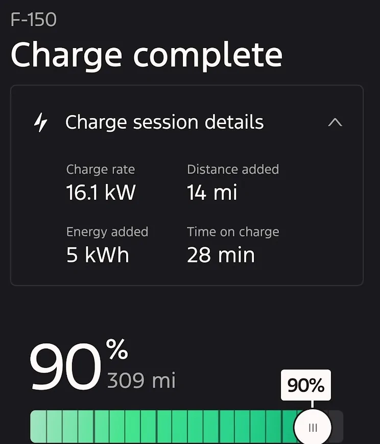

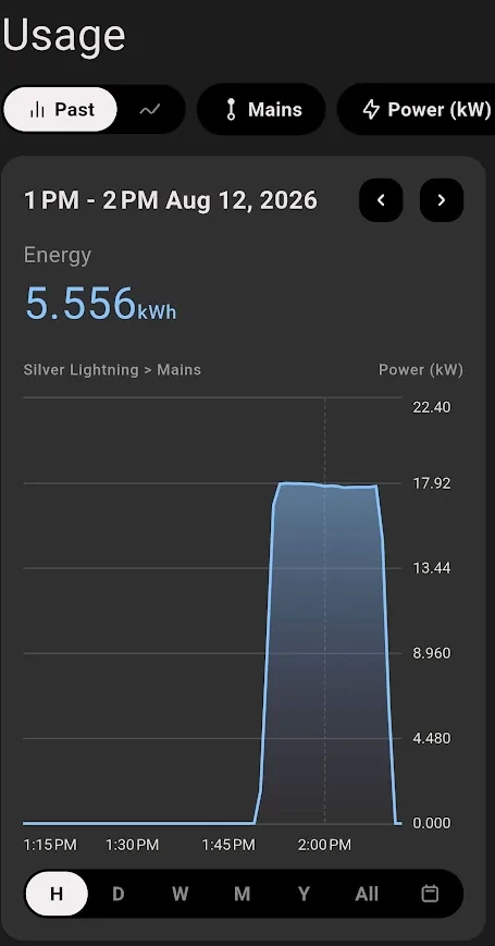

Did a 4% charge up to 90% the rate was back to the normal 80 amps, actual throughput ~76 amps
Note the setting was established prior to plugging in.
