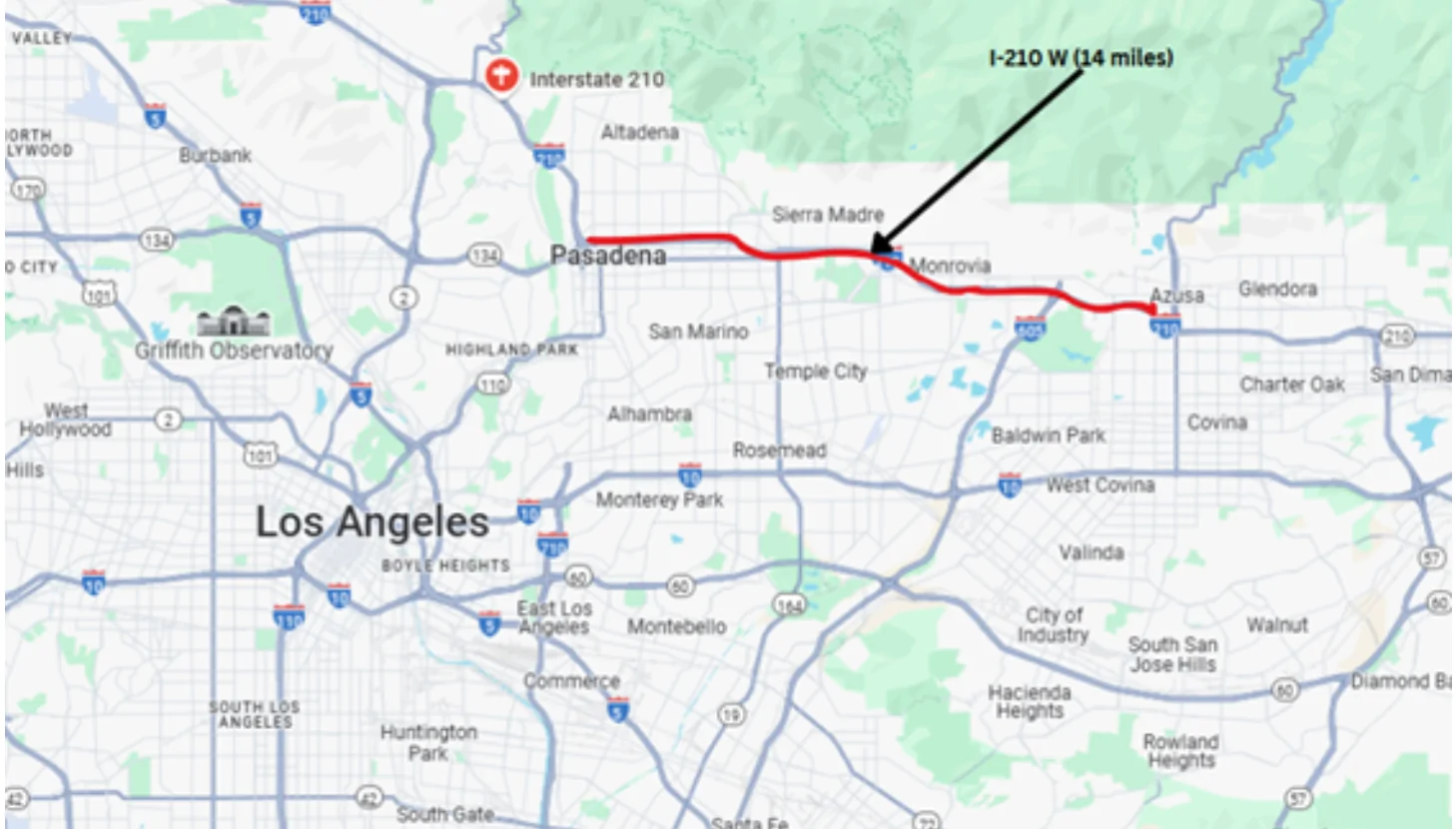

Here's a modeling paper from Purdue on the topic. The paper analyzed a 14 mile road segment near Los Angeles. Demand peaks at 28 MW during evening rush hour (Fig 8b). Figure 10a shows it needs 43 MW of solar, 114 MWh of storage, and a grid connection of 16 MW, estimated at $206M.
I wonder how much of that 28 MW makes it into the EV's batteries?
I have always thought wireless charging had to be pretty lossy. Cell phones might be around a tenth of an inch between send and receive antennas. On big trucks, the distance must be 3+ feet. I am sure the transmit beam is very narrow, but still. I assume each transmitter only turns on when it knows there is a capable receiver.

$15M/mile of energy storage!
At 60 mph, that's 1 minute of charging in that $15M mile. At 200 kW delivered, you'd get 3.33 kWh in that $15M mile. That's 7 miles of range at 2.1 miles/kWh delivered in 1 mile (1 min) of travel. Traveling the $206M 14 mile case-study corridor charges 98 miles, 84 more miles than you traveled at 60 mph while charging. Neat.
The future looks expensive.
