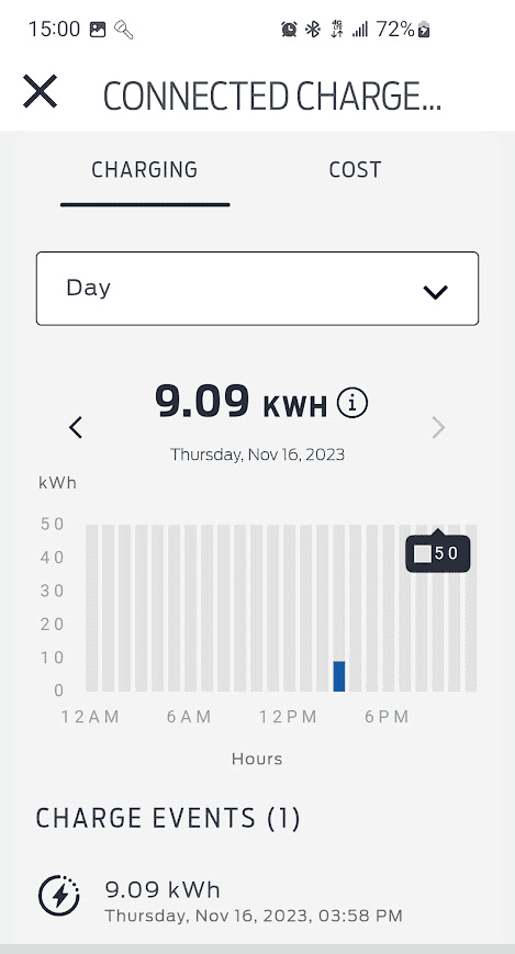

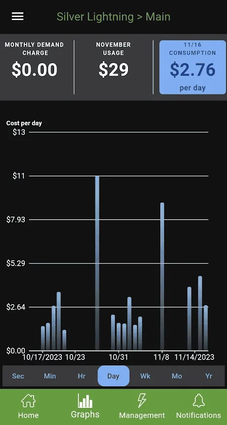

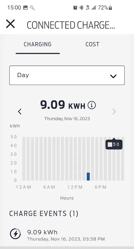

I topped off the battery, adding back the 7%, Emporia & FCSP logs show the following:
Ford F-150 Lightning Ford's Important Tip For Driving Your Lightning in the Cold: Preconditioning / Pre-Heat Your Battery 1700167232989
Ford F-150 Lightning Ford's Important Tip For Driving Your Lightning in the Cold: Preconditioning / Pre-Heat Your Battery 1700167286772
Ford F-150 Lightning Ford's Important Tip For Driving Your Lightning in the Cold: Preconditioning / Pre-Heat Your Battery 1700167251759
Total cost to operate the truck today per FCSP is $2.71 and Emporia is $2.76
17.4 cents a mile, much better than yesterday.

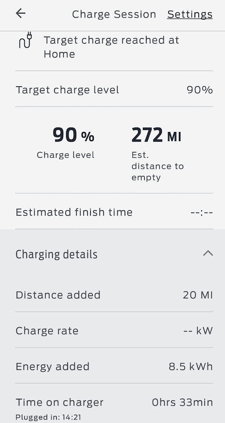

The Ford Pass charging progress record showed the following.

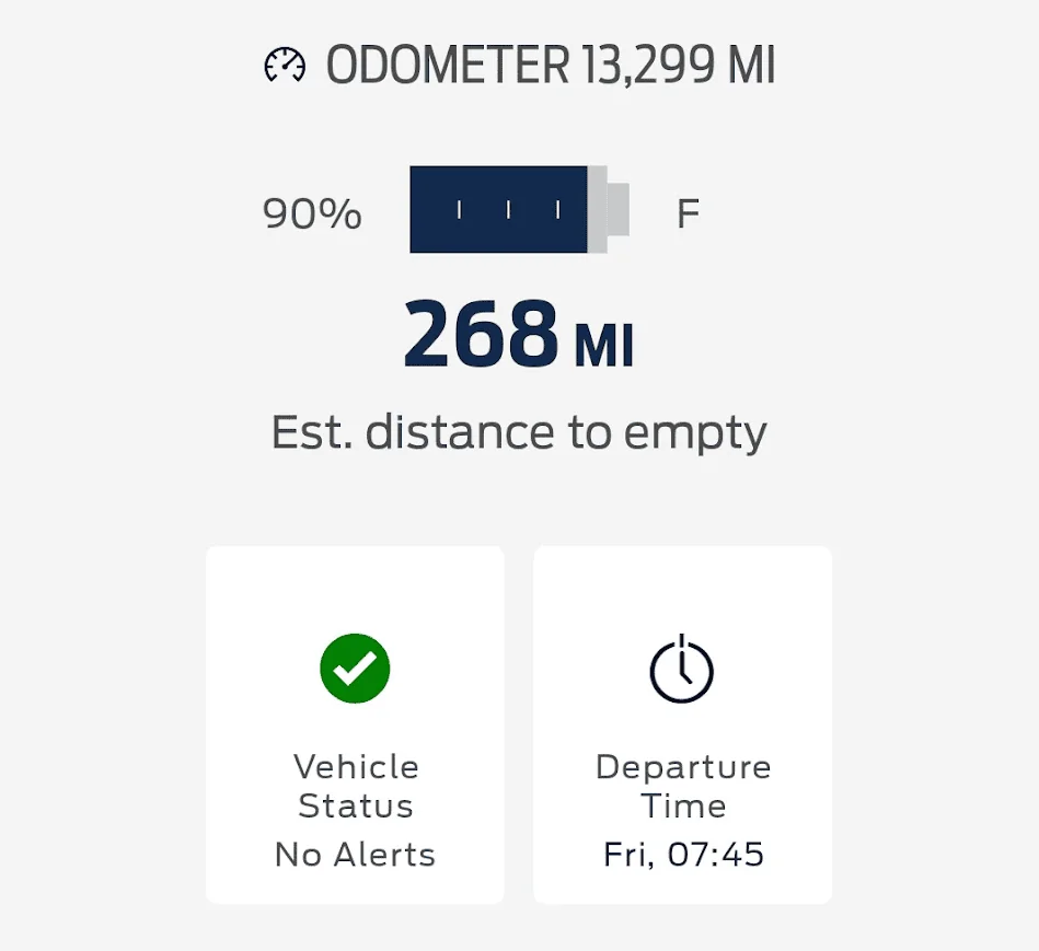

Early report about my revise testing of the Departure Timer while unplugged
This morning it was a balmy & foggy 50° so the thermal burden was the least over the past three days, set the departure time yesterday afternoon in the truck after she was fully charged to 90%
Our intended leave time is 8:00 am, but I set the departure time for 7:45 am, observed the truck parking lights come on at 7:40 am.

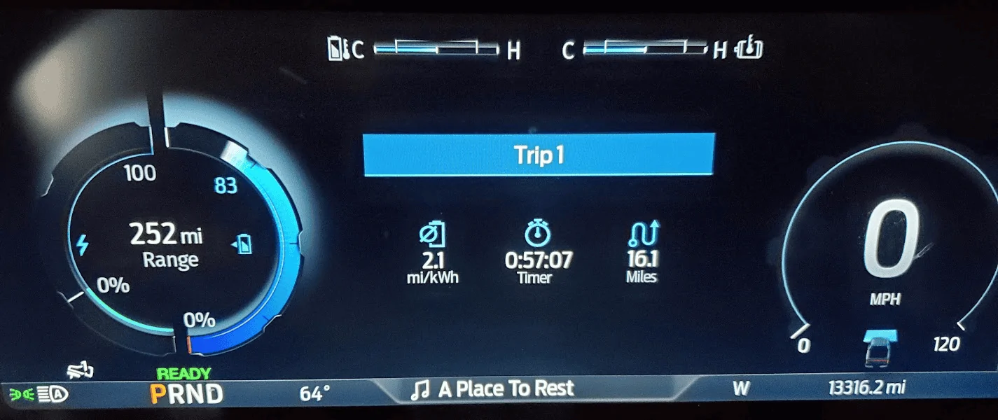

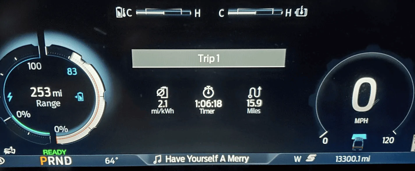

Afternoon report, after doing 16.1 miles of local around town travel, 64° at this time so much less thermal load (minimal heat / cooling). Notice the remaining range of 252 plus 16 miles traveled is close to this mornings projected range of 271 per the o'll-reliable GOM. 2.1 MPK for the day.

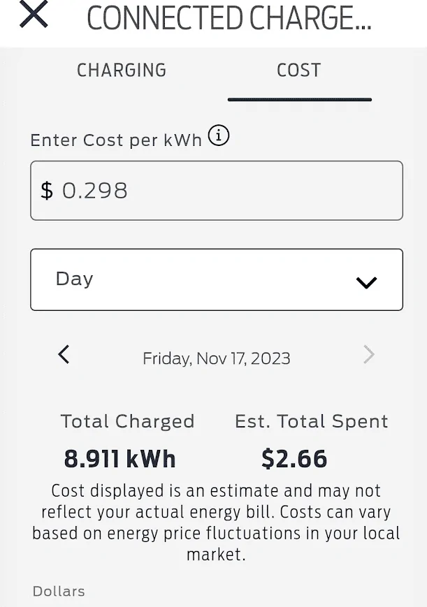

FP & FCSP Charging stat's: FP thinks I restored 19 miles worth of energy, a little optimistic, the 8.911 KWH consumed is close to the 9.01 KWH Emporia measured 98.9% accuracy.

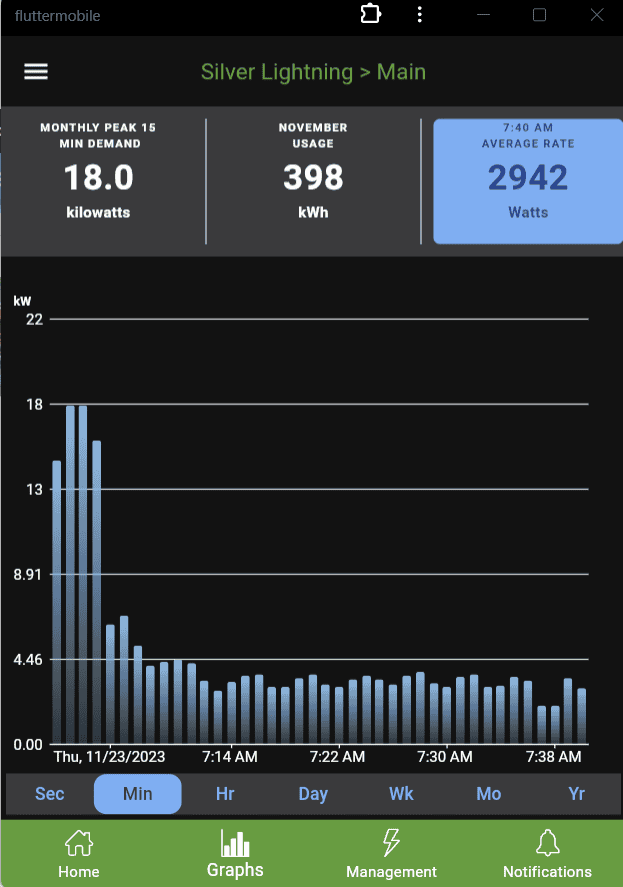

The FMC running at 120 provides about 1.4 KW of energy, so likely the battery is shouldering the heating load.
The PTC which warms the cabin can draw as much as peak rate of about 18 KW for about 3-5 minute, but it slows down quickly, this is my Sunday 11/26/23 morning {REMOTE START} of 10 minutes, resulting in 1.63 KWH passing from the FCSP at 240v @ 80a no battery warm up it was 22 degrees this morning
Ford F-150 Lightning Ford's Important Tip For Driving Your Lightning in the Cold: Preconditioning / Pre-Heat Your Battery 1701048890499
Ford F-150 Lightning Ford's Important Tip For Driving Your Lightning in the Cold: Preconditioning / Pre-Heat Your Battery 1701049004464

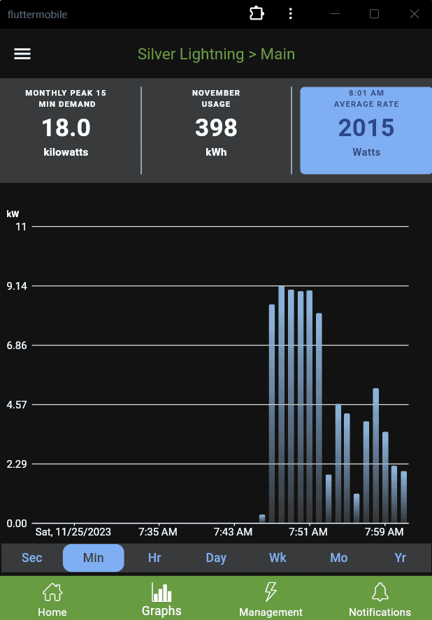

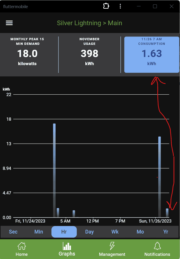

This was the Remote Start Saturday morning, power flow by the minute and hour
Consumed 1.29 KWH to get cabin, seat and wheel warmed up, no battery warm up

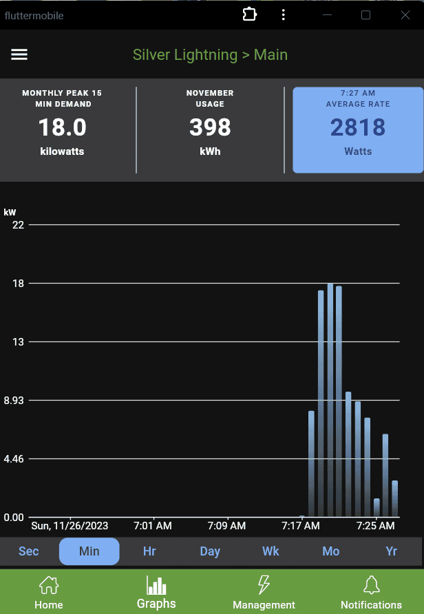

I had set a departure time for Thanksgiving morning pre-trip battery conditioning to warm battery for a long distance trip and pre-warm cabin, goal was set to 07:30 am, chart on left started at 07:00, then I let the truck rest a while, the truck consumed [3.5 KWH].
The final warm up via {Remote Start} for 15 minute, notice the peak energy draw was a modest 5 KW which tapered down quickly, less energy was needed [0.68 KWH] as the battery and cabin were previously warmed.
Ford F-150 Lightning Ford's Important Tip For Driving Your Lightning in the Cold: Preconditioning / Pre-Heat Your Battery 1701049653148
Ford F-150 Lightning Ford's Important Tip For Driving Your Lightning in the Cold: Preconditioning / Pre-Heat Your Battery 1701049603830
I'm not certain of the battery thermal management strategy would try to warm the battery when using departure timer while the truck is plugged into 120v, if it does the energy being supplied would be trivial compared to the warming efforts of around 6 KWH

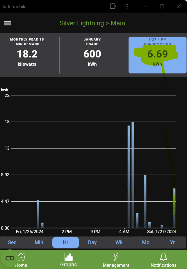

Kind of but here is what I measured today when I was prepping for a 150 mile round trip this evening, Roll out time was 5pm, I set the preconditioning schedule for 4:45 to condition battery & warm cabin.
Earlier in the day I charged the truck 66% to 95%, that probably generated some nice heat, but the truck sat for several hours before the truck decided it was time to begin "Preparing for the trip" It kicked off at 4:04 PM as noted on pink colored portion of the chart, at this point the SOC had settled to 94% so the onboard charger also called for charging energy as well as warming energy to the PTC.
During the green phase, the battery reached the goal of 95% and stopped charging, but continued with moderate energy to continue warming the battery.
During the orange phase, the cabin heating began at 4:30 and continued for 15 minutes, I then got an alert that the cabin / truck was ready at 4:45, it continued to moderate the warming phase until 4:57 when I unplugged the truck.
Ford F-150 Lightning Ford's Important Tip For Driving Your Lightning in the Cold: Preconditioning / Pre-Heat Your Battery 1706415302625
Over all this process consumed 6.69 KWH of energy, ~1.3 KWH for battery charge of 1%, 1.5 KWH for cabin warming and the balance of 3.89 KWH for battery warming, this is much less than I've spent on prior {colder} days when the battery was cold soaked and nearly fully charged. So the premise that charging induce heat is true and has been measured by a few members over the past couple of years. A last minute 15-30 charging session helps but not as much as a scheduled event, when you know far enough in advance.
Ford F-150 Lightning Ford's Important Tip For Driving Your Lightning in the Cold: Preconditioning / Pre-Heat Your Battery 1706415858790
PS: road trip the the [Nam Knights MC] fundraiser was a success, 148 miles of spirited driving, trip up was 1.8 MPK, trip home was 1.4 MPK, average was 1.6 MPK, SOC from 95% to 22%, with remaining range available of 47 miles (ER 131 KW pack)
