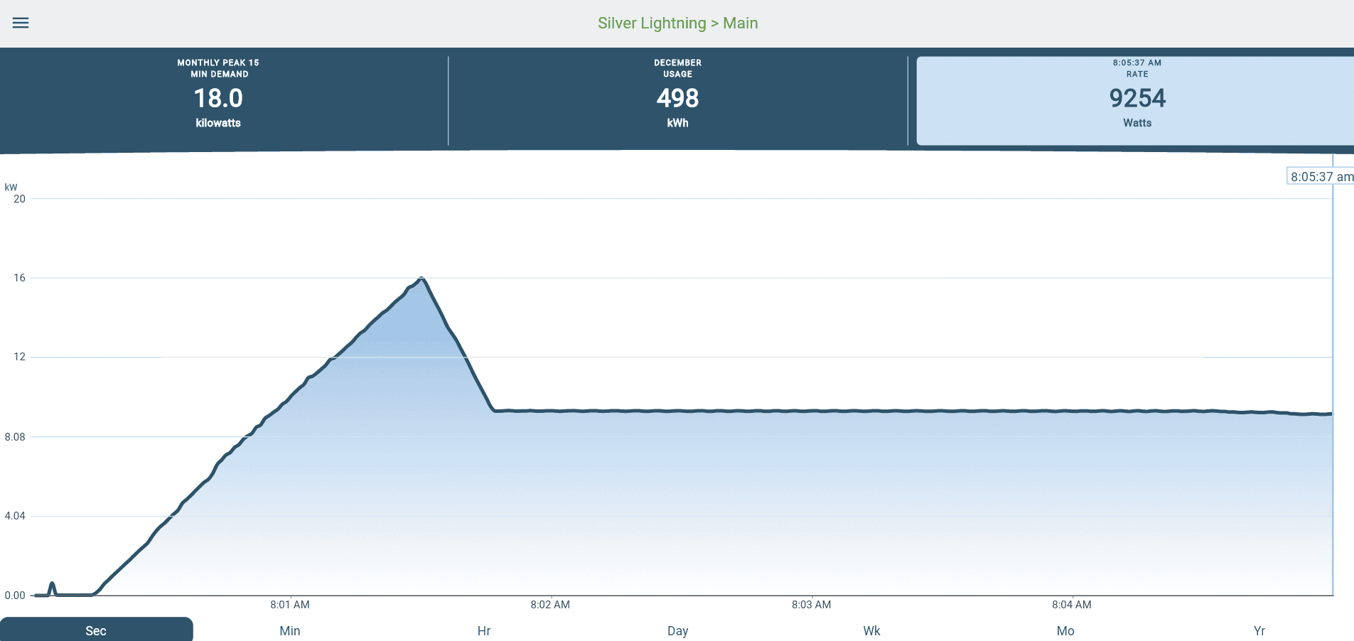

This morning temp's around 20 degrees Sunday the truck was not driven, cold soaked, with exception of 8KWH of charging Sunday morning to replenish Saturday's driving.
No indication on the Emporia power monitor of any current draw by the truck in 24 hours of cold conditions.
Manual request of remote start @ 8am, PTC ramped up slower pace to 16KW, then just short of 120 seconds later, settled to a stable 9.3KW
Ford F-150 Lightning Ford's Important Tip For Driving Your Lightning in the Cold: Preconditioning / Pre-Heat Your Battery 1672060198685

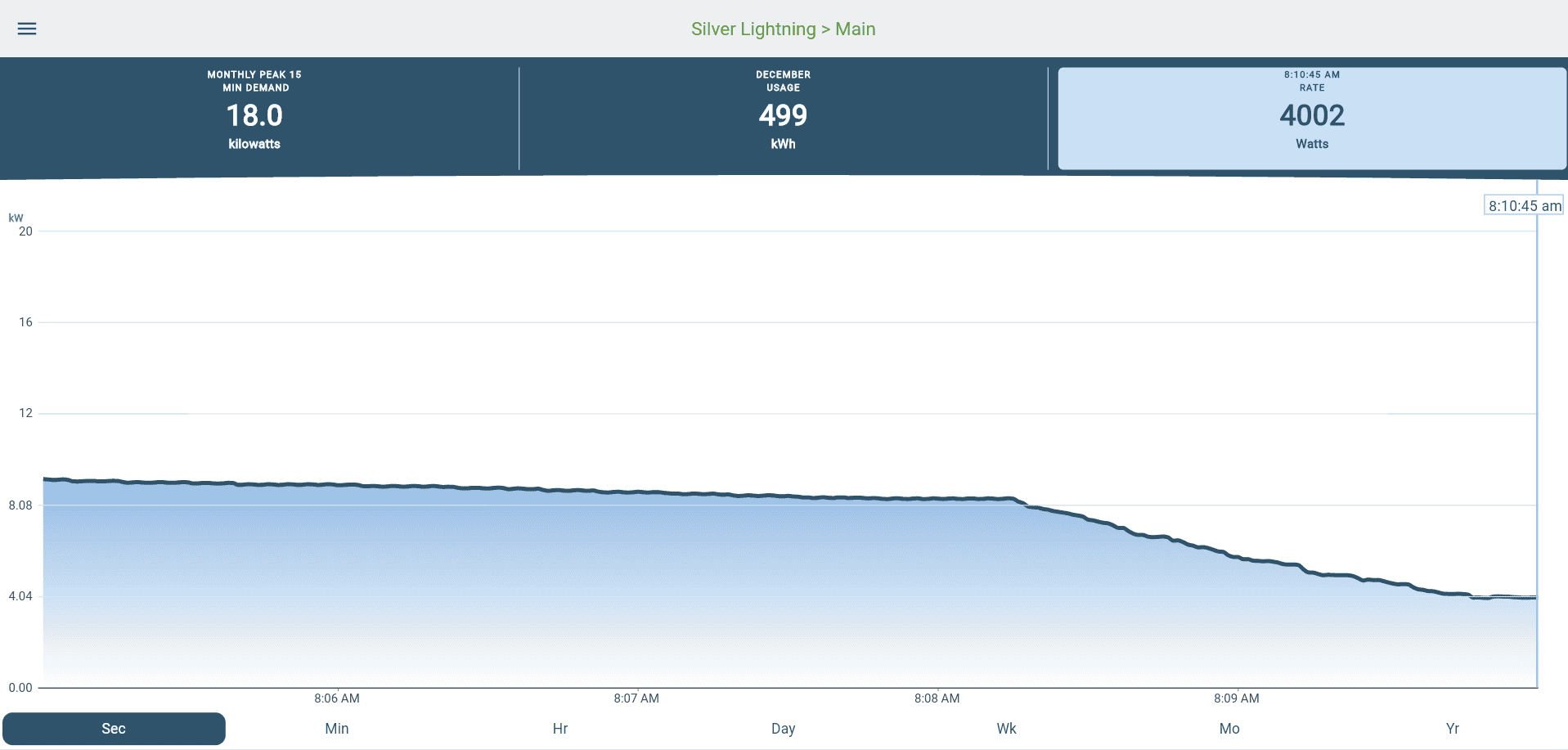

at 8:09 ramping down to 4KW
Ford F-150 Lightning Ford's Important Tip For Driving Your Lightning in the Cold: Preconditioning / Pre-Heat Your Battery 1672060336794

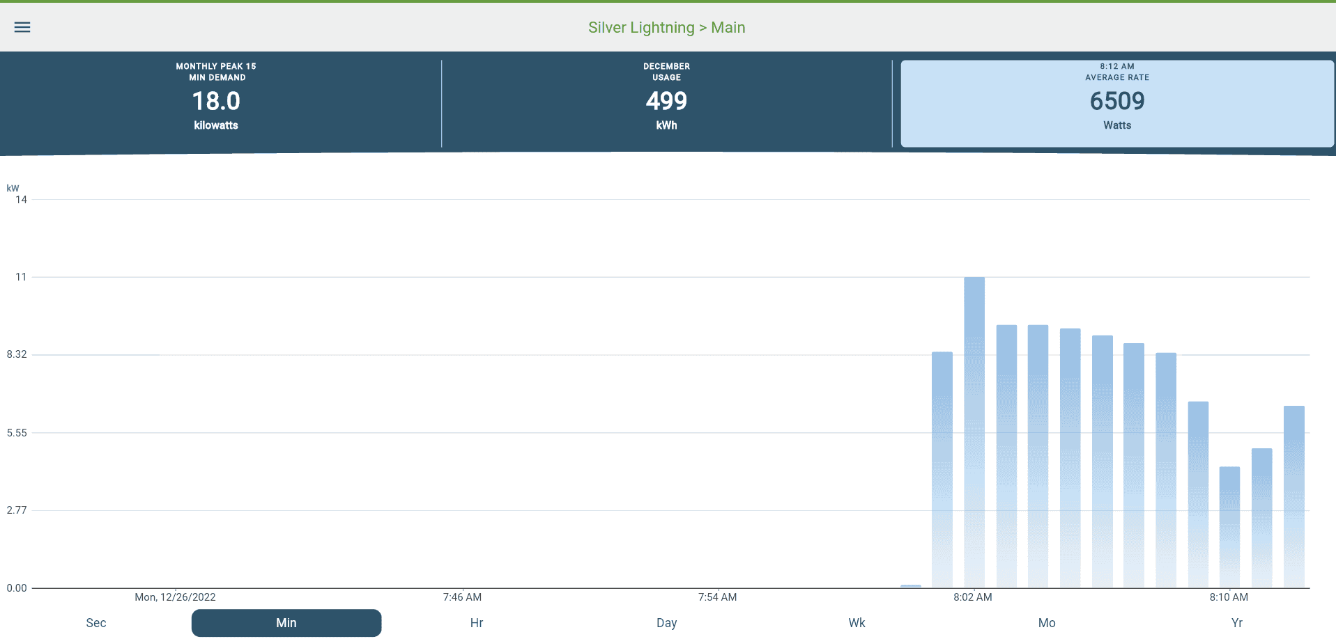

Couple minutes later and PTC is cycling to maintain output temperature to cabin.
Ford F-150 Lightning Ford's Important Tip For Driving Your Lightning in the Cold: Preconditioning / Pre-Heat Your Battery 1672060424069

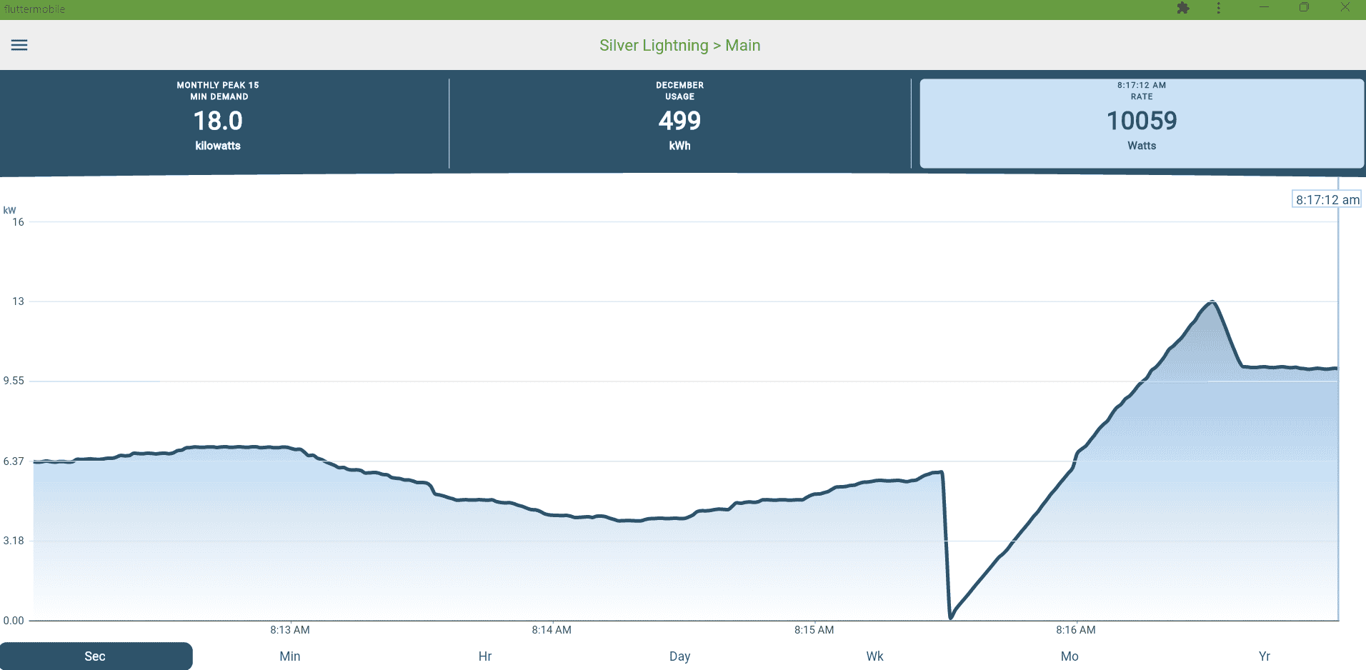

After cabin warming phase stopped, the power continues to flow, not sure if truck is charging or cabin conditioning is still going past 15 minute limiter.
Ford F-150 Lightning Ford's Important Tip For Driving Your Lightning in the Cold: Preconditioning / Pre-Heat Your Battery 1672060701495

After heading to garage, confirming cabin fans off, but the the charging converter was running full tilt though truck was near SOC set point, that stopped when I pressed the latch release on the CCS1 handle

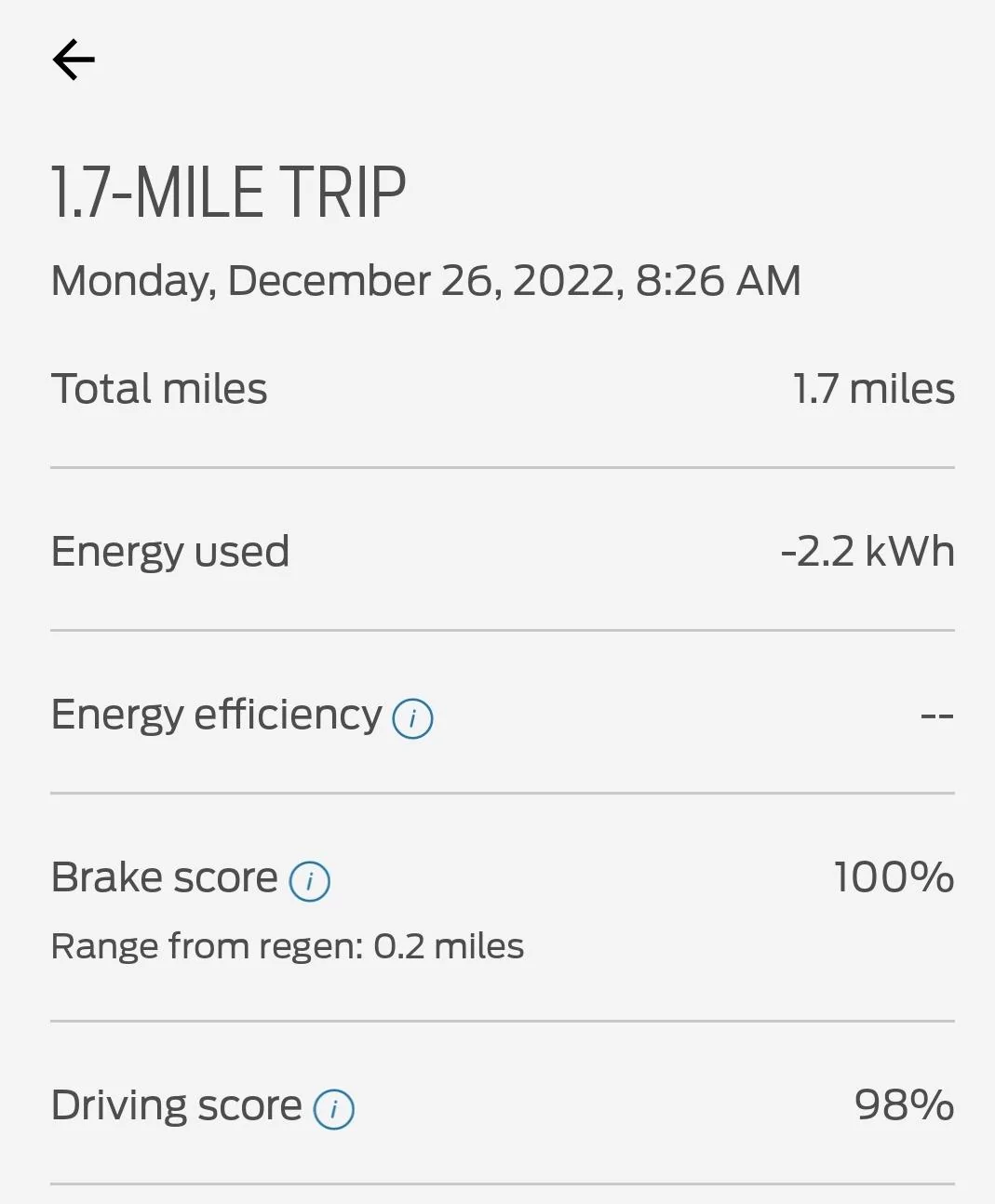

And funny business with the trip record in conjunction with the extra battery boost, negative energy consumption.
No record for the charging activity .
Ford F-150 Lightning Ford's Important Tip For Driving Your Lightning in the Cold: Preconditioning / Pre-Heat Your Battery SmartSelect_20221226_084410_FordPass

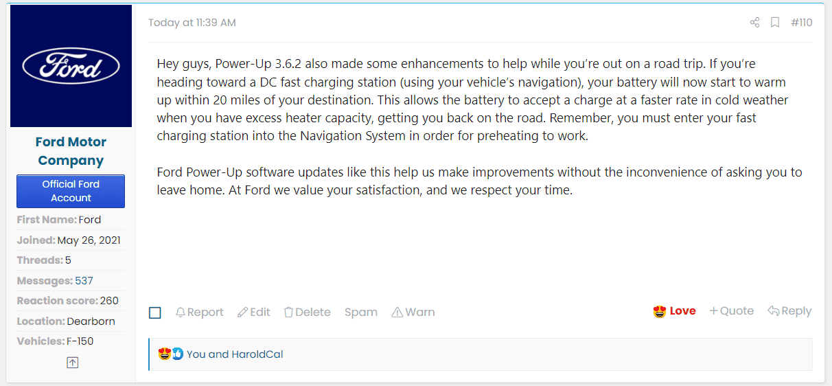

How is there an update numbered 3.6.2 while we are waiting for one numbered 4.1.2?
Apparently there was an older update last fall, the Ford Guide might be referencing 3.5.2 instead of 3.6.2
