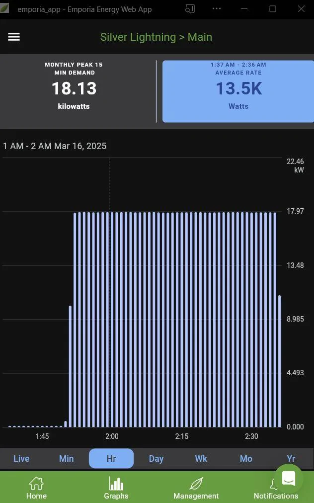

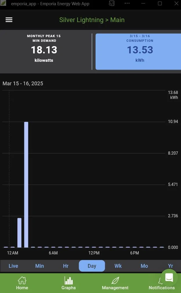

Is your FCSP derated? I thought it could supply ~19kW. How big are your inverters for the panels? I have a 27 panel system but the inverter maxes out at 5kW so there are times that I am actually producing more power than the system can send back to the panel. As previous stated check your meter at the panel and see what your current usage is then start a charge and compare the numbers.
208
15,411
17,163
Is the solar system inverter faulting or suspending power export while you are charging?
Is your FCSP set to maximum 80 amp setting? if it is, that usually results in approx 18kw real load on the system, I have never seen 19.2 KW on my setup.
