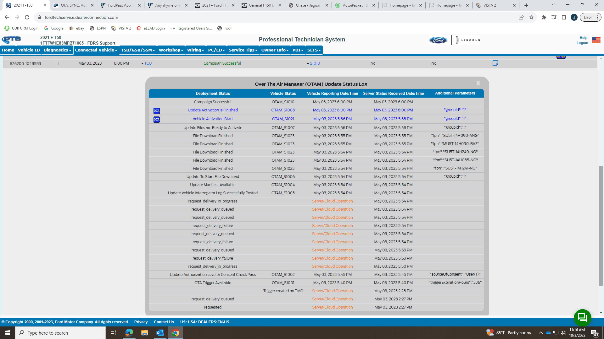

This. You have to have an update sent to you before it can fail due to low SOC. Driving the vehicle makes no difference in terms of getting an update sent to you. Auto-updates being on or off does not matter most of the time, as that only applies to updates that require the vehicle to be inhibited while they install. If you have auto-updates off and get sent an update that does not require the vehicle to be inhibited, the trigger to get it to install is to turn the truck on after the OTA trigger is created for your truck. Once that OTA trigger is created, your truck has "x" amount of time for that update to install before the OTA expires.....usually two weeks, but some triggers can last up to 4 weeks before they time out. For example, look at the screenshot of OTA 4.2.4 on my truck back in May:
Ford F-150 Lightning Any rhyme or reason on how the OTA updates are sent out? 1696346354362
OTA trigger was sent to my truck at 2:37pm on 5/3 while I was at work. I was aware the OTA was waiting for me as I check my truck on PTS a lot. I left work at 5:40pm and used Fordpass to start my truck. At that point, the OTA trigger timer starts saying 336 hours. 5 minutes later, I get to my truck and actually turn the ignition on, and that is where the "consent" is given to install. If I had auto-updates turn off, everything would have happened exactly the same way.
By this time, I am driving the truck home. Shortly after "consent" is given, my truck is trying to download the files from Ford and it fails several times due to cloud/server issues. After a few tries, it is able to grab the manifest and download the files. 15 minutes after consent (turning ignition on), the update is installed as I am driving to my house.
Had I not started my truck until the next day, the update would have installed the next day. Had I been traveling and not started my truck for two weeks, the update would have timed out and I would have had to wait for it to be resent.
Just because your SOC is low does not mean you will not get sent an update; it just means if you do, it is more likely to fail. Just because your SOC is 100% does not mean you will get sent it update; it just means if you do, you have a better chance of it not failing to install.
Edit: Calling Ford does nothing. The people that answer the phones on their so-called "OTA hotline" are fluffers who don't know anything. They have access to PTS like me, but have no idea what they are looking at or how to interpret it.
Data center engineering needs triple redundancy if they aren't doing so!!
This is how the IRS works, three centers watching each others back at all times.
