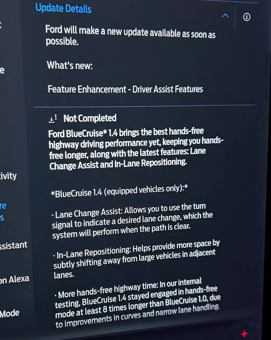

I have a 23. Got excited when I saw a bunch of text on the screen after tapping on the Updates screen until I noticed this. Am I just stuck until they push again? Any way to tell what went wrong?

If you haven't seen or executed a INSTALL NOW button, then it's still loading, once done it should install if you have the automatic update switched on for a specific time, ie. 0100 hrs 7 days/week
Still has the same message after letting it bake overnight. Strong wifi signal where it is parked and plugged in to the charger all night. Anything I can do to kick it or if it’s just another waiting game at this point?
3121
Apr 17, 2023
155
141
2022 F150 Lightning Lariat SR Mannequin
Not Completed does not mean it’s still downloading. If it were still downloading it would show the status of Downloading with a progress bar.
Not completed means either the downloaded file was corrupted or the ford system cancelled the update for your vehicle for some reason.
There is no way to force another go after Not Completed status. You just have to wait until Ford pushes the update again to your specific truck.
sorry.

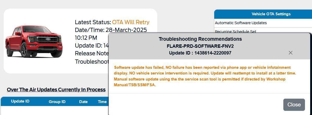

PJnc284
Sep 30, 2024
1,198
1,364
Garner, NC
PM me your vin and I can check if any error is showing in PTC.
edit: for anyone curious, below is what's showing for his vin.
Ford F-150 Lightning New BlueCruise Version 1.4 - Rollout  IPMA-24.204.10.9 1743261715070-5u
Ford F-150 Lightning New BlueCruise Version 1.4 - Rollout  IPMA-24.204.10.9 1743261734614-bh

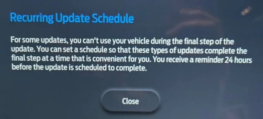

Yes, still waiting....
My last update was Feb 28 Gateway Module ECG-24.2.5.7
Same for me so far no love. I've even adjusted the download time in the truck.to try and force it.
3,133
4,497
The setting you refer to is not a download time or "check for updates" time. This is a common misconception due to the wording of the setting.
It is the time that it will install inhibit updates like BC once it has downloaded. It will only download when the truck is on. That setting has nothing to do with getting the software initially.
Ford F-150 Lightning New BlueCruise Version 1.4 - Rollout  IPMA-24.204.10.9 1743282666082-67
Thanks for helping & looking at the background data, looks like file download corruption, only solution is wait for reissuance.
