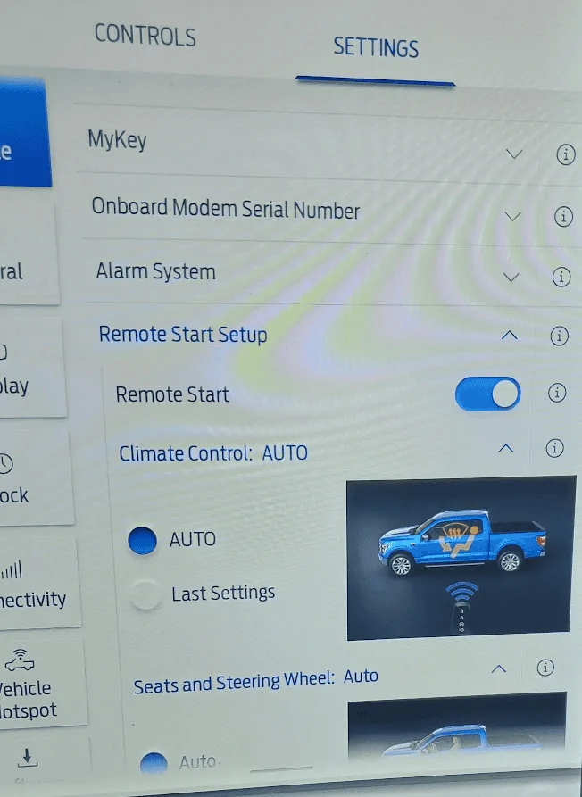

I believe you can go into setting and change the remote start behavior, but the default is "last settings" which will mess you up if you turned it off.
234
16,552
18,683
That is how I have it set, lesson learned.

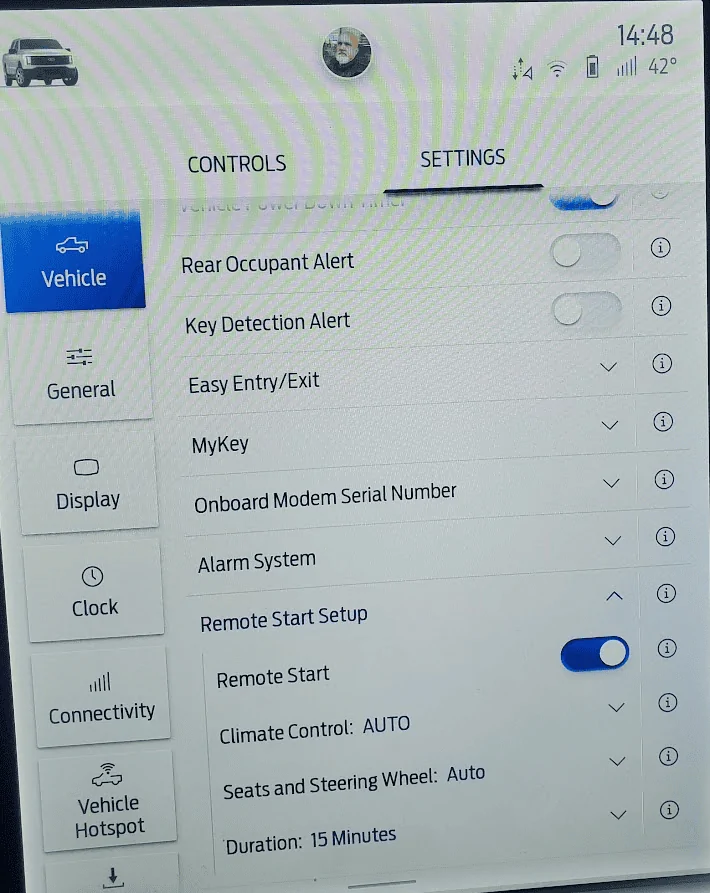

Well I guess I was mistaken, I had it on Auto/Auto so that it would condition based on the seasonal changes, fall/winter: warm cabin, seats and wheel vs. cool cabin & seats for summer.
I'm repeating the test this evening, though I'll be undocked, but I turned off the HVAC and will do a remote start to see if it turns the HVAC on and warms seat/wheel.

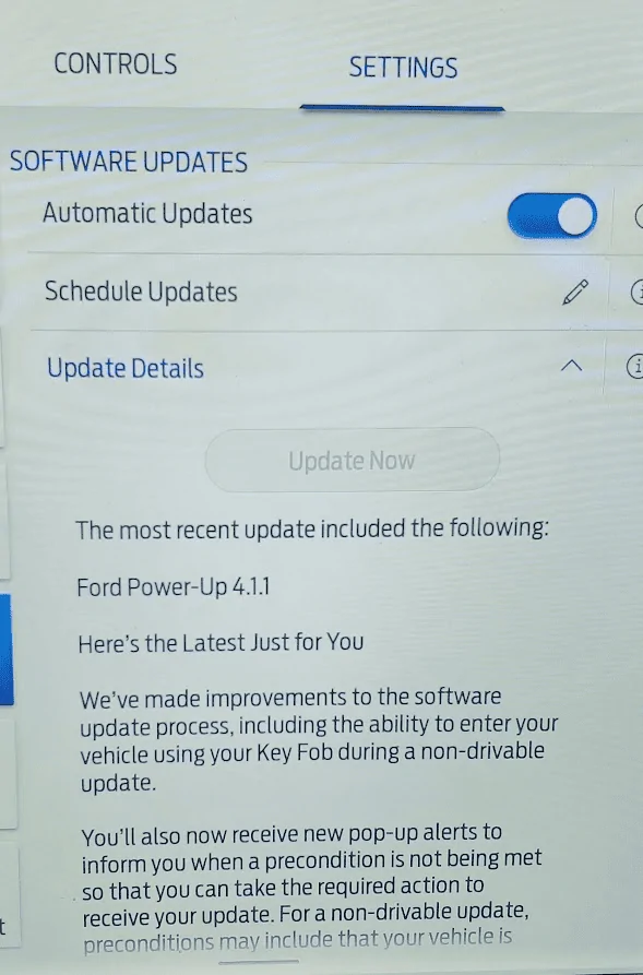

Having just gotten 4.1.1 I'm not sure if it will have an impact.

BTW, Friday morning I want to retest Departure Time, for impact of the steering wheel warming, hopefully the prior and most recent updates will have fixed that issue, it's been a while since I used that mode.
I am on 4.1.1 and still have the steering wheel issue, so don't expect much.
This sub test was successful, in that, the remote start, fired up the cabin heater, seats and steering wheel, I let it auto shutdown after 15 minutes, jumped in the truck started the truck, seats and wheel remained in heater on status, but when I checked the HVAC control, the master switch was still off, I manually turned it on and left it that way for Friday morning, but as many of you already stated, that's likely to result in a cold steering wheel.
