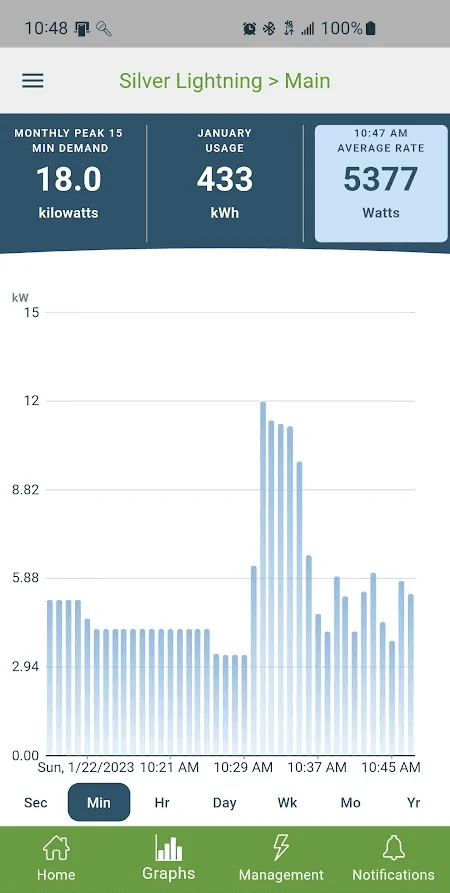

Today's episode of perfectly timed 80 to 100% charging bumping right into my pre-conditioning window, the battery is at 99% now, but the EVSE is sending more current to allow the PTC to warm up the cabin now, of course the heated steering won't work, but the remote start will fix that now

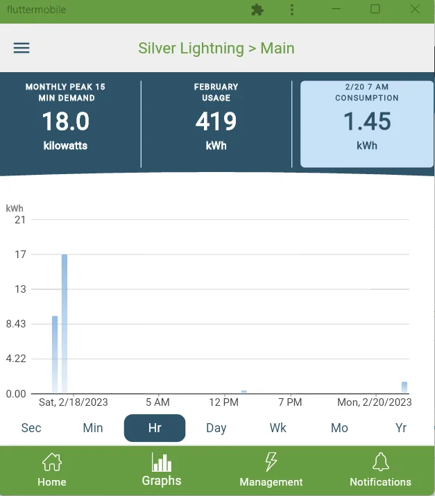

Sunday evening, I set a departure schedule for Mon-Fri, to be ready 7:45a which is 20 minutes prior to actual leave time at 8:05a
This morning the temps was a mild 51° for late February in Southern New England.
No battery warming occurred early this morning, might be because the temps were already in the 'comfortable' zone.

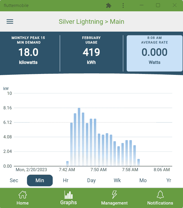

The cabin warming cycle did not start until I triggered the door unlock command at 7:42, ran for 18 minutes and shut down promptly at 8:00a using about 1.5 kWh of shore power.
Ford F-150 Lightning No Preconditioning for over a week 1676905100030
We left the around 8:08, cabin was comfortable and the steering wheel was at ambient temp on entry but as soon as I started the truck and turned it on it warmed up in a couple of minutes.
