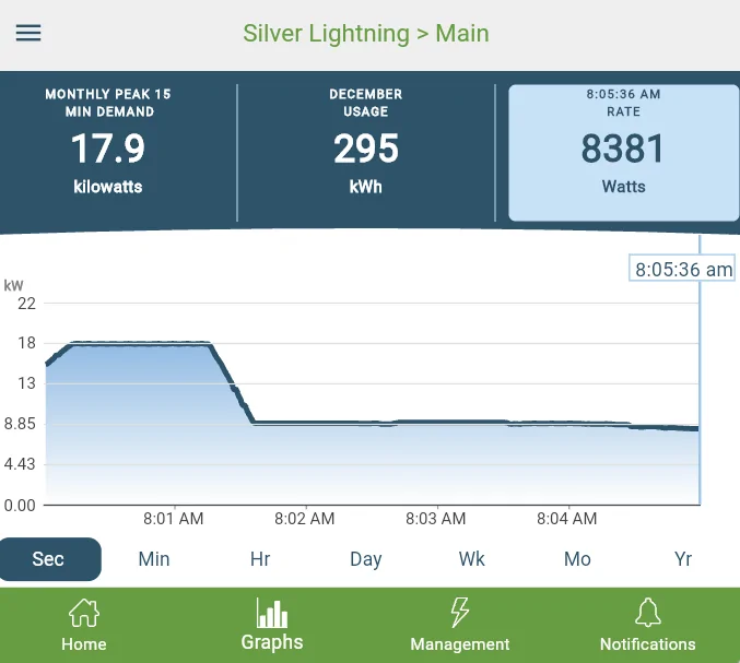

Yesterday afternoon I was stuck in a meeting so I couldn't see what the truck did (Fordpass doesn't tell me anything anymore).
This morning it was ....weird.
6:05am - scheduled departure time
6:07am - observed no lights on (they normally come on when it hits the departure time if it works) so I did a remote start. It started instantly.
6:13am - left for work. Trucks seemed warmer than a ~6 minute remote start session, but I can't be sure. Climate was not set to Auto (weird) and the heated steering wheel wasn't working at all (typical preconditioning bug).
So did it pre-condition? I have no idea. Seemed to be some weird in between state.
221
16,234
18,275
Remote start is my plan for short local drives here onward, only preconditioning for long trips
Energy used during first few minutes peaks at 17.9 kw, then slows to 8.4 kw
