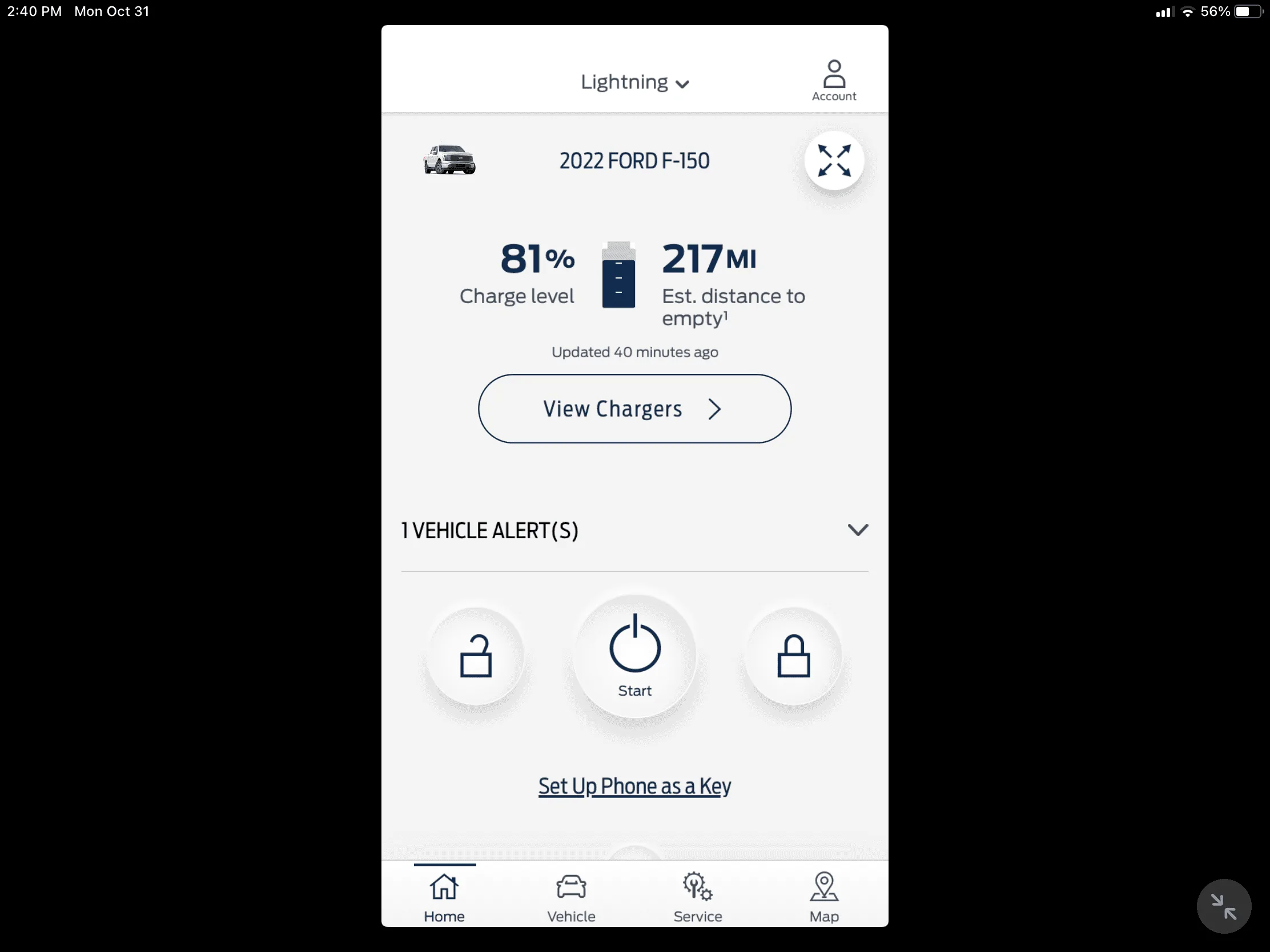

For people that it "just worked" after the update did something show up on the fordpass app or was it in the truck?
Firestop
Firestop
May 6, 2022
1,033
1,003
Oregon
My notification (greyed out when driving) was the little bell and download symbol at the upper left (top) of/on my 4a screen. I waited until I got home, tapped it, and completed the install/setup…….

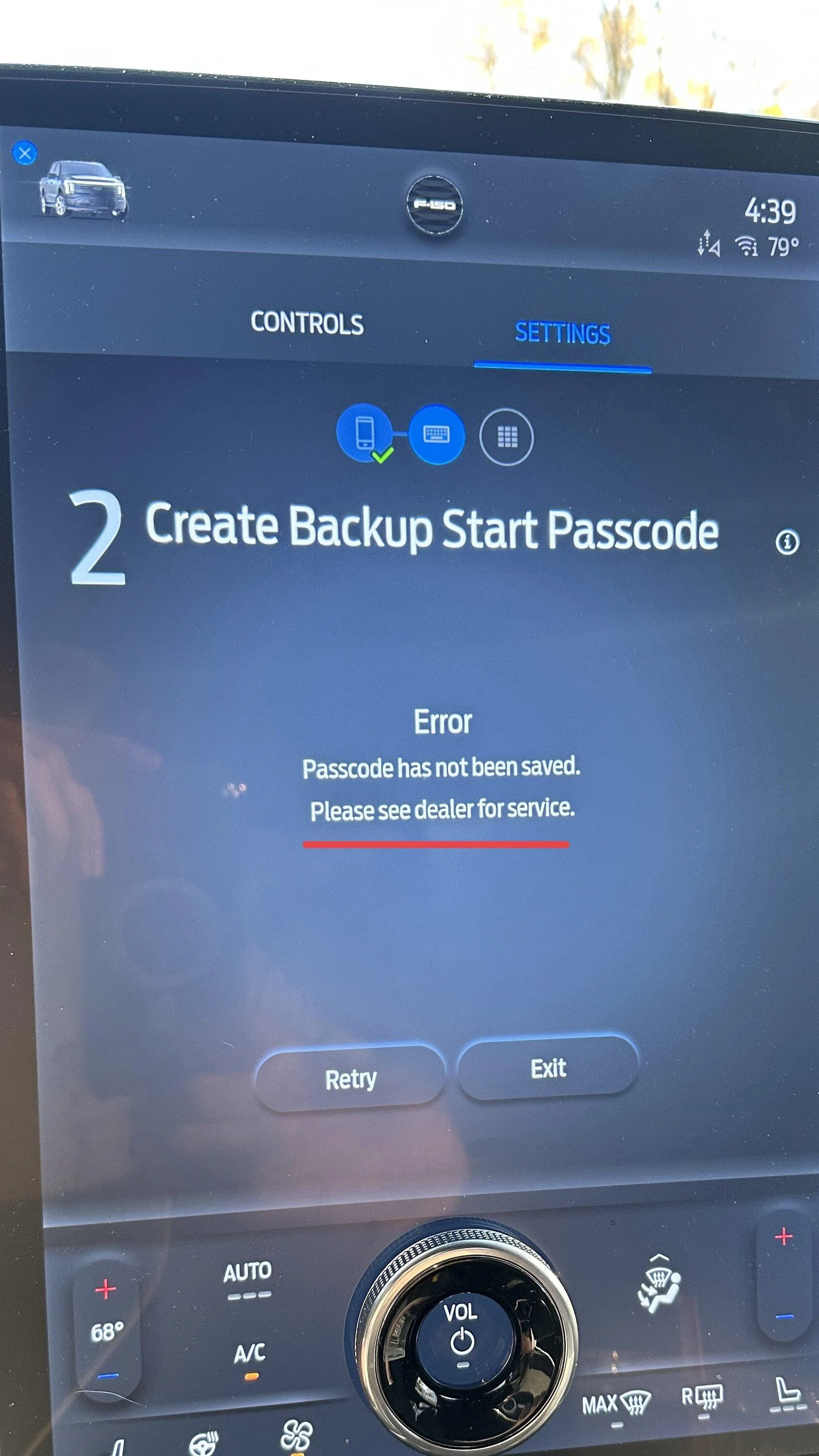

I love the solution the programmers suggest
This is where I seem to be stuck. The solution is BS, any better suggestions? Anyone know what the minimum pwd requirement is?

I also did not have PAAK after the update.
I logged out of the app and then back in ….. it’s there now.
