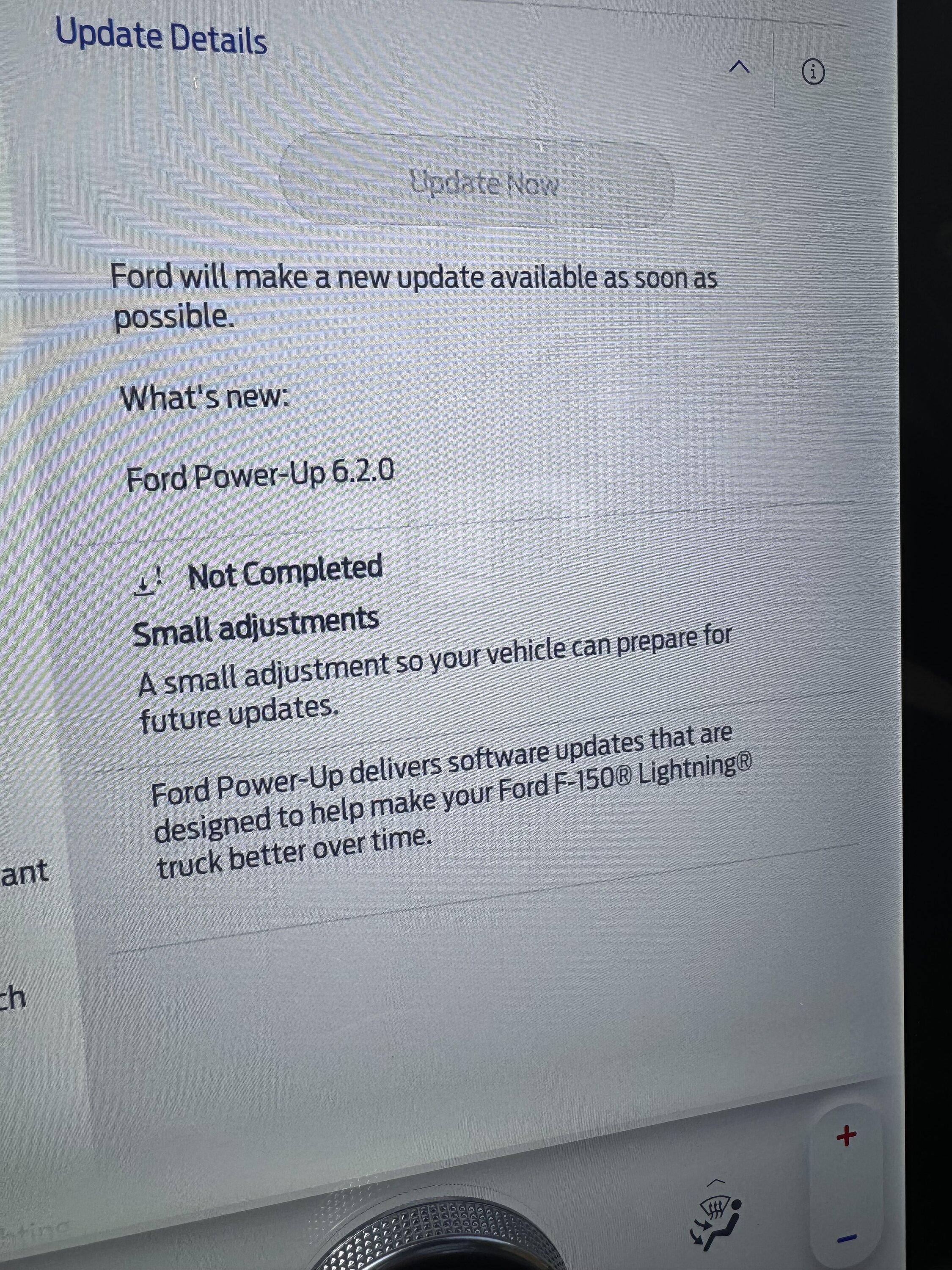

I'm in the camp of no OTA updates since July. Last month my dealer checked the OTA dashboard and there were no pending or failed OTA updates, although at the same time FDRS showed about a dozen modules with updates available.
It seems like those of us with the no updates since summer have mostly (all?) MY23 trucks, although most if not all of the OTA updates since summer seem to be something all trucks should get.
Is my unscientific observation correct? Are we all MY23? Mine is a 23 Lariat ER.

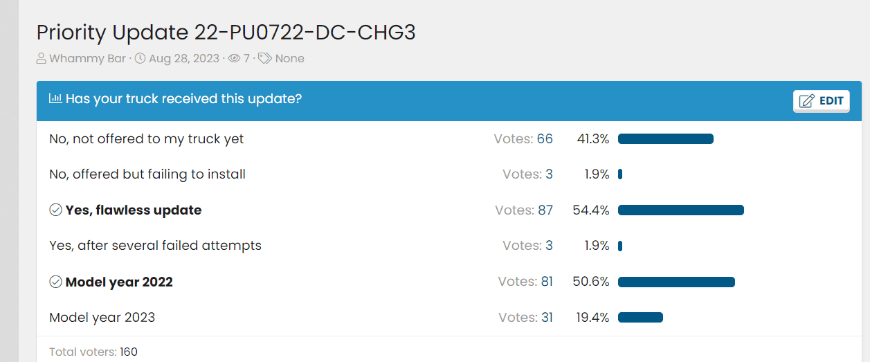

The last time we included a poll, there were MY23 owners participating, not sure what the spread was though.

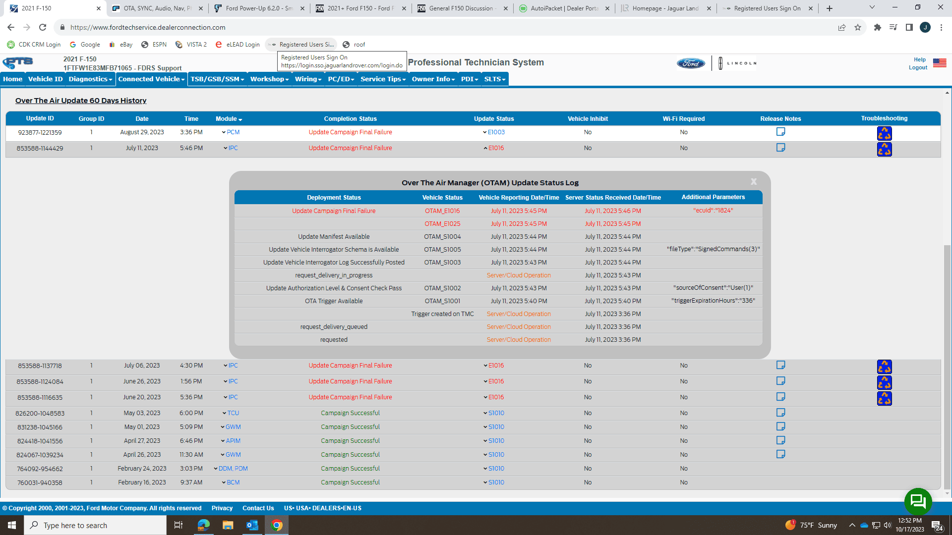

Vehicle health reports is a basic checklist to determine if your vehicle is in good operating condition. That and your truck's ability to properly be able to install an OTA is not the same thing. From the hundreds of vehicles I've looked at, 95%+ of OTA's that fail due to SOC conditions are updates that require the vehicle to be inhibited while they install. Most updates do NOT require the vehicle to be inhibited, and these updates tend to have a much higher success rate to install when they are sent out. Of the updates that do NOT require the vehicle to be inhibited, 5% or less of them fail due to low SOC. When non-inhibit updates fail, they fail due to software mismatches, checksum errors, partial downloads, server/cloud errors an my personal favorite, the "eculd" errors that give you zero insight as to the reason why the update failed. Example below is from my own truck:
Ford F-150 Lightning Power-Up OTA 6.2.0 -  Small Adjustments 1697561613832
Updates that do not require the vehicle to be inhibited can install while the vehicle is being driven, and the trigger to get them to install once they are sent to you, is to turn on the vehicle. Because the updates are installing while the vehicle is driving and the 12V battery is charging, it is very rare for them to fail. The focus on vehicle owners having a high SOC all the time to get updates is nothing but a placebo. I could have had a brand new battery with 100% SOC and 100% capacity and my truck could have been on a 40amp charger while that IPC update was trying to install and it would have failed over and over again, because the reason it was failing to install has nothing to do with SOC.
