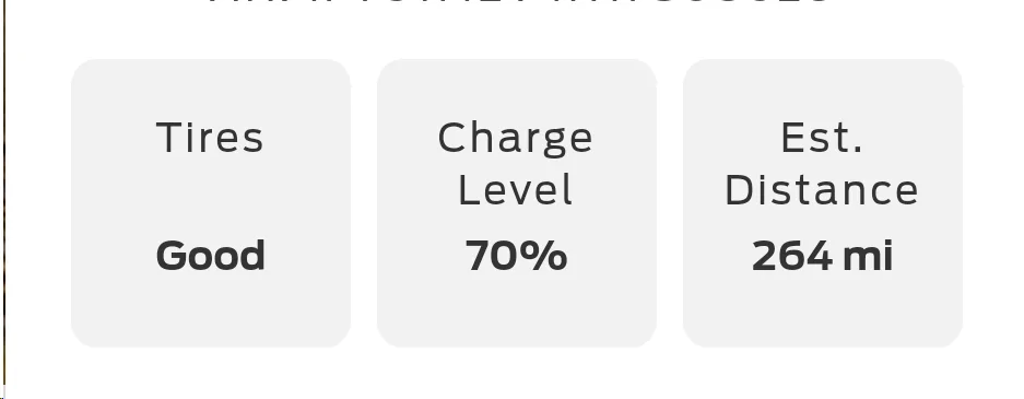

Your 70% shows higher than my 80%. (y)
Do not correlate the 70% LVB SOC to the projected Range of 264, BTW my HVB SOC was 89% in that shot.

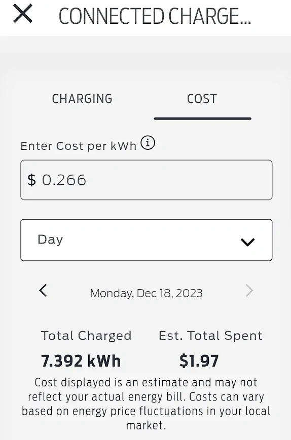

Additional testing of plugged in departure timer this morning, conditions, balmy (WINDY) morning at 60°, figuring the battery and cabin won't need much energy this morning, surprised to see the following.
The process started at 7:25 am, for a just in time departure of 8:00am, no padding or extra delays, I unplugged the truck at 8:03 am. Entering the truck, seats warm, cabin warm, but wheel was luke warm, note the process of cabin conditioning only ran 5-8 minutes (7:55 to 8:03). I started the truck and the blower had warm air ready to use, the seats resumed their level 3 warming and the steering wheel started warming up quickly (this is the important part) previous to update 6.5.0 it would have remained cold for the entire drive cycle plus 20+ minutes of rest.
I didn't expect the large amount of high energy would be needed today with mild conditions outside, it started at about 9KW then jumped up to 18KW for 15+ minutes of the process, then tapered down during the last 5 minutes of cabin prep.
Ford F-150 Lightning Power-Up OTA 6.5.0 - Minor Adj {Heated wheel & Dep Times} 1702911639106
Total energy consumed as measured by the FCSP 7.392 KWH for a cost of $1.97 to get the truck ready to go.

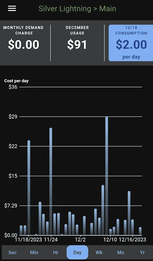

Emporia Vue2 shows 7.5 KWH for a cost of $2.00
