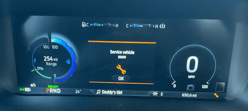

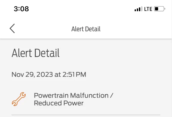

Had my truck for one week and got the powertrain malfunction/ reduced power message.
Now it won’t charge and my dealership only has one licensed tech and is three weeks out.
I Checked my 12v terminals, any other ideas?
Wait a day and see if the condition resolves, have you had any alerts of updates attempting or recently posted? BTW, what is your current SOC, looks to be very close to 100% and power available to motors is not restricted.
