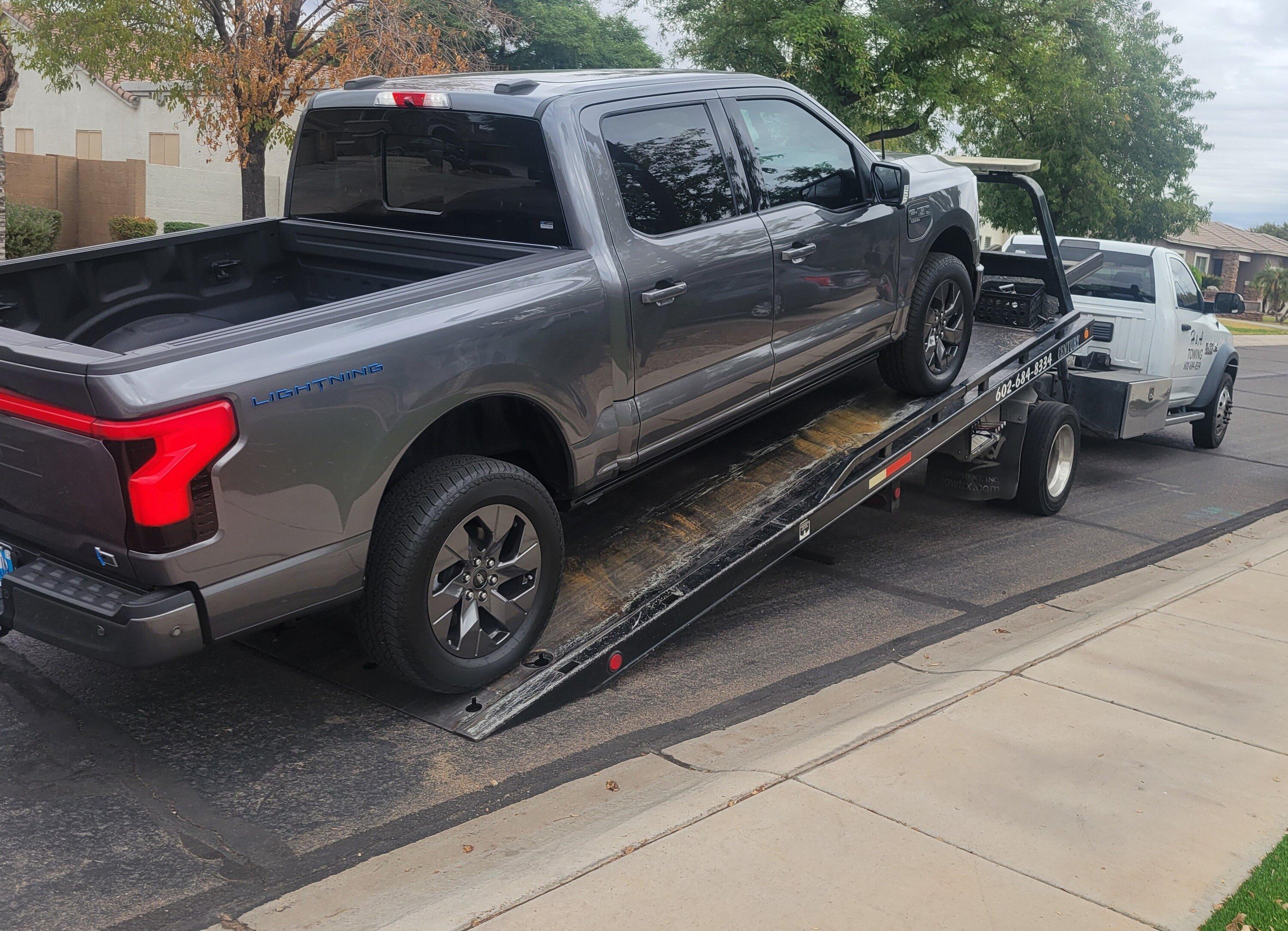

Hi folks, thought I would give you an update. I lucked out for two months without any more warning lights. However ten days ago I saw a High Voltage Battery Warning (Electrical Fault) and Powertrain Malfunction lights and the truck lost 90% of its power. I was just coming off the highway and was able to limp home doing about 20mph. When I called Ford dealer this time they were very accommodating. They towed my Lightning to dealer and also dropped off loaner Mach e GT. Service tech said that battery module #9 needs replacing and Ford was sending one out to dealer. But it's gonna be a few week turnaround to get this fixed.
Definitely frustrating but at least I have a rental this time (I just don't think I'd purchase a Mach e, lol). I have mixed feelings about this whole ordeal. I get it, Ford over promised here, ran into supply chain, resourcing, and service station issues, and possibly released to market too soon, but seems like that's what automakers do right. I do feel like many BEV makers (besides Tesla) will be in the same learning curve boat as Ford. I really won't defend Ford here, there's lots of room for improvement. But I'm confident Lightnings will get better, and their batteries and software will get better. Its the new world we live in, and as an early adopter I'm patient and manage my own expectations daily. I continue to love my Lighting, best truck and vehicle I've owned. Thanks for listening folks. Keep you posted.
My final update for this issue folks. So Ford had my truck in shop for 19 days. They replaced the bad battery module and also completed 4 other safety recalls from letters I received in mail (rear light bar wiring, steering wheel wiring and heated grip, and a few others software updates). I read somewhere that it can take days (thought I read up to 22 days) for new battery module to sync with rest of modules and gain its efficiency back to 100% charge/max mileage. I haven't charged my truck yet since back from dealer but if I have any issues will keep you all updated. This ordeal has been frustrating for sure but I'm glad to have my truck back. As I've said before I don't mind being an early adopter and don't mind some inconveniences but I just don't want this to become a regular occurrence either. I'm curious as to percentage of Lighting owners that are experiencing similar issues but Ford probably doesn't have data on that yet. I'm still bullish on Lightning, this truck is really bad a$$. I expect Ford will work out its bugs and do right by all Lighting owners. Happy holidays everyone.
