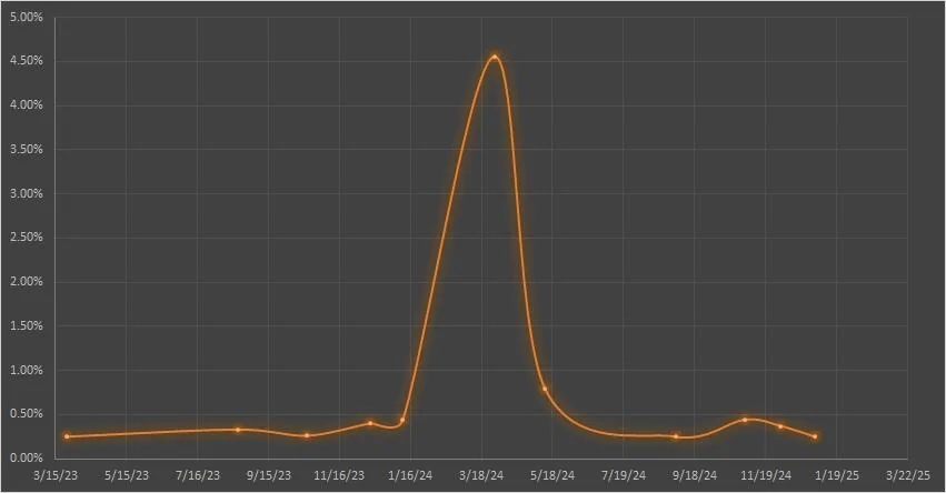

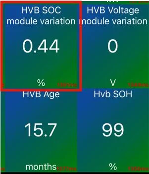

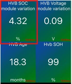

If you have an OBD dongle and the free CarScanner app, you can quickly determine if it is the battery module (to keep dealer honest).
Here are my readings before I experienced the failure and after:

Note there are values for Voltage variation and Percent variation. I don't know what the cutoff is but if the variation is over 1-2% (mine was 4.32%), I would be concerned.
My % variation was always below 1% until that fateful day last March.

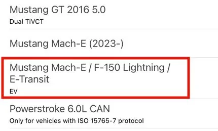

I'm unable to find those values when I scan what's available. Does one need to load a custom file to find that?

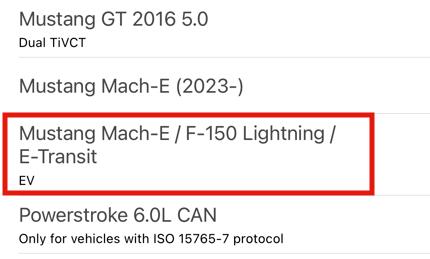

On the main page go to Settings, then Connection Profile. Choose Ford then Mustang Mach-E / F-150 Lightning/ E-Transit EV:

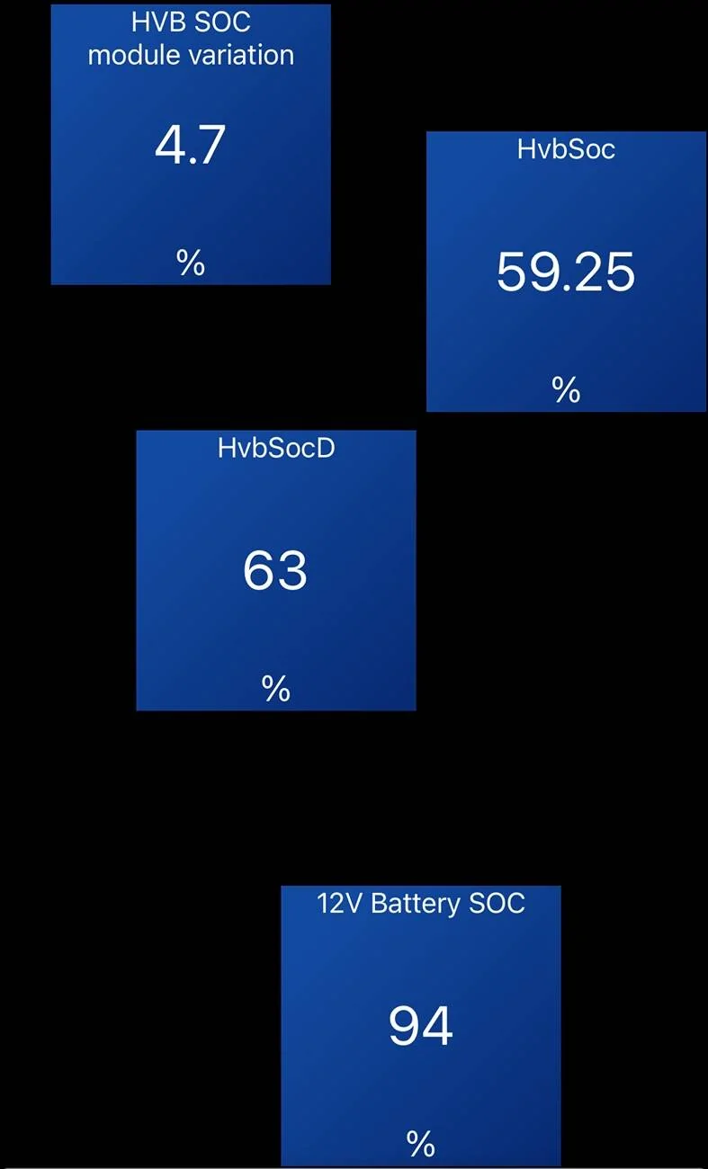

Well it seems that I have a pack or module failure like you said. I have a 4.7% variation. Thanks again for the advice, I guess I will need a new battery.
