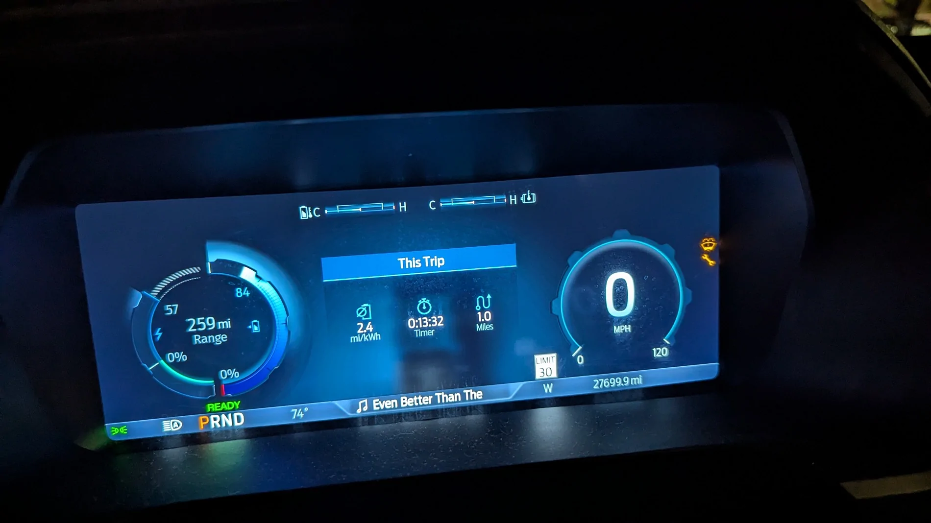

Just got hit with this today, just in time for Christmas.

What year is your truck? Still charging OK? More details if you expect much help here, Could be other issues ....

Thank you. I bought this vehicle less than 3 months ago as Ford Certified EV with 24k miles. It is a 2024 Lariat ER built 5/24. Anything else you need?

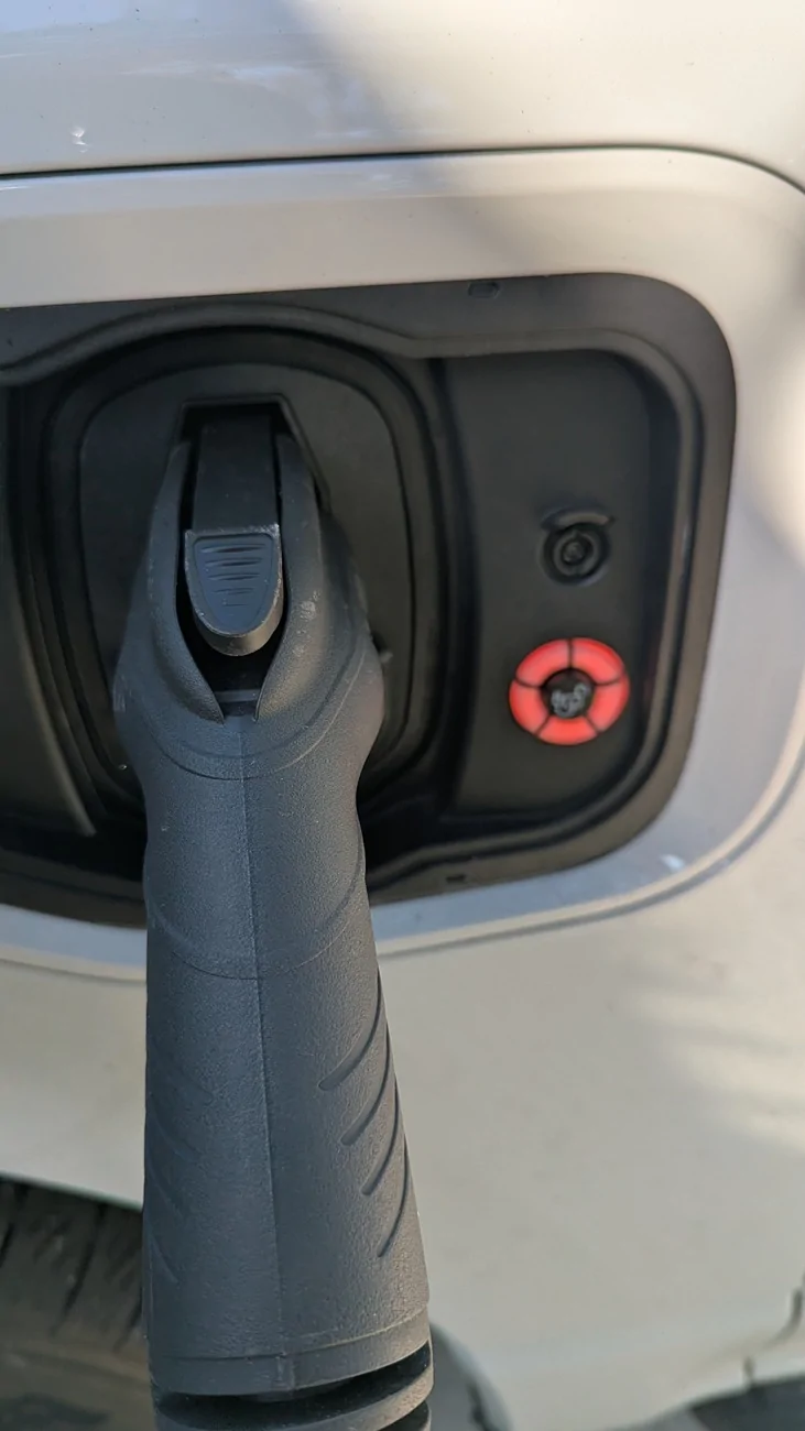

I hadn't thought to try and charge but I just tried it now and got a red circle.

Looks bad for a failed battery module with the charge level stopping at 57% and not going higher. If the dealer determines it is a battery module other folks have been able to drive while waiting for parts to arrive. Sorry, perhaps someone else has better idea???

Taking it in on Tuesday. It's not charging so I won't be able to drive it while waiting for parts. I am surprised at how boring it is to drive it at 57%.
