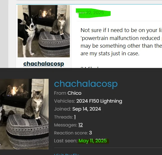

Not sure if I need to be on your list or not since my truck hasn't been properly diagnosed or fixed yet. I got 'powertrain malfunction reduced power' message when trying to DC fast charge and I still can't charge. My issue may be something other than the battery pack but who knows, they have mis diagnosed it 2 times already.
What was the outcome?
