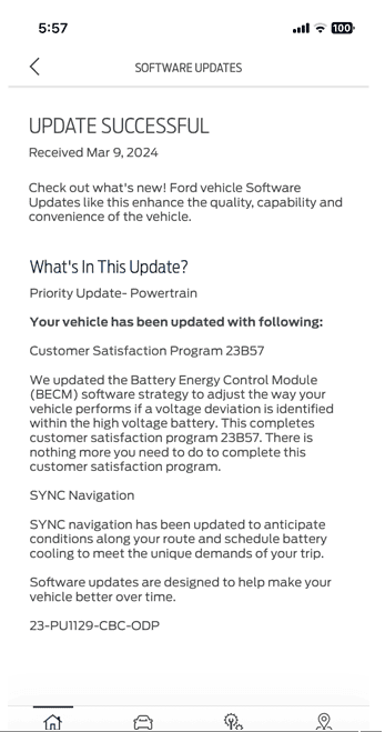

I got this update the end of last week. Took a few days of 12v charging and BMS resets...finally went through this morning.
After a lot of messing around I think I have found a consistent process to get difficult updates to complete
1) Charge the Low Voltage Battery for 6-8hrs, until it's well charged, even after the tender says charged, leave it in maintenance for 6-8hrs. When charged remove 12v battery charger
2) Reset the BMS Sensor - (Turn on accessories mode - foot OFF brake, - press start button - flash high beams 5 times - press brake pedal 3 times - Look for red 12v battery icon to flash in the dash - Done).
3) shut off truck -plug in to charge HV battery on your usual overnight schedule, leave it until morning.
4) Try update first thing in the morning - Or schedule the update to install at 5-6AM
This process works for my truck

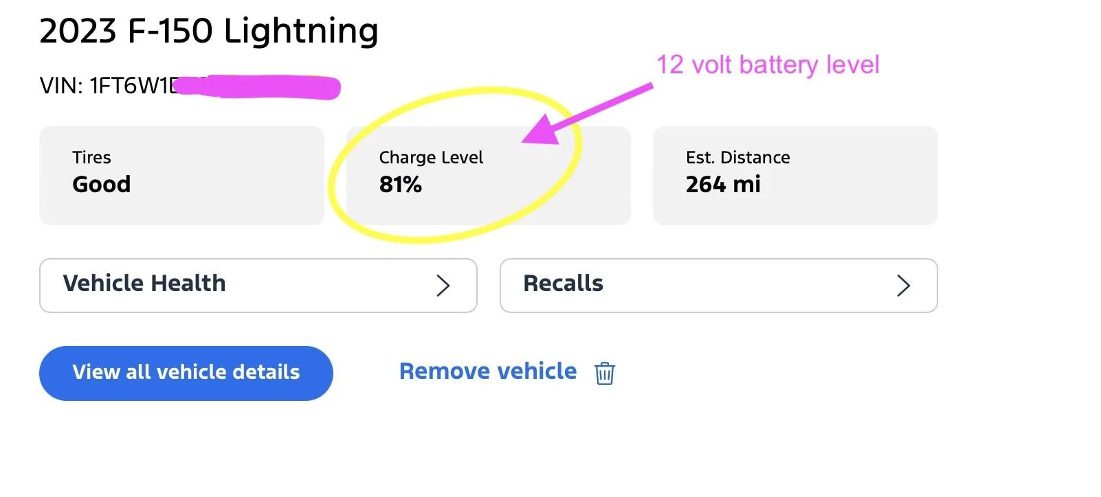

Just updated on my Lightning, took about a week to go through. Wondering if my 12V is getting low.
You can login into your Ford account through a web browser and you can see your 12 volt battery level.
Ford F-150 Lightning Priority Update-23-PU1129-CBC-ODP - Powertrain Screenshot 2024-03-18 at 12.34.23 PM
92
3,687
4,649
That is your high voltage charge level not your 12V level.
Sorry, incorrect. That is indeed the 12v - LVB SOC. It is not the HVB.
