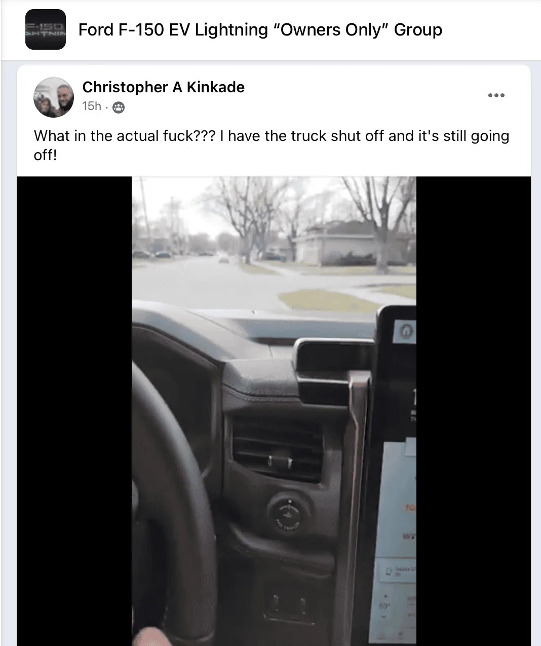

There is a video on Facebook confirming this exact issue occurring in a Lariat ER, which certainly raises the stakes. Not that it wasn't a serious issue already but there are many, many more Lariats on the road compared to Platinums with the B&O Unleashed.

Video link won't post due to it being in a private group but here's what the post looks like if you want to find it.
Apologies for the language - I'm not the OP.
OP confirms 2022 Lariat in comments.

Thanks, i joined that group and listened to his video, hopefully he follows-up with his dealer to get the speakers and amp checked out.

Did he describe it as the same dangerously loud volume, and same circumstances? I wonder if there is a way to download the video for reposting here. Hopefully he files an NHTSA report.
He mentions that a loud POP preceded a persistent noise captured in his video.
I listened to the various examples on the sister forum, none of those samples were exactly the same as his but still a nasty irritation.
