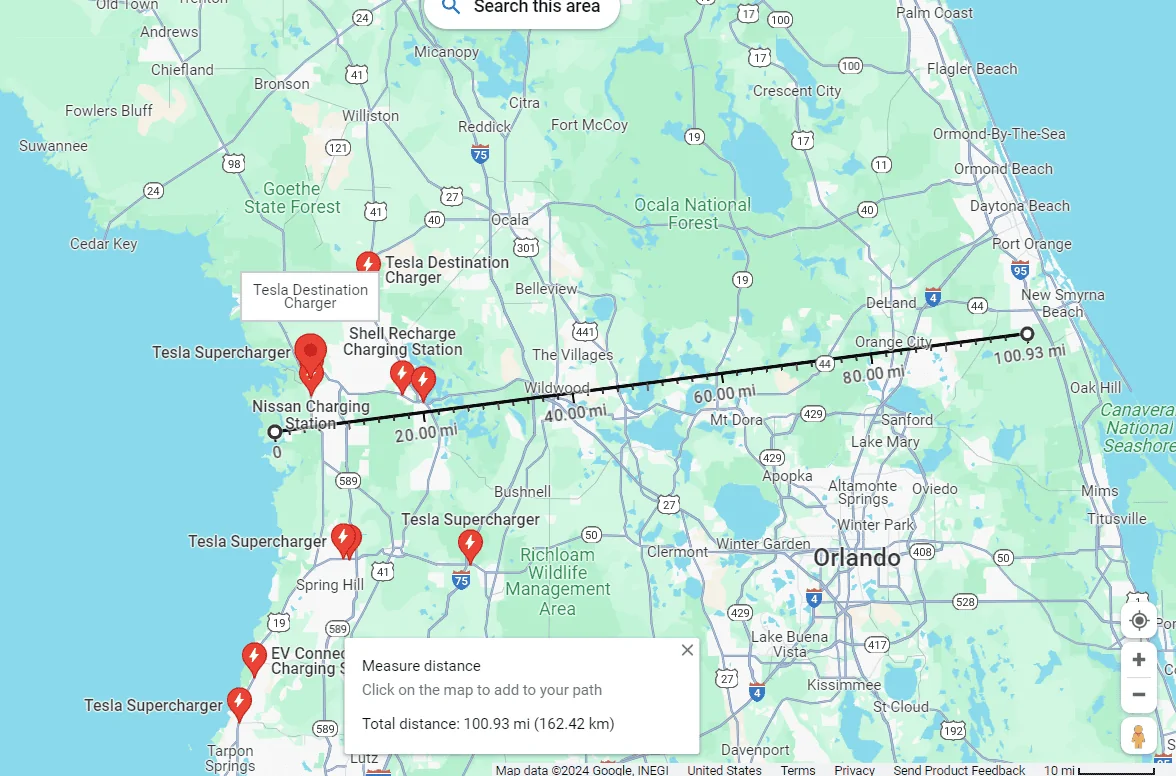

My longest tow is up to the Homosassa river at just about 100miles. And I’m sure the extended range would make it round trip without issue. Trying to see if the standard gets it done with maybe a stage 1 plug in while I’m fishing. I’m still researching and learning about EVs in general; so excuse the newb level.
All the posts above have pretty well analyzed the potential of an SR 200 mile round trip.
A word of advice, research the charging options for a mid-trip boost, there are many stations in the vicinity of the Gulf side of the Homosassa river, if your rig won't make the round trip, stop and pick up enough of a boost to facilitate the trip, any level-1 charging you can get at the destination is gravy.

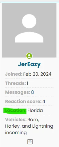

Remember to expand a user's profile to see the details they might provide, helps minimize the assumptions folks add to a post that aren't relevant.
