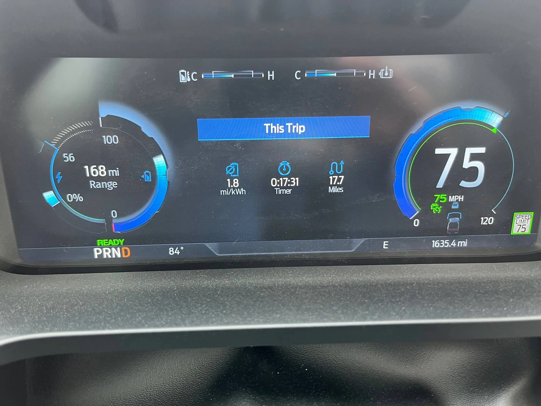

As I put truck in drive I noticed power output limited to 56%!?
I shut her down, opened the door to clear the accessory mode, waited 30 seconds, then fingers crossed ..... I restarted the Lightning, she is now showing 100% available power at 96% SOC.

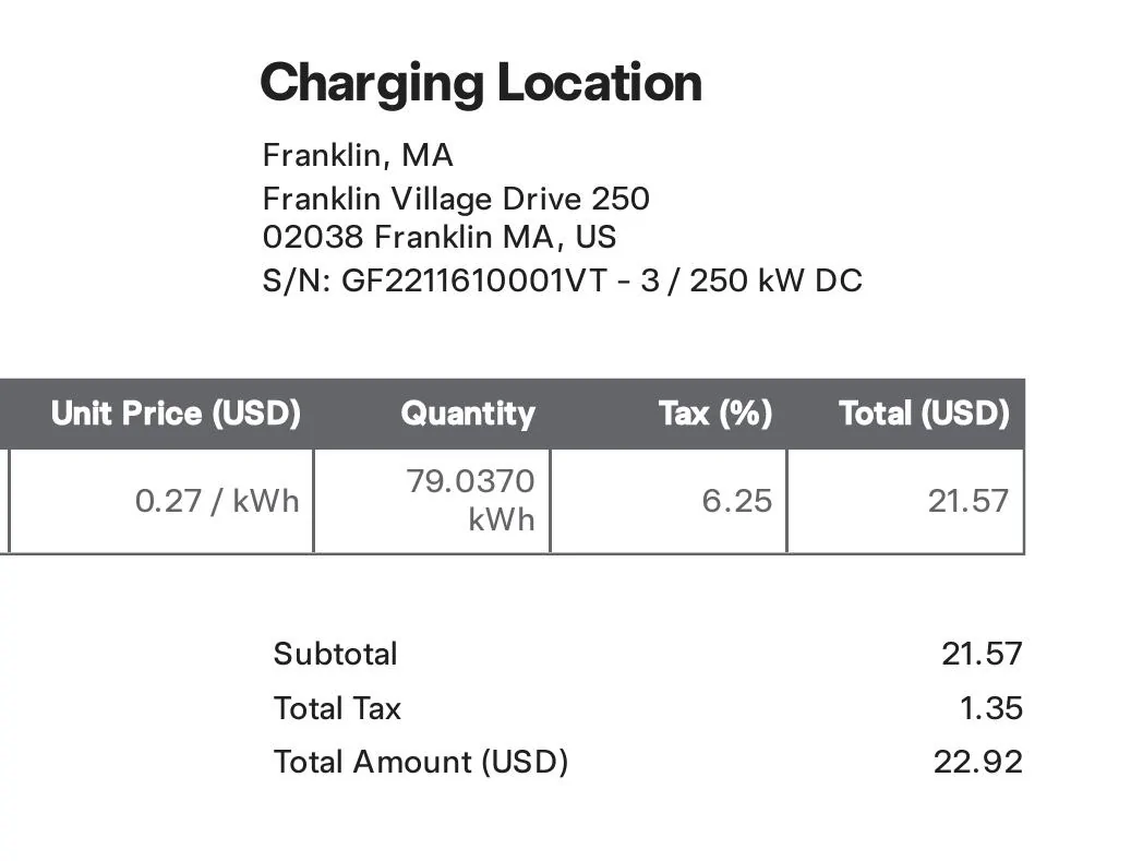

The rest of the evening went perfectly, no additional power reductions, truck performed well the entire night over 185 miles, topped up the truck at Tesla Franklin MA, desolate at 0037 in the morning, completed a 31% to 90% charge I stayed longer because it was cheap rate of 29c/kWh compared to home charging, no one was waiting and I had plenty of time to catch up on emails and text messages from club members.
So, this has happened twice that I recall after doing departure conditioning, I wonder what the cause is?
BTW, I hit a peak rate of ~168 KW about 1 minute from charge startup, used the new adapter that I received last week, worked perfectly, smooth fit, locking mechanism was secure while engaged with the CC1 port on the truck. Rate was 27c (before sales tax) after sales tax 29c, which matched the published rate on the Tesla app which I used to activate the session.
This may be related to the front contactor. You can confirm that when you have that reduced power again, view the power distribution and it will show no power to the front wheels while driving. It may be software related, I don't think there's been any definitive answers, it usually fixes itself.
