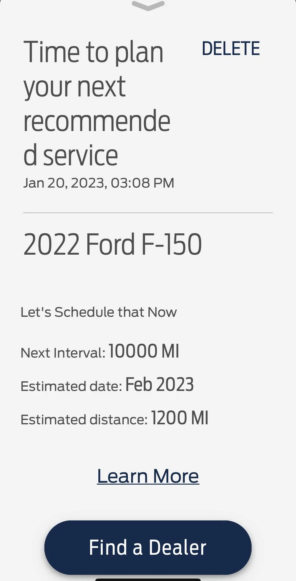

Is FordPass ignorant or am I? why is it prompting me to to perform 10000 mile service on a lightning. there is no engine oil to change...
You are. ;)
Maybe, just maybe, because that's the maintenance interval, as shown in FordPass and your manual? [shrugs]

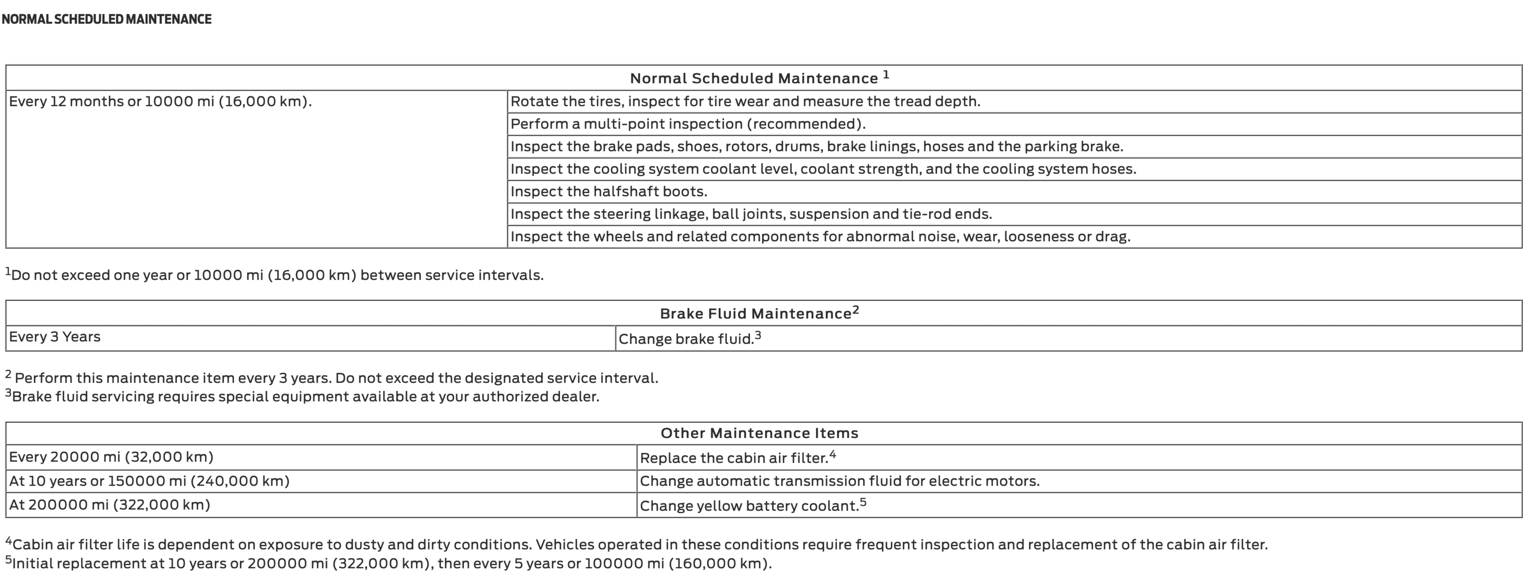

Here's the relevant page from the owners manual. Takeaway is that you really don't need to do much maintenance besides rotating/replacing tires and doing some inspections.
20,000 miles - air filter
3 years - brake fluid
10 yr/150,000 miles - electric motor fluid
200,000 mile - battery coolant
I'll probably test the brake fluid at 3 years and do my own air filter replacement. Other than that the truck shouldn't have to see a dealership for 150,000 miles for any scheduled maintenance with is great. Random things will occasionally break just like any car but certainly the days of bringing in your car every 10,000 miles for a servicing are long gone. It's part of the reason why dealerships have been hesitant to switch to EVs, because there should be a lot less revenue from the shop side.
