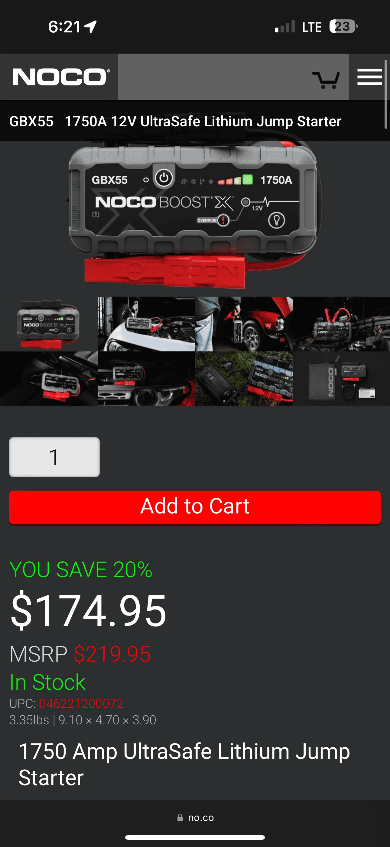

Just curious if there’s any reason not to use a jump box like this NOCO GBX75 1750 amp lithium jump box on the lightning 12 volt battery in a case where the 12 volt battery was dead and needed jumped? The lightning owner manual says the motorcraft BHAGM-H3 is the replacement 12 volt. This is an AGM battery (not lead acid) and so I’m just curious if there’s any reason to not use a jump box period on the lightning 12 volt battery or if an alternative jump box since the NOCO says to only use with lead acid batteries?

AGM batteries are lead acid batteries. There are three types of lead acid: flooded, gel, and AGM. They do have some differences in charge curves but you can use that jump box with any of them.

OK, I'm certainly not an expert on anything, but how would that work? You would want to "charge" the battery, not "jump" it, right? The NOCO web site says: "No. While Boost can jump start your car battery it is not a battery charger. If you need to charge your car battery we recommend using NOCO Genius for charging and maintaining 6V or 12V batteries lead acid, AGM or Lithium batteries.
Click here to learn more about NOCO Genius Smart Battery Chargers." Wondering how...

I think the goal of using a jump box on an EV with a dead 12 volt battery would be to get the vehicle “on” so it could be driven. Once the lightning is “on” which requires a 12 volt battery to initiate, the high voltage battery will then take over and supply any power needed through the DC to DC converter (which takes high voltage and reduces it down to low voltage like 12 volt to supply accessories). It would not eliminate the need to replace a bad 12 volt battery but prevent you from being stranded until you could get it replaced.

It works. I have one and used it to jump the lightning. I had a dead 12v (separate issue-the replacement seems like it’s now dying) and rather than deal with a tow I got one of the battery jumpers from Amazon and it worked perfectly.

I was just trying to say that obviously there’s no engine component that requires cranking and turning over to get started, so the only thing to provide power to is whatever the truck needs to go into its “ready to drive mode”. Yes I agree its the same thing, I’m just really interested in knowing if the 12 volt battery can’t be jumped but has to be “charged” in order to drive the truck. The NOCO boost X I have won’t charge the battery, so is it going to help me in a situation with a dead 12 volt battery? Again, Grantmethepower, said he has one and it worked when he had a dead 12 volt battery, and people on other forums are saying these have been used for a long time on EV’s. So I’m assuming what I have is good for that type of situation.

I'd leave the jump-pack connected to the battery if the LVB was too flat to do anything. A cheap lightweight one that's charged would probably be plenty. You don't need the high-amperage short "jump" boost from the pack to provide big amps to a starter motor.
