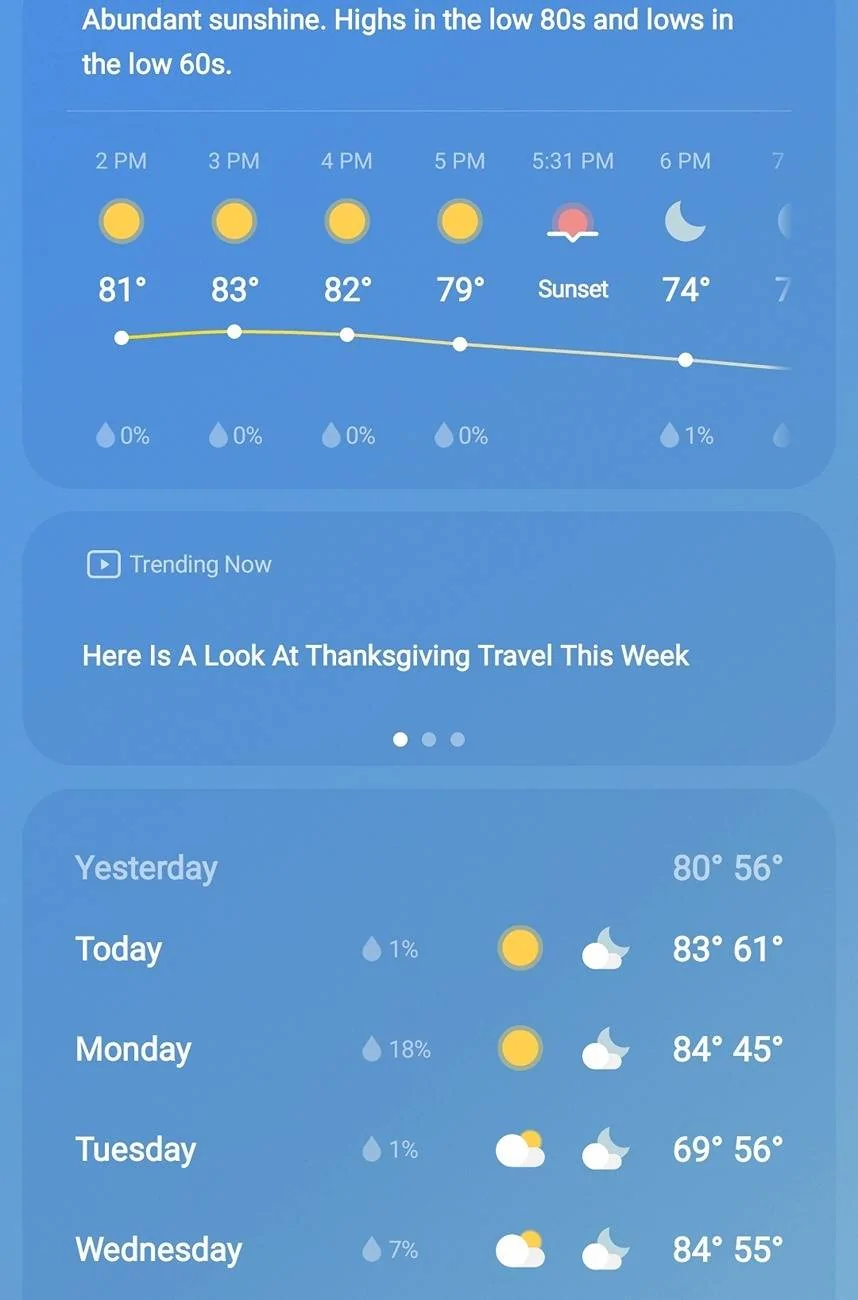

Winter? It is still 80 degrees here. The visit into the fortys is still occasional. This is not winter. I charge during the day.

I get those facts, what I'm saying is that your suspicion that the rules have changed might be on point, so you're seeing a temporary depreciation in range projections.
There could be a flaw in the logic where the truck is taking the national profile, recall the promotions by Ford that they are always factoring our driving experiences based on seasonal & location based conditions, your truck might think it's in Nome Alaska if the data is actually off kilter.
