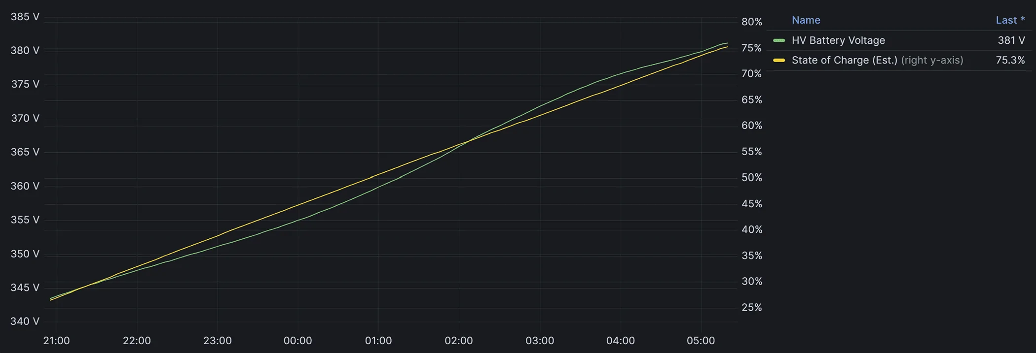

Here is a graph from another thread. While doesn’t go down to zero it gives a nice representation of the voltage based on SOC.

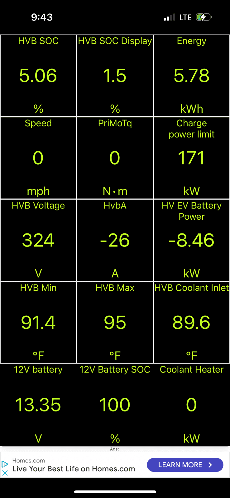

Well she is back from the dead. It took 6 hours of level 1 in the driveway, but I finally got HVBSOCdisplay to 1%. I was able to drive into the garage and hook up to level 2. Could not drive until the truck showed 1% even though the battery had some power. Looks like I won’t need a ride to work in the morning after all. Screenshot right after hooking to level 2

I just saw this, what you went to rough is “normal” as in same as my experience in terms of a slow recovery and charge rate after it dies. It took me several hours to recover using a L2
Take it to the dealer but be prepared for a non answer, I was told my first time it was the BMS. Second time it was a bad module. 3rd time, I didn’t even take it. I’ve come to terms Ford doesn’t actually have a fix or know what the problem is.
For me, the commonality was DCFC. Multiple DCFCs caused the BMS to get out of sync and be inaccurate. But you didn’t DCFc on this right? It was a straight shot?
