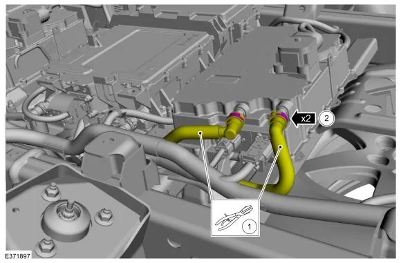

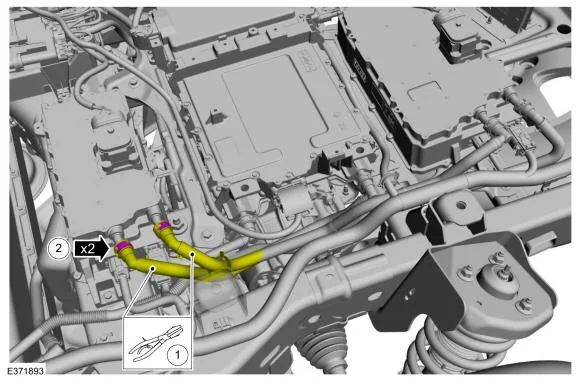

Hi, everyone. Many of us have wondered why the truck has to be running to use the PPO system. It’s a silly requirement for a an EV, but a cooling requirement makes this more plausible.
I was pawing through the service manual and saw that both inverters under the bed are liquid cooled. They each have coolant lines, and you have to remove the bed to service them. The upside is that you probably can’t overheat them with heavy use, but the Bush league software engineers at Ford may have a harder time enabling full-time use in a software update.
The 2.4 and 7.2 kW inverters in the hybrid F150s are also liquid cooled, but they’re lower and can be removed without disturbing the pickup bed.
Ford F-150 Lightning The PPO inverters are liquid cooled IMG_0061
Ford F-150 Lightning The PPO inverters are liquid cooled IMG_0062
