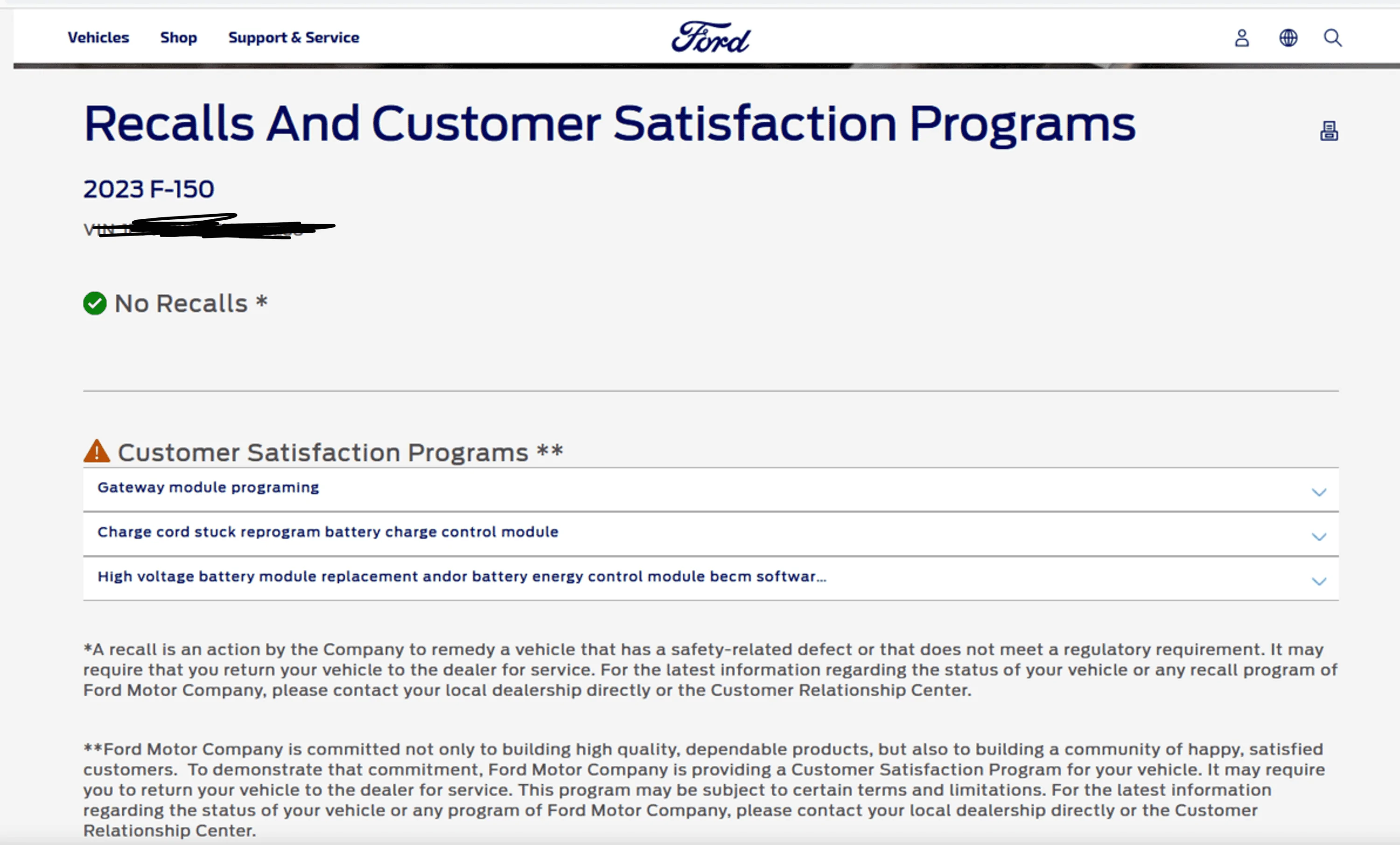

Hello folks,
I just received an email from Ford that my truck has an open service action that needs my attention. When I log in to my Ford account, I see 3 listed "Customer Satisfaction Programs" (image attached). Is this an across the board thing? Anybody else getting these and know anything about it? I'll call my dealer, but I'm sure they'll be clueless. There's no issues with the truck and no errors showing up on FordPass.

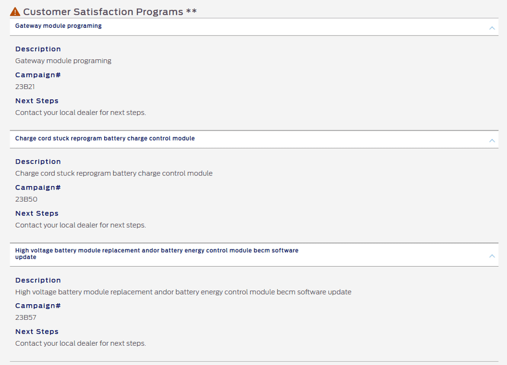

Here is a close up of the 3 items expanded:
Ford F-150 Lightning Your Lightning has an open service action... Picture2

You have 3 CSPs. You can a) make an appointment to get them done, or b) wait, and do them later (some are also OTA updates so if you wait you don't need to take it in).
These are in fact "issues with the truck".
I also have open RECALLS, like the stoplight, so I'm getting it all done.

If you do an individual search for the campaign codes 23B21, 23B57, etc. you'll find oodles of posts and comments to bring you up to speed. Especially 23B57 (the battery module one).

Not necessarily. That one seems to be hanging around for all of us, even though it has been completed.
I think Ford made a mistake by not separating this one into two actions: one for the software update and one for the module replacement. I’m guessing they are leaving it open because even after the software update there could be a module failure that requires replacement. By combining them they confused the dealers and there’s no good way to track who got the software update.
