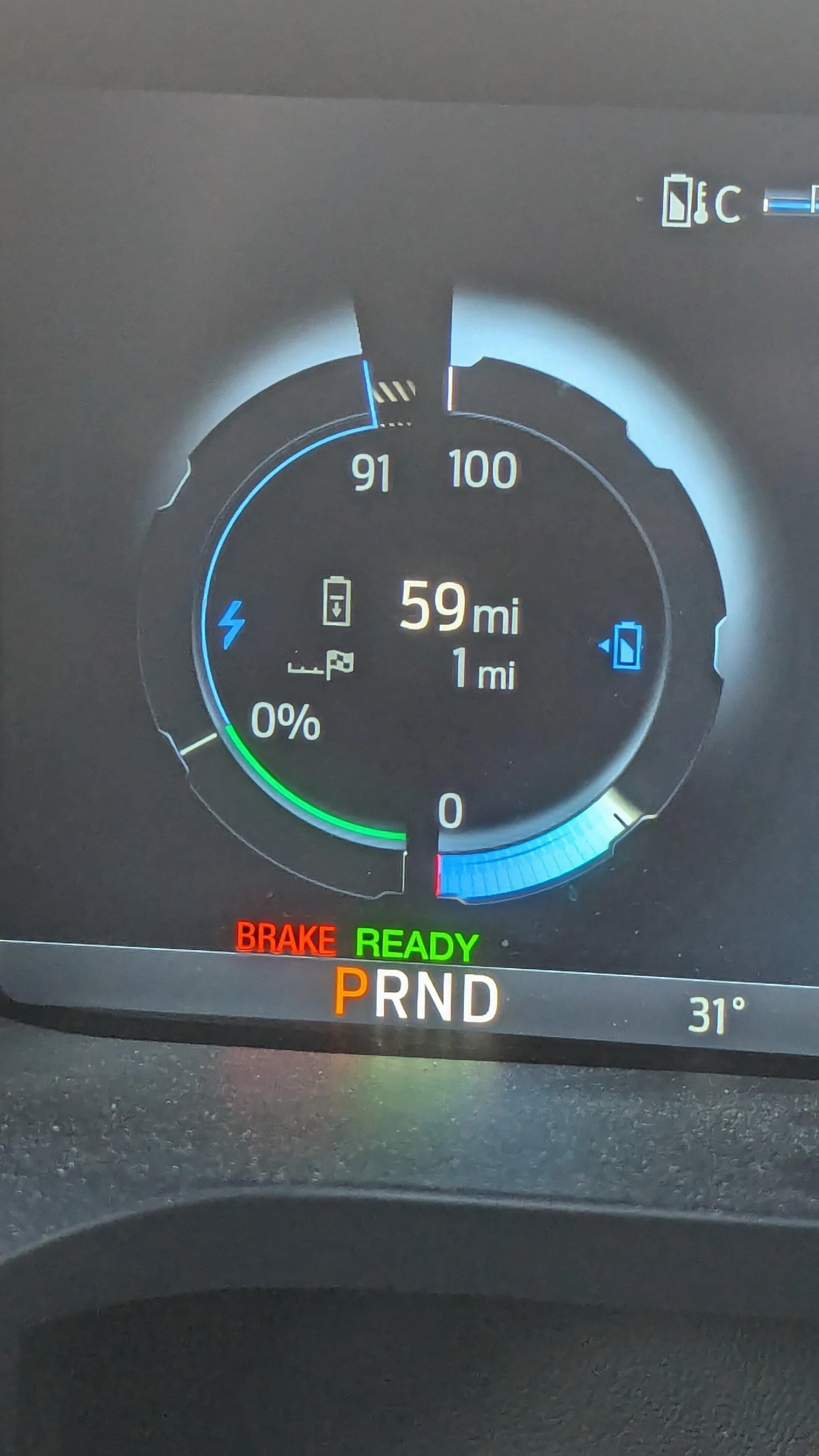

Just happened to me. Oh well, left Tesla for this.

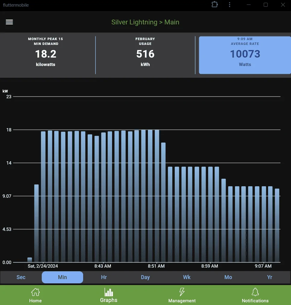

If have looked at the motor power on prior incidents but not the one that occured on the 16th of March, previous observations showed no power to the front motor which we've suspected is tied to intermittent HVB contactor(s)
Yesterday I did a road trip to southern NH, but this time only charged to 90% SOC, I did a battery conditioning routine with departure timer, consuming 4.3 KWH to warm battery & cabin, no errors occurred during startup and the trip was uneventful.
