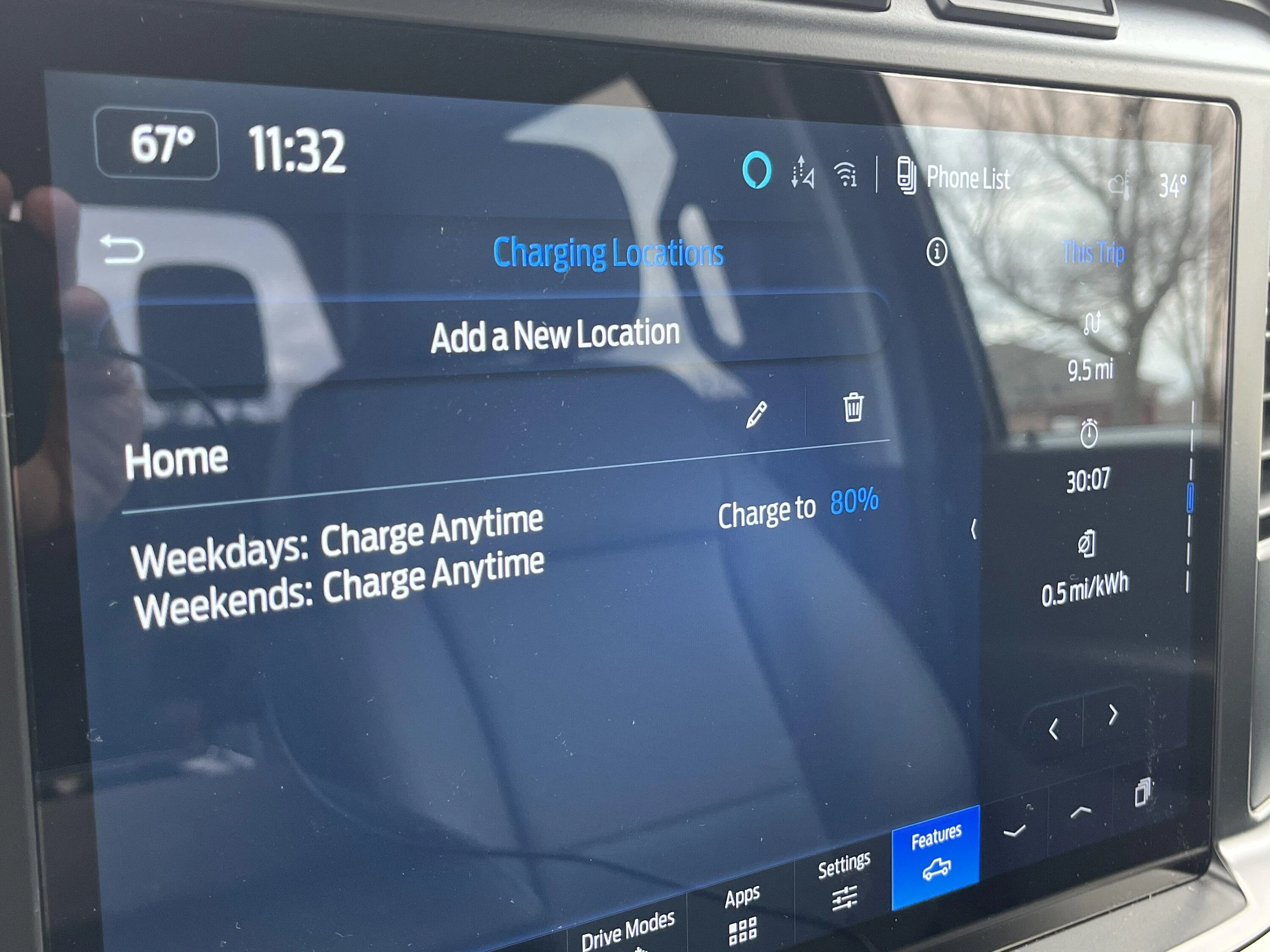

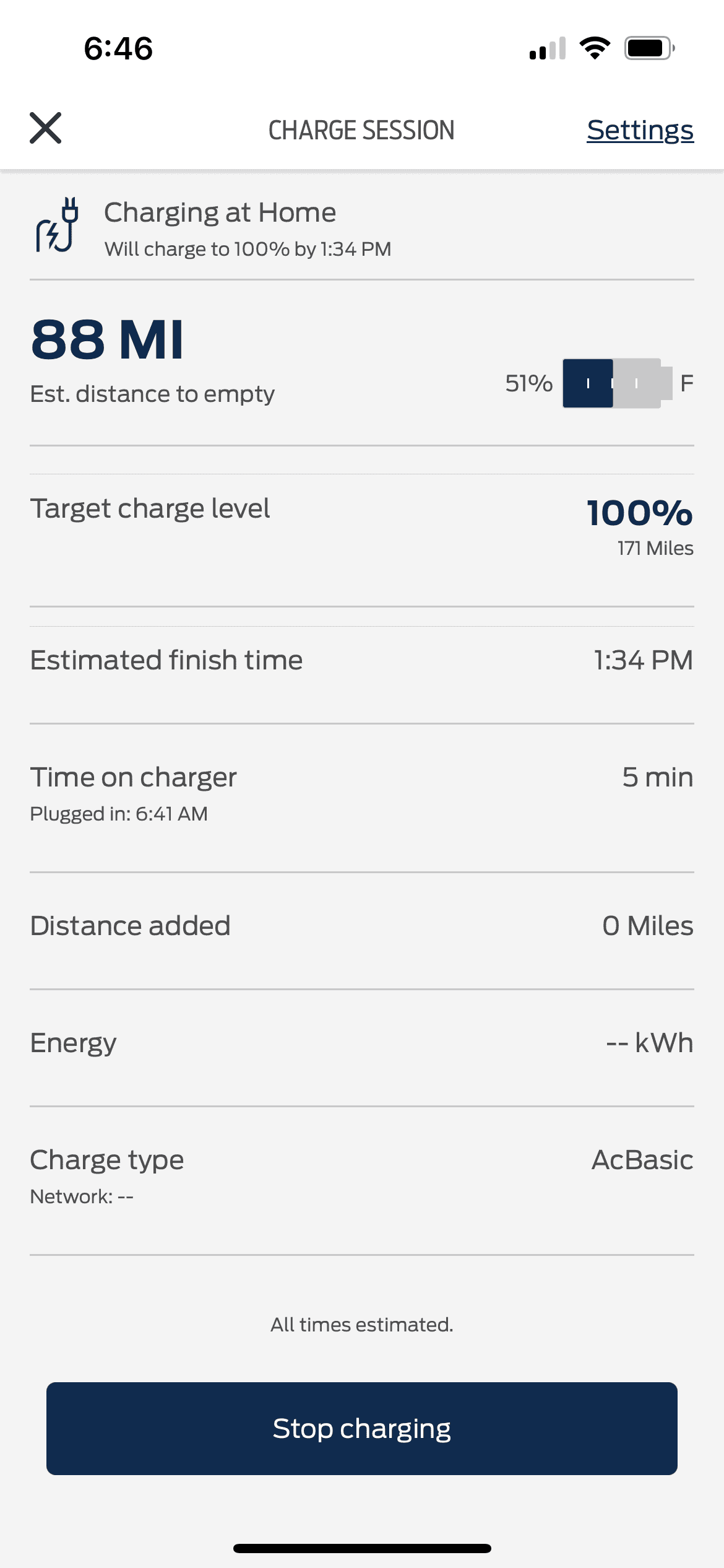

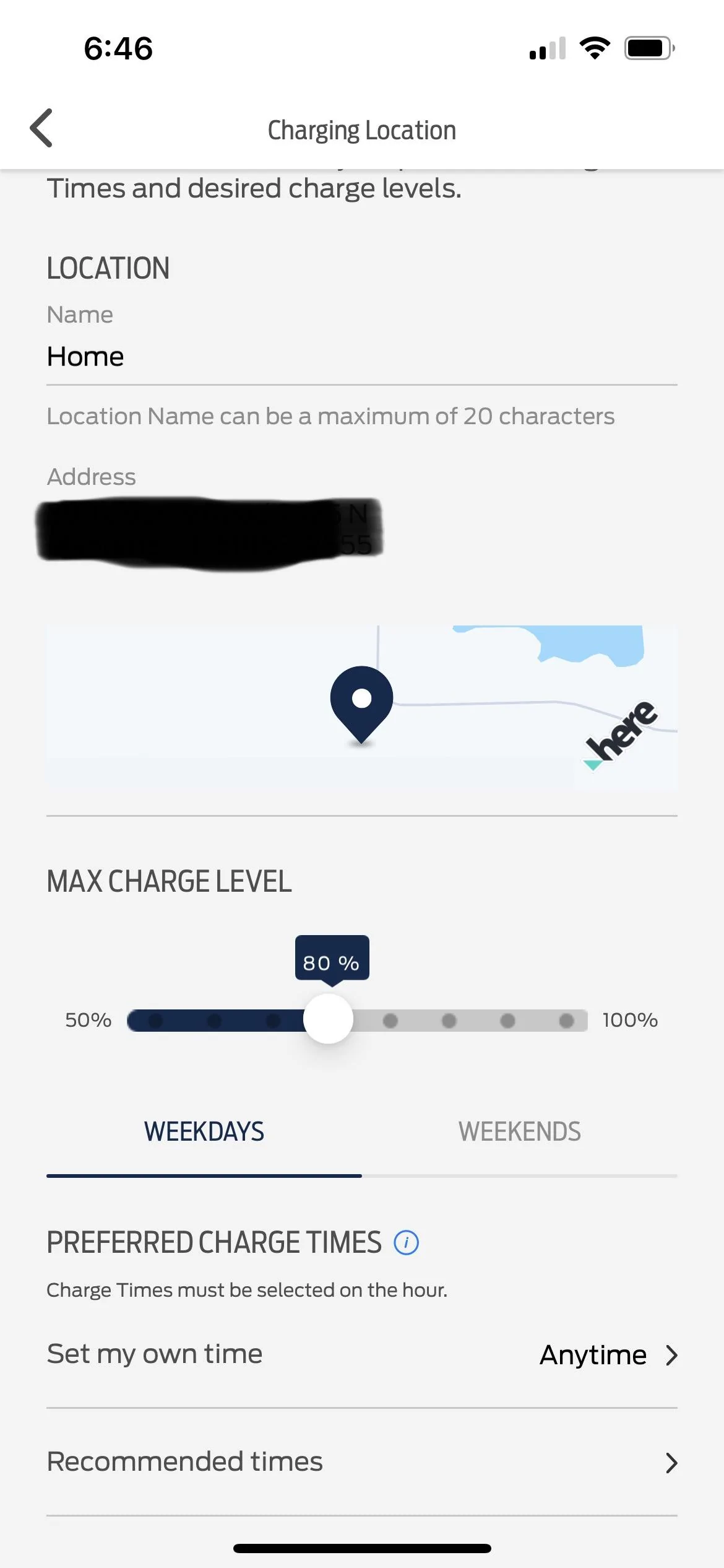

I read a ton of posts about this issue prior to getting my truck, and I thought I had it figured out. Was working initially. Have the truck set to 80% at home. Have the app set to 80% at home. Have the home address set. Truck SHOWS it’s at home, so it’s not confused…and yet app says charging to 100%!
What am I Missing? See photos.

To use your home settings you must select "Use preferred charge settings". You cannot select "Charge when plugged in".
Thank you! That must have reverted during one of my 12v “resets.”
I’ll change that 1 setting and then give it another go. Seems like there are unnecessary layers of complexity between truck and app settings to get this done!

How do you eliminate the selected charging times so that Ford supplied charger begins charging whenever it is plugged in. I can’t find that option on the application or in the truck
Select "Anytime" under "Set my own time"

I have looked but can’t find that option. All I see are clock settings

Click Delete Locations to remove the profile.

In the Sync screen, you can delete it as well, (truck needs to be in accessory or run mode)
Trash can icon
