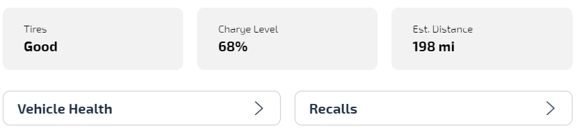

Am I going crazy? This CSP appeared yesterday in Ford Pass. And today it is missing? My truck was plugged in and charging over night, wonder if that alleviated the triggering condition for the CSP?
Have you tried here?
Ah nevermind I don't see it in there...but there's a lot of other stuff....
And that CSP is still active for me in my owner site (along with the rear light bar).

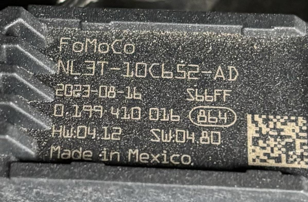

Hey if you buy the part yourself would you send me the old one instead of throwing it away? I love looking inside these things. The 14thGen forum has a BMS thread over 50 pages long (they are having a different set of 12V issues). Looks like the sensor might have a Hall Effect sensor or shunt along with a thermistor for temp. Appears to send this info to the BCM via the LIN bus. What I haven't found out is if sends the raw values (voltage, current, and temp) and the BCM calculates SOC, or if the BMS itself calculates the SOC. It must be the latter if they think the SOC issue is fixed with a new BMS. Supposedly it has a small microcontroller inside and that's what I want to look at. But the answer may also be in the 59 pages of that thread (I am only on page 3 :) )
EDIT: I am going to ask to keep the part when they come replace it but I know they typically aren't allowed to do that for warranty work.

FWIW, I have the defect part and only failed during one of the updates. The rest went through flawlessly.
