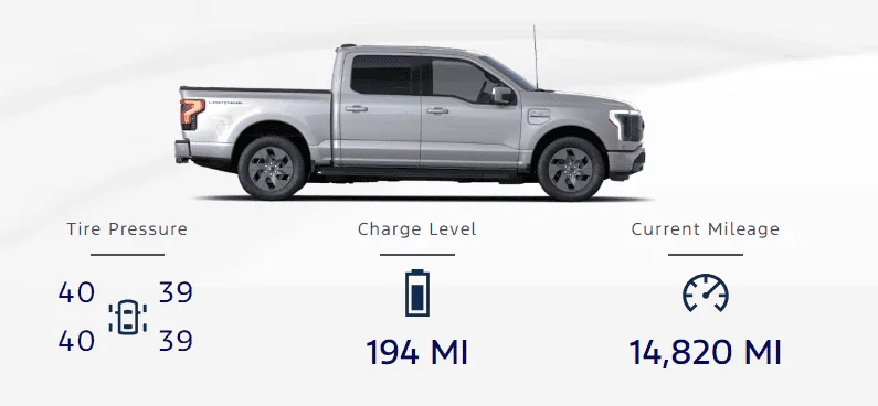

Nope, but you can see more accurate information about the LVB SOC and the trucks estimated range here https://www.ford.com/myaccount/account-dashboard
This link is where I got the screen clip. It was not clear since I just copied the Charge Level data. About 25% of the time when I check Charge Level at Ford.com > Accounts, I see mileage versus % charge displayed.
