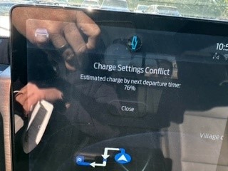

This am my truck did not schedule start and warm up after working ok Thurs and Fri last week. Got this message I have not seen yet at the start of my second drive today.
That message is telling you that right now, the truck thinks that you'll only be at 76% by the time it is going to do the next departure time, i.e. it won't be charged to the level that you specified (80, 90%).

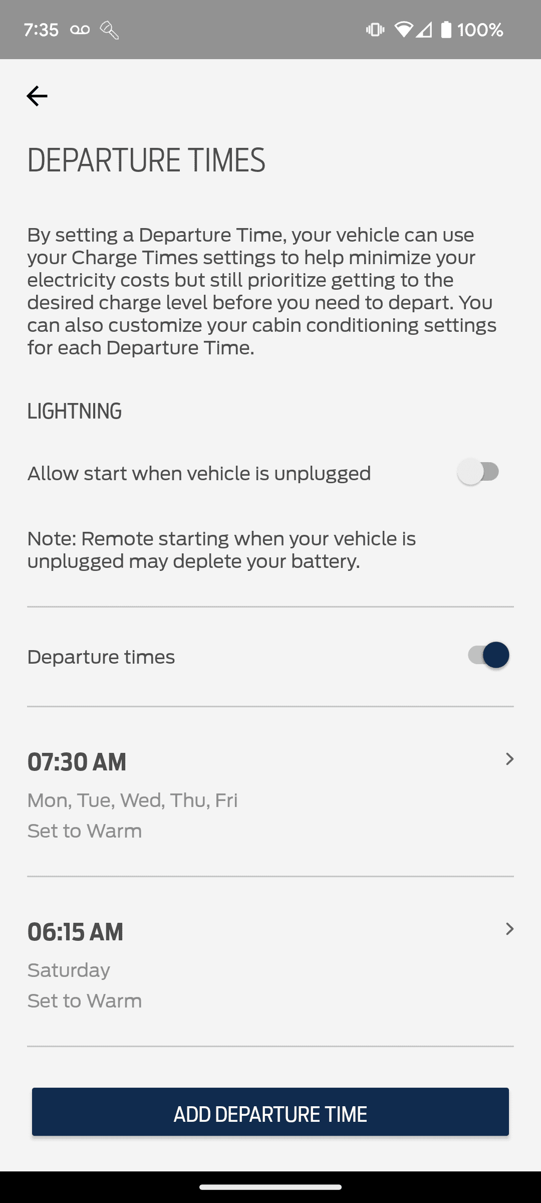

FWIW my Fordpass was unresponsive last night as I was trying to turn on my departure schedule for today. (I have an alternating week work schedule so I have to turn my schedule on/off).
After the drive today with no preconditioning. (Remote start wouldn't wok either) I tried Fordpass again at work and it worked.
I received notification that an update was pushed last night...so that *may* have something to do with it.(Update: Ford Power-Up 3.5.3)
