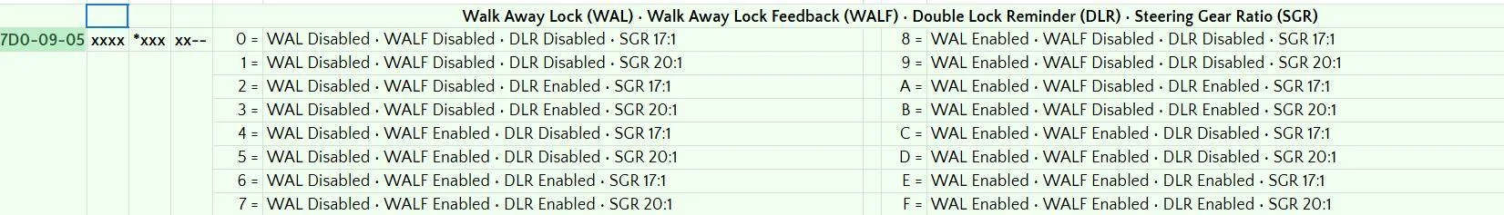

If they're updating the BCM, it will enable Walk away lock. It's on by default so you will need to use FORScan yourself to add the toggle on the center screen if you don't want it as this isn't something the dealer will change. Mine was initially 0 so I changed it to 8 since I didn't care about the feedback
