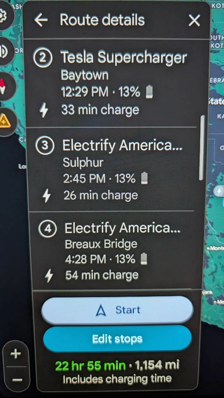

I plugged in a route and it added EAs, Tesla superchargers, EVGo, etc stops with > 10 min charge times.
What's your Google Maps and Android Auto version number?

Android Auto is the same. Downloaded your version APK and same result. Im gonna pull the 12v for a hard reset and beyond that I'm out of ideas.
Post a picture of what you're seeing

So just discovered that you apparently can change a charging location if you have multiple charging stops but you have to start the route. Seems like a bit of a miss by google.
https://www.ford.com/support/how-to...se-android-auto-ev-routing-for-ford-vehicles/
Replacing Suggested Charge Stops
Select your destination. A preview of the route displays with suggested charge stops.
Tap the Replace button on the route preview.
Note: If your route has multiple stops listed, the option to replace displays only after you start the route. It is located under the teardrop icon.
Select an alternative charger from the list of chargers along your route.
Tap the Select stop button
