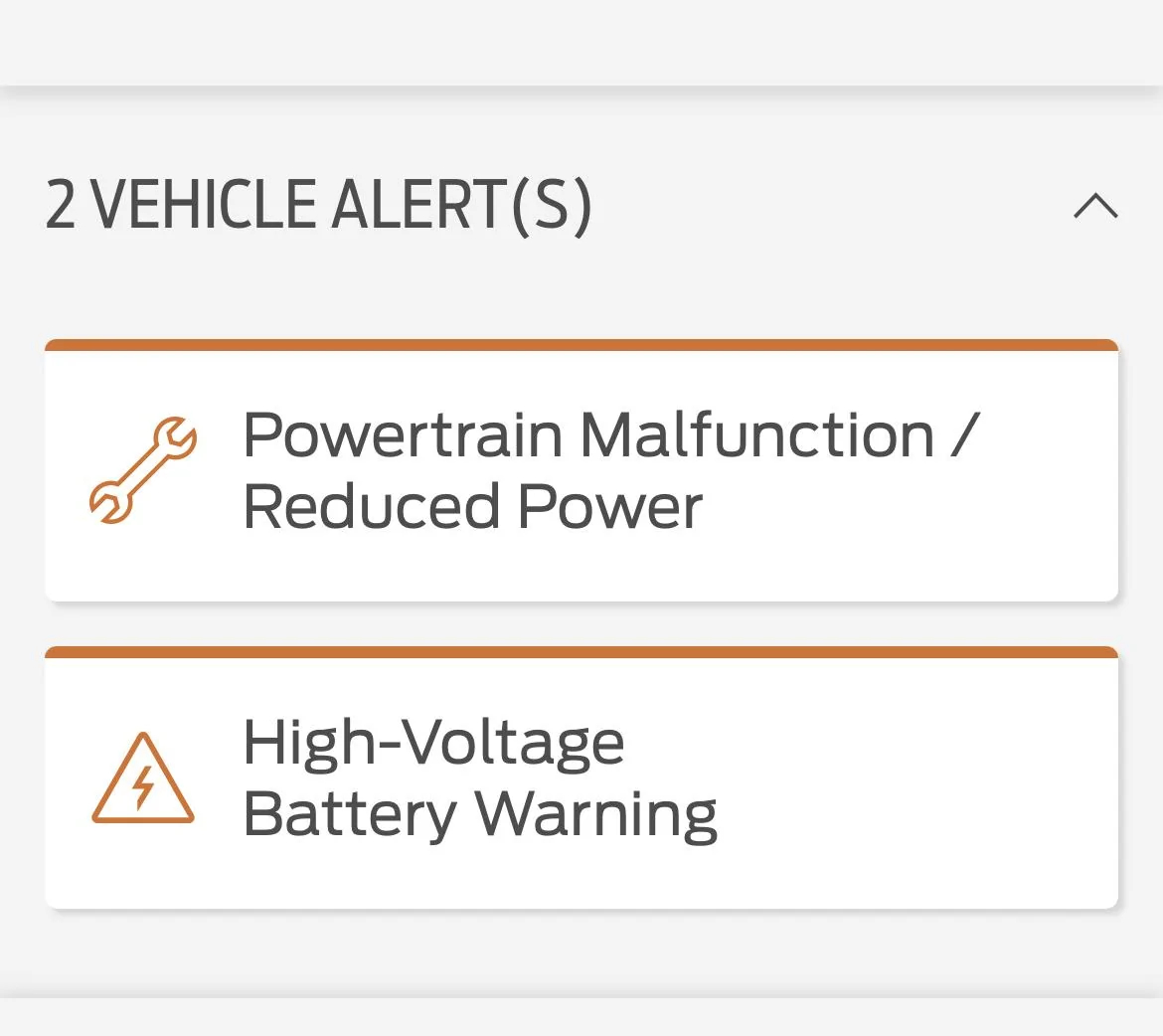

Ugh, got the Powertrain malfunction / reduced power and a High-Voltage battery warning, power is reduced. I was able to borrow my neighbor's car to get to work this morning. I called my local dealer in Temecula, they said they can't fit me in until Monday (today is Friday) and a loaner will not be provided. Is there any way I can fight this? Doesn't seem right that they wont provide a loaner.
Addendum: My local Ford did end up approving a rental from Enterprise for me! I am less stressed about this now, hopefully they can figure out the issue soon.
Call Ford BEV Team, try to get them on your side from the beginning.

Hi there! Will you send us a message with your VIN and your local Ford dealer? I can look into things on my end.
