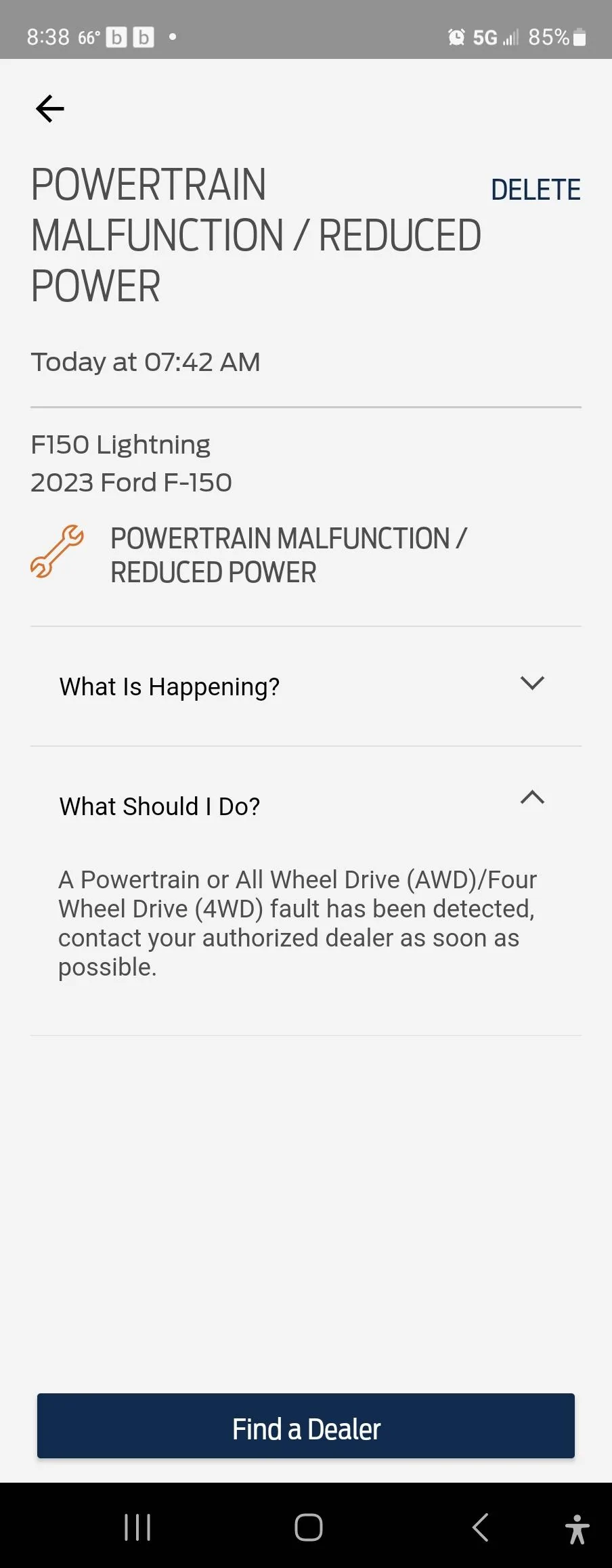

2023 F150 Lightning XLT , 2004 miles ; Same problem reported by many. 7:30am 70 degrees outside temp. Drove out into a busy intersection for a left turn and the truck died with the Powertrain Malfunction error (limped at about 5mph), very dangerous situation. The service (yellow wrench ) light stayed on . I was able to pull over and turn everything off and on again, truck worked but service light stayed on. Drove the truck straight to the dealer and left it. Strange that I was the only vehicle there for service and was ignored for 30minutes while all the service personnel seemed to enjoy hanging out with each other. I got out and and asked if I was supposed to go to the service window and let someone know I was here and they said, no just wait in the car someone will be out. Eventually a service rep came out and signed me in, said that Electric vehicles take about 3 days to evaluate because of the workload. This is one of my company's fleet vehicles. Not impressed so far.
Ford F-150 Lightning Powertrain Malfunction/ Reduced Power Screenshot_20230821_083803_FordPass
Ford F-150 Lightning Powertrain Malfunction/ Reduced Power 20230821_084145

So my 2023 Lariat is in the body shop (stupid deer) and this alert showed up in my Ford Pass app yesterday morning. These threads have me worried, but at least I can say with complete certainty it wasn’t anything I did.
It's possible that in order to safely work on it, they needed to do a high voltage disconnect, which might trigger the same error.
