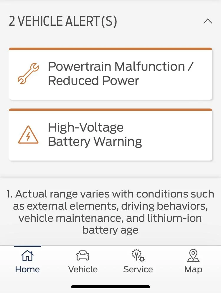

What has been the average time at the dealer with this issue, I am about to wrap up week four with no new information. Dealer tells me the part is a couple days out, Ford tells me the part is on a regular shipment (no idea what that means), the BEV that reached out to me back in February about this issue, (with no result with I'll admit I gave up because it wasn't getting anywhere back then) hasn't responded. Just starting to get very impatient.

I made it just over 5,000 miles, trouble free until a couple days ago. My 2023 Ford Lightning Pro broke down. Now in the shop (Healey Ford in NY). High Voltage Battery Warning. The dealer called the next day and said a battery module needs to be replaced and it's a week out. I was hoping it would be a quick fix, I'm used to Fords always throwing lights and codes. My Edge and F350 throw a code at least every couple of months (EVAP, WIF, TPMS, EGT sensor). I could keep driving them, not so lucky with the lightning. So far the dealership is doing the best they can. They were able to give me courtesy vehicle after initially thinking none were available.
Dealer told you a week for the battery module, a week has come and gone, did you get it back yet?

I have a feeling I'll be in the same boat. It's over a week and no word from the dealer. My app still shows the HV battery warning and the same charge when I dropped it off.
