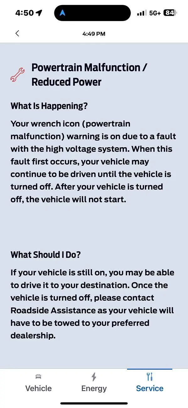

Hey there, bought a 23 xlt er last April and have loved the truck overall/so far. Have put 27,000 miles on since. Two days ago the orange wrench showed up with powertrain malfunction, service soon. Call local dealer/shop where it was purchased, can't see it until April 6, then probably at least another month for parts(just guessing by reading all threads I could find)
No loaners. I called the 1-800 on ford pass to open up a claim and ask about rental reimbursement. They said yes, but has anyone on here been through this, I'm looking at potentially 3 months without my truck. How fast/slow is the reimbursement process, and now my faith in Ford is out the window.
I live in Montana, everything tech moves slow out here. Also, shop guy I spoke with told me to go ahead and keep driving until he can get me in next month. Noticed this morning that cabin heater does not work. Without the seat heaters It would be too cold inside to drive it. Any info would be greatly appreciated

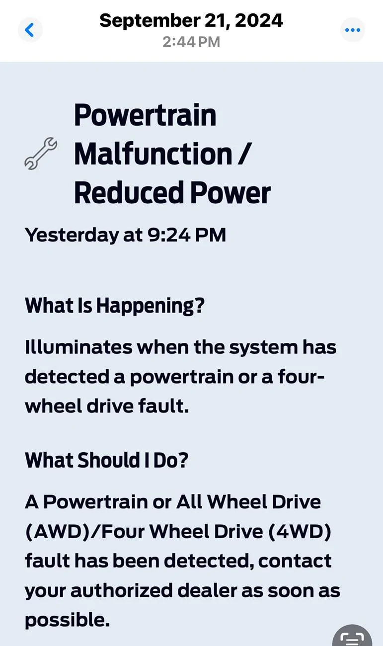

2024 Lariat ER, 9.3k miles with the standard symptoms. Don't have the build date at hand because the dealership has my truck (is it on the window sticker somewhere?)
  • 2/21/25 came out in the morning to the truck having not pre-conditioned, battery not fully charged to my standard setting of 90%. SOC was mid 80s
  • Started the truck, got the yellow wrench, service vehicle soon, powertrain malfunction/reduced power, and 57% power available
  • Replugged the charger and got a charging fault, amber ring of death
  • Tried a few DC fast chargers that night to see, faulted on each of those as well
  • 2/24/25 dealer started running tests, believed that the battery modules just needed reprogramming, no loaner available, no ETA
  • 2/25/25 further testing, dealer found the bad battery module, still no loaner available but they're working on it, ordering battery module
