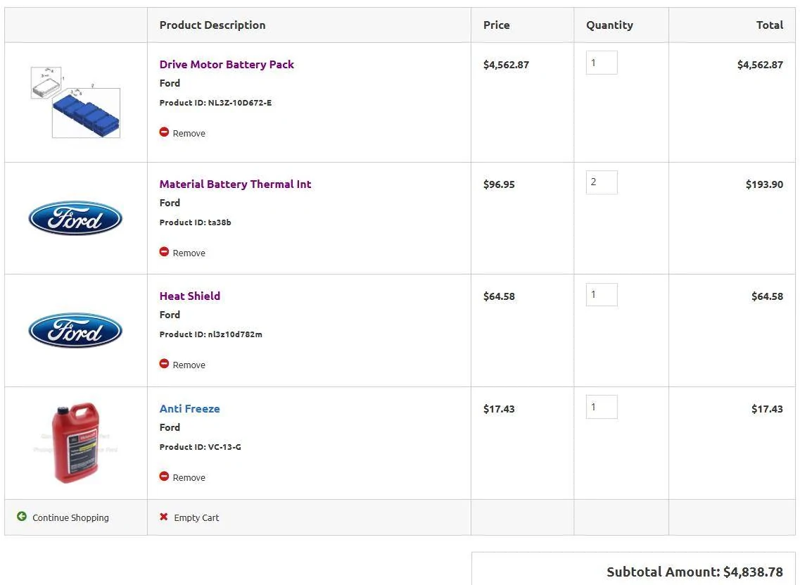

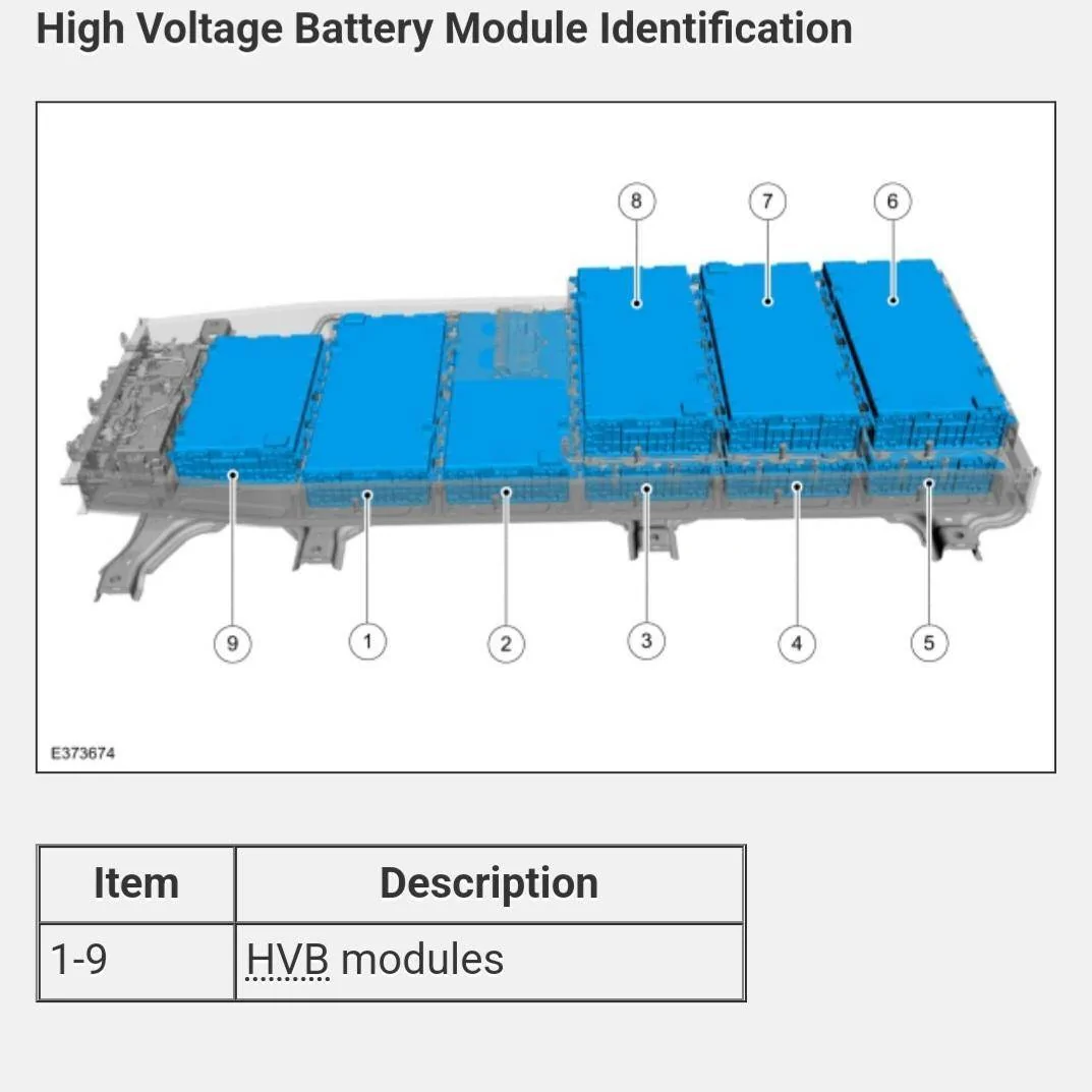

Is one of the first eight battery modules. Eight @$4562.85 is $36,502.96. What is the part number for module #9 (the front one)?
This could get expensive…

They told me only module 7 was replaced. But the invoice shows qty 2 for the battery pack. That’s just odd.
TA-38-B is the thermal compound to place between cooling plate and battery.
