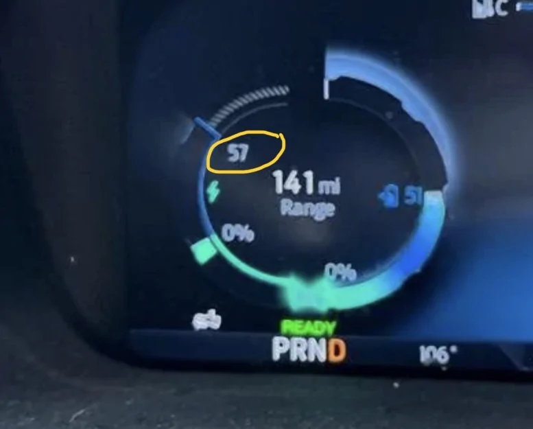

You say you don’t notice a power reduction. But your power gauge may still show one. Typical reduction is 40% or 57%. Notice the dash line leading to 57 here.
Ford F-150 Lightning Powertrain Malfunction / Reduced Power IMG_0634
But many others with this issue do still show 100% power.
