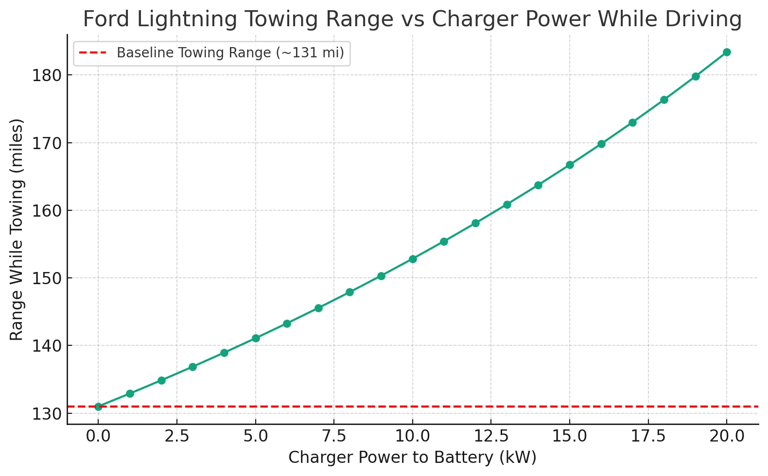

If towing, and getting an efficiency of say 1.0 and charging at 19kw (~80a charger).
1️⃣ Power draw at 70 mph towing
  • 1.0 mi/kWh → 70 kW draw
2️⃣ Net battery drain with charger
70−19=51 kW70 - 19 = 51 \, \text{kW}70−19=51kW
3️⃣ Effective battery efficiency
70÷51≈1.37 mi/kWh (battery-derived)70 \div 51 \approx 1.37 \, \text{mi/kWh (battery-derived)}70÷51≈1.37mi/kWh (battery-derived)
4️⃣ New range
131×1.37≈179 miles131 \times 1.37 \approx 179 \, \text{miles}131×1.37≈179miles
✅ Result while towing:
  • Without charger: ~131 miles range
  • With 19 kW charging while driving: ~179 miles range
  • Gain: +48 miles
And since chat GPT was being so handy, it made a chart of towing range gain with various charger inputs.
