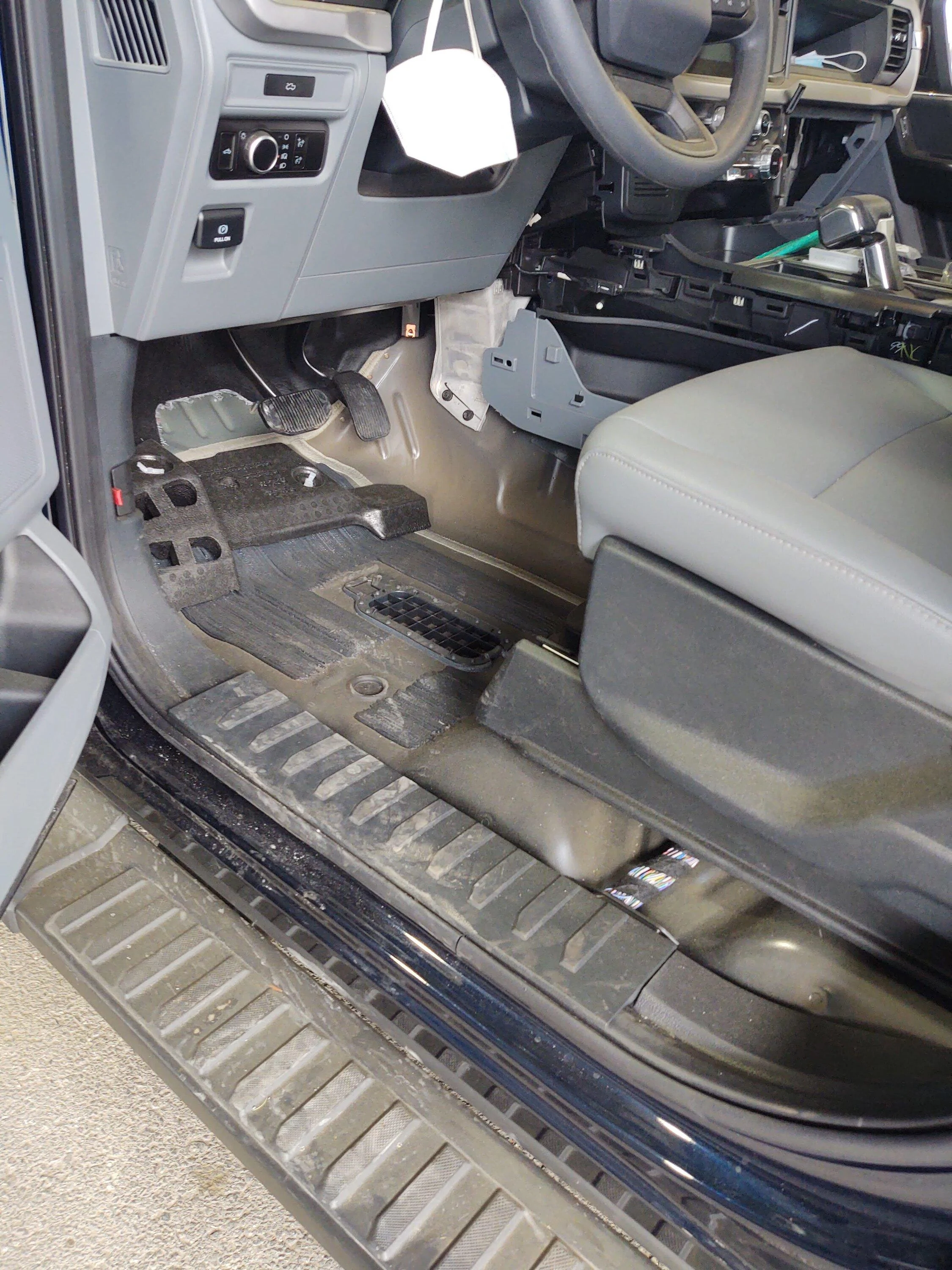

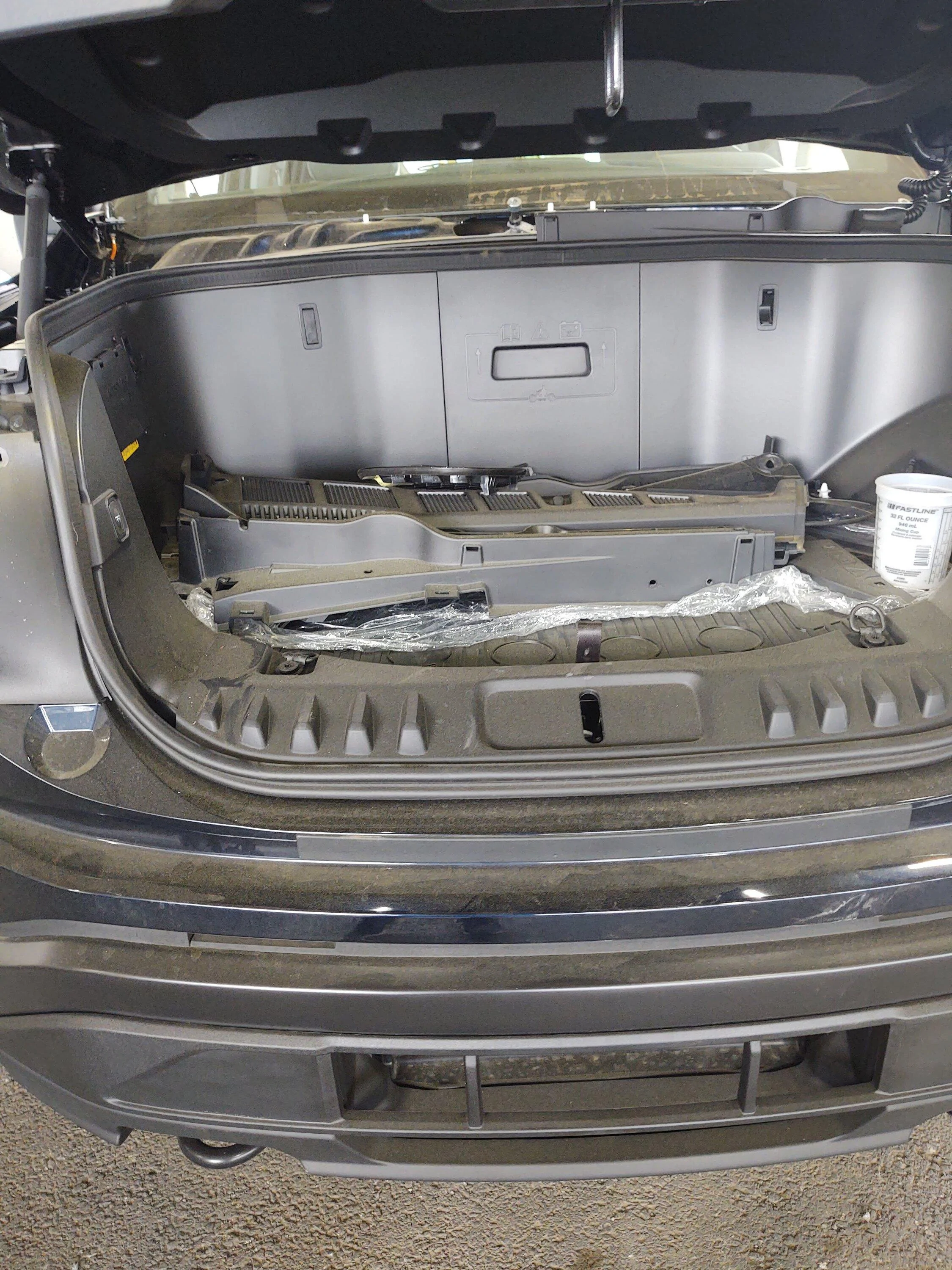

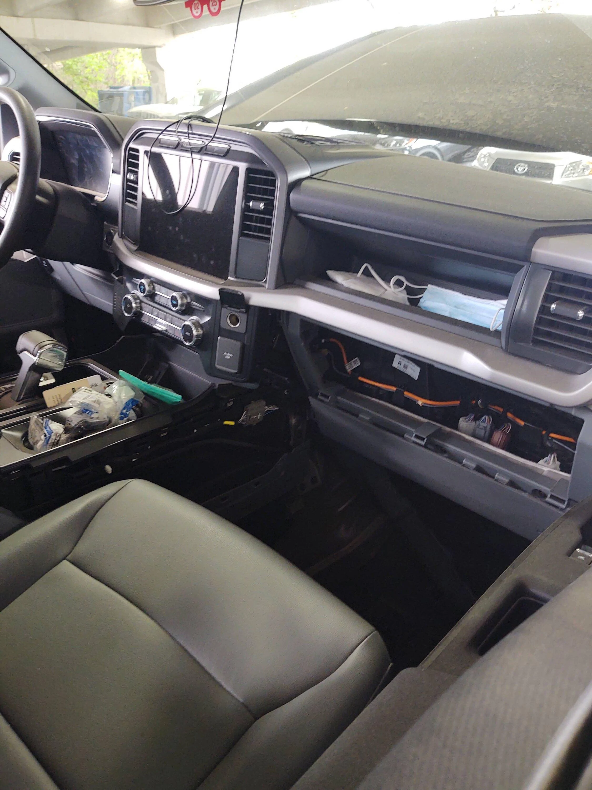

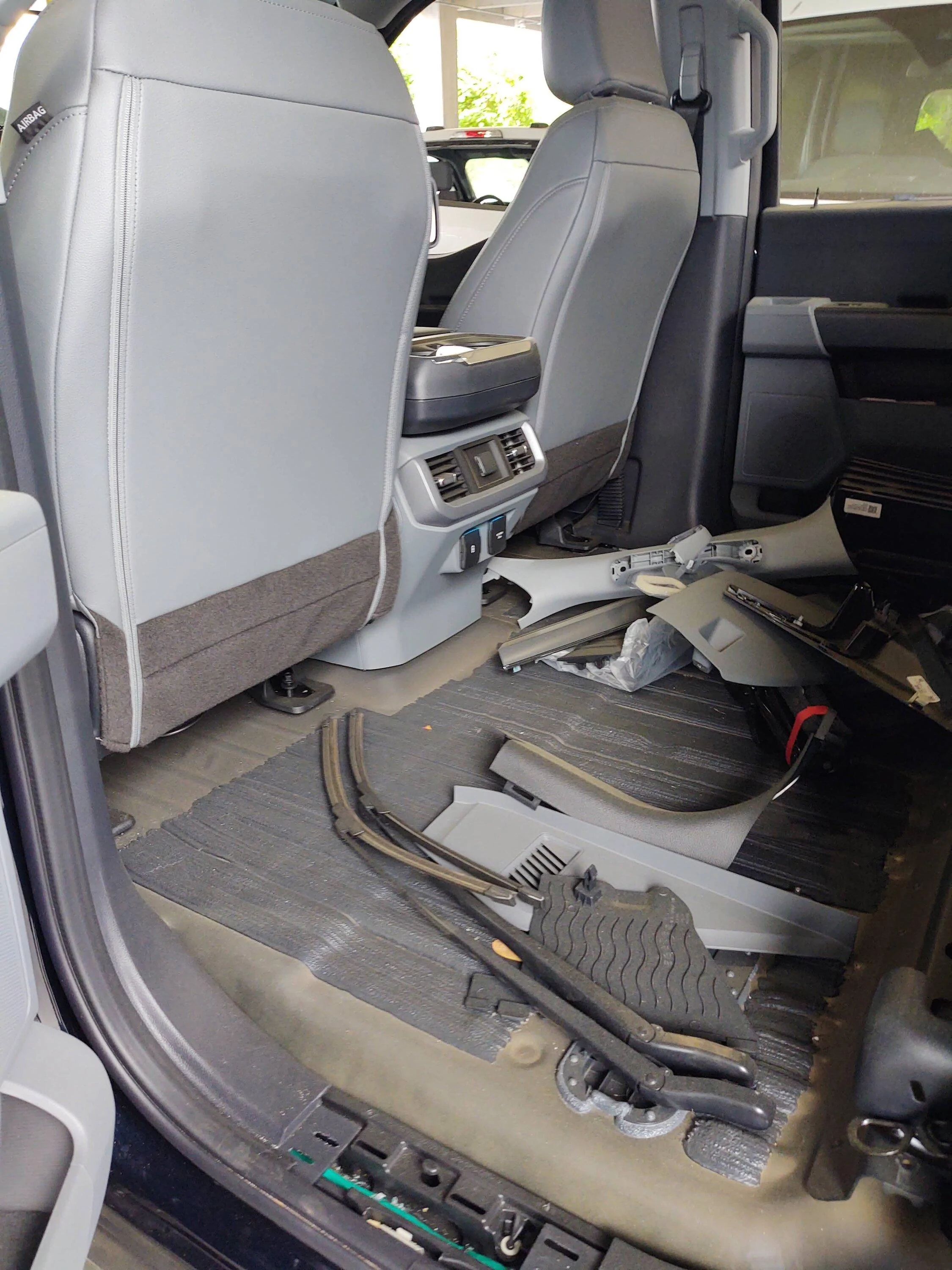

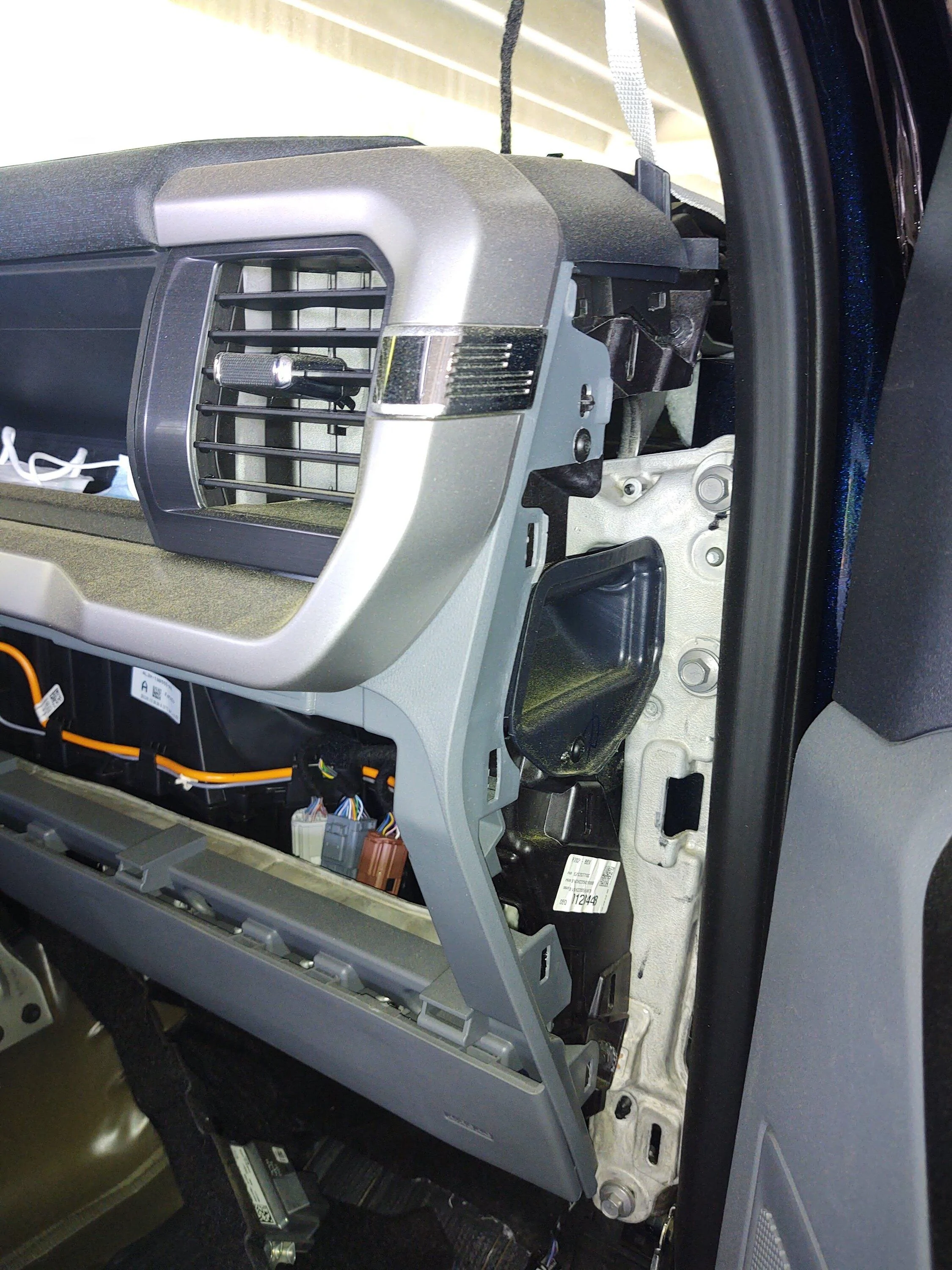

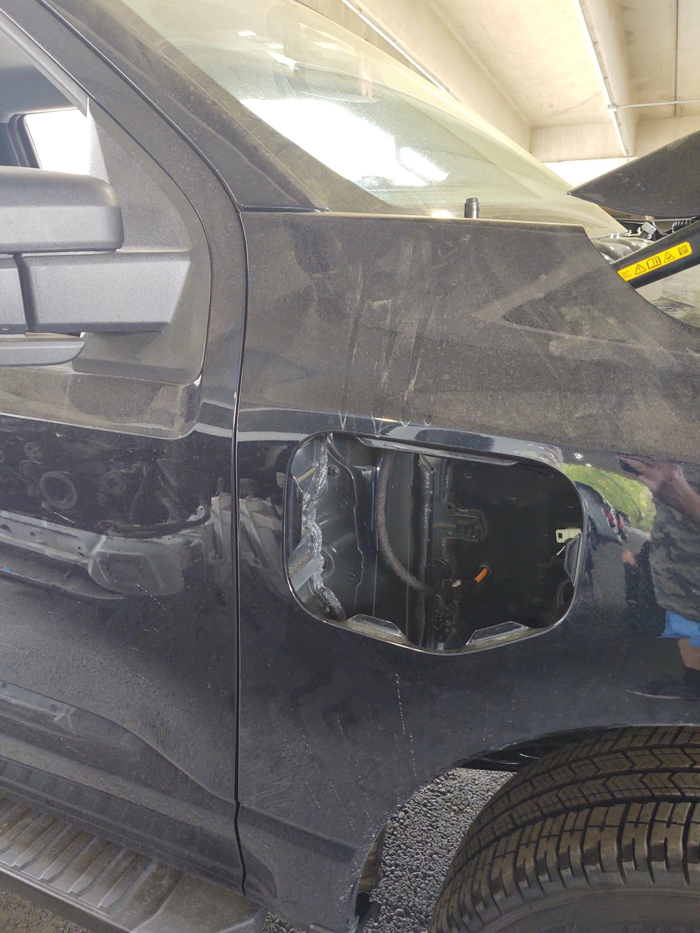

Just providing a long and overdue update in case anyone else is dealing with a water leak.
-2 full months at the dealer's shop and they've finally diagnosed the leak as a body seam leak between the cab and the frunk compartment, passenger side under the firewall. Solution is to pull out dash, firewall and other ports to try to access the seam. No timetable for fix. After a bit of back and forth, dealer was at least able to secure commitment from corporate for new carpets to replace the moldy ones- but not sure how they will handle the moldy odor in the cabin.
Of course the cherry on top if that the truck also had the high voltage failure while they were diagnosing the leak. (I guess I should consider myself lucky the truck leaked and was in the shop so I didn't experience the voltage failure while driving?)

So unfortunately they still haven't identified the specific seam. The water guy can see the trickle of water from behind the dash but they still need to remove more parts to get to the actual source of the leak. The feeling I was getting was they had no interest in moving forward with the repair and were waiting it out, hoping Ford would just do a buy back.
The good (?) news is that Ford has identified my situation qualifies for a buyback. However, from what I understand and have researched on this forum, this typically means just getting your money back (minus usage) and trying to magically find another Lightning Pro at the dealer and "getting" to pay the new MSRP for it if you could find one.
I'll jump on to a more appropriate thread to describe my buyback process. Final pics of my truck. It was good for the 2 weeks I had it.
