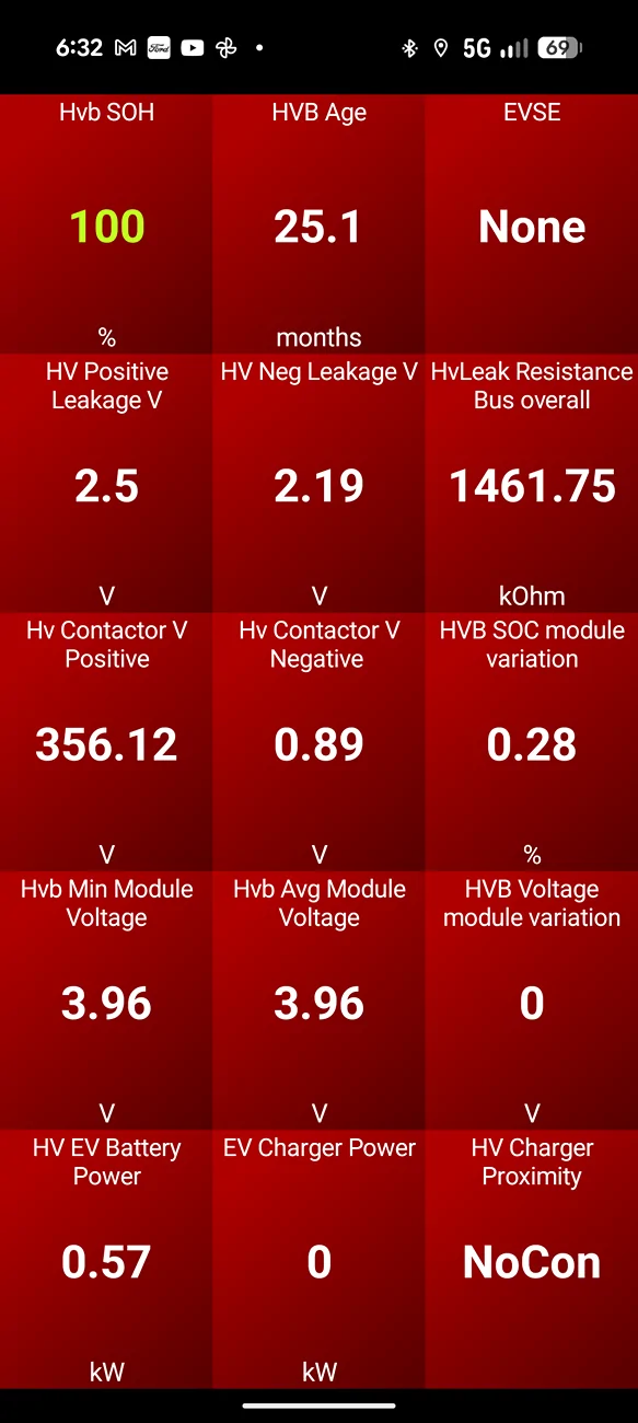

I agree. It is pretty damn close to a 20% variance which would explain why the current is ramping down so drastically at 80%.
For reference, here is my SOC and Voltage variation a couple of days ago. 0 Voltage and 0.28% SOC variation.

Thanks! Yeah, 18.5% variation is way out of spec!
