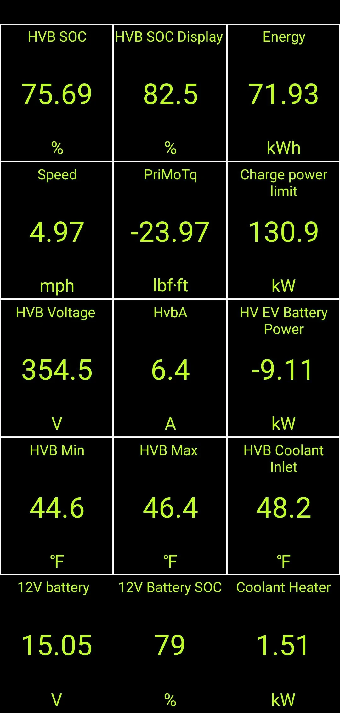

Battery preconditioning prior to DCFC - has anyone observed this working?
mparz00
Feb 17, 2022
Capital District, NY
'22 Lightning Lariat ER, VW ID.4 AWD Pro
Telecom network construction
Today I tried to enable battery preconditioning prior to DCFC. I set up navigation to drive to a 250kw evgo location about 15-20 minutes away. In the pic (taken about 10 minutes after setting up the charger destination), you can see the HVB temp and inlet coolant via Car Scanner. There was no change in the battery or coolant temp and no indication that anything was enabled. I'm wondering if this really works or if there are other parameters in play (outdoor temp, battery SoC, etc). Has anyone actually observed this working?

I was already on the road and asking about preconditioning while driving to a DCFC, not via departure time at home.

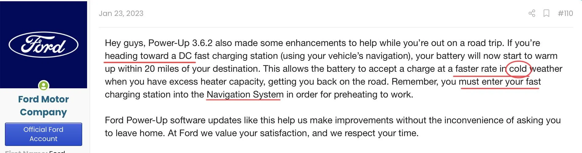

You're going to find plenty of thread derailers around here ...... awhile ago FORD had a promotion linked to one of the OTA's (forgot which one) where they highlighted how the using FORD NAVIGATION to a listed DCFC charge station would help manage the cooling or warming of the battery for optimum charging. At the moment I'm not seeing the thread.

Looks like your battery was ready. 44degf isn't too cold.

You must see that the destination has the charger symbol next to it.

This doesn’t really help. But here is screenshot from a time ago.
Ford F-150 Lightning Battery preconditioning prior to DCFC - has anyone observed this working? IMG_3867
4,272
5,697
You have to tell the nav you want to navigate to a charger, then select the charging location from the presented list. You can’t enter the address of the charger.
