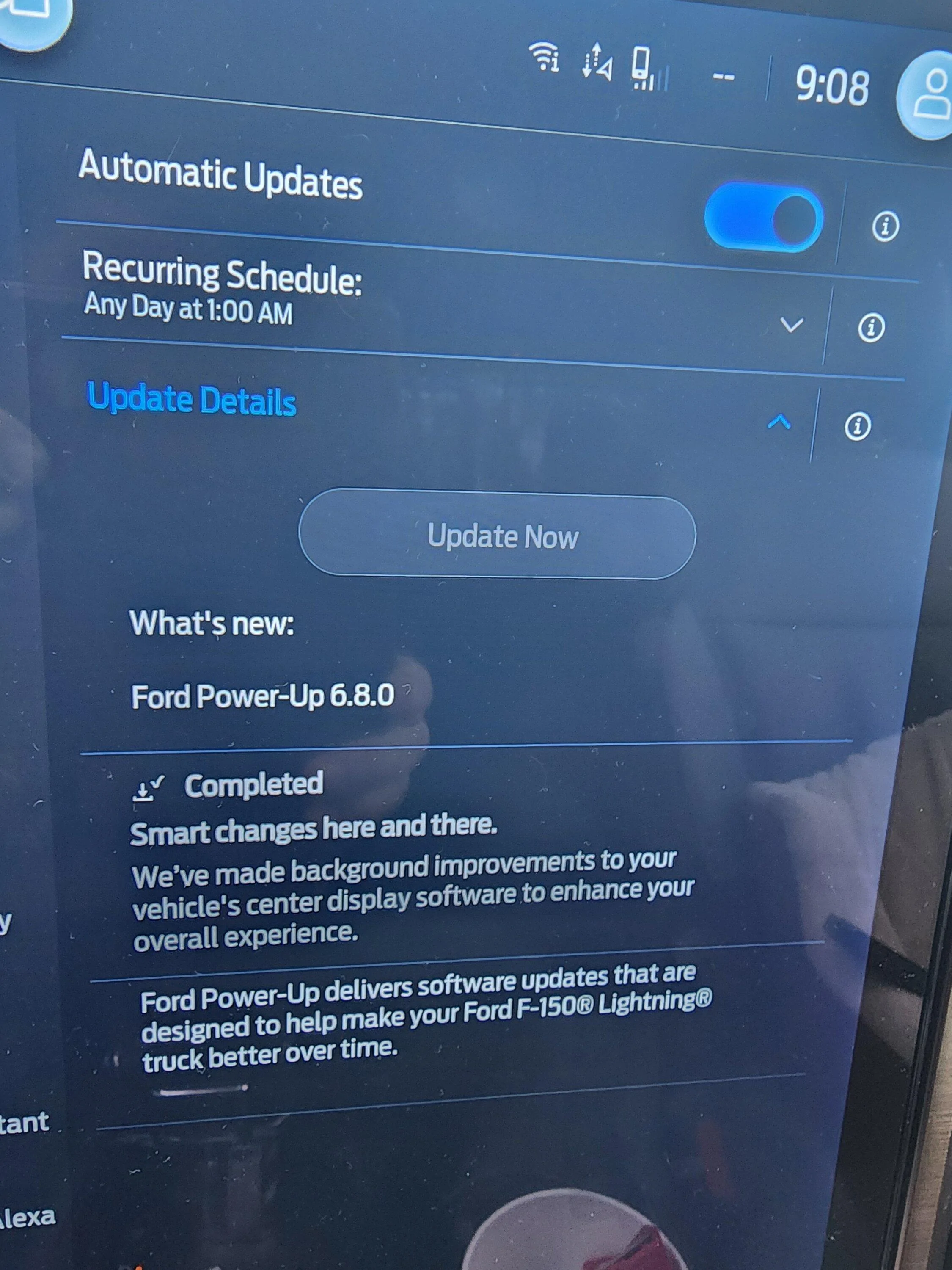

I got the letter the same day I had the appointment. They also did software updates which were not happening due to the sensor issues. Hopefully they happen no at home. And hopefully we soon get the BlueCruise update that changes lanes.
