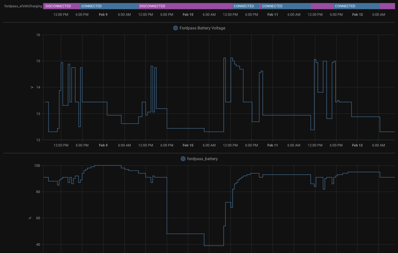

I haven't gotten this BMS recall completed yet, it's the last recall/CSP I'm waiting on with the part being on backorder. I have home assistant and the fordpass integration and was trying to correlate battery voltage with battery percentage as reported by fordpass which lead to this curious discovery. I'm interested to see if this pattern stays consistent when I get the new BMS sensor. Whenever I plug the truck in (FCSP), it seems fairly consistent to maintain the LVB around 12.88V which in turn gives a high % reported. When the truck is just sitting, unplugged, and in this case in cold weather, the battery voltage drops pretty quickly and also reflects a drop in % reported from fordpass. Interestingly, while driving, the voltage goes up around 15V and the percentage yet again goes down. So to me looking at this data, the percentage will actually decrease when deviating from 12.88V in either direction, albeit less detrimental to the reported percentage when over 12.88V. Of course there may be more math being done behind the scene that we can't actually see, but just looking historically over the last month or so, this is a very consistent pattern I'm seeing.
Just to note: I have had no failures to install any OTA that I've received, they've all gone through with no issues (knock on wood). So the particular data I've screenshot I would call a healthy example of a good battery..?

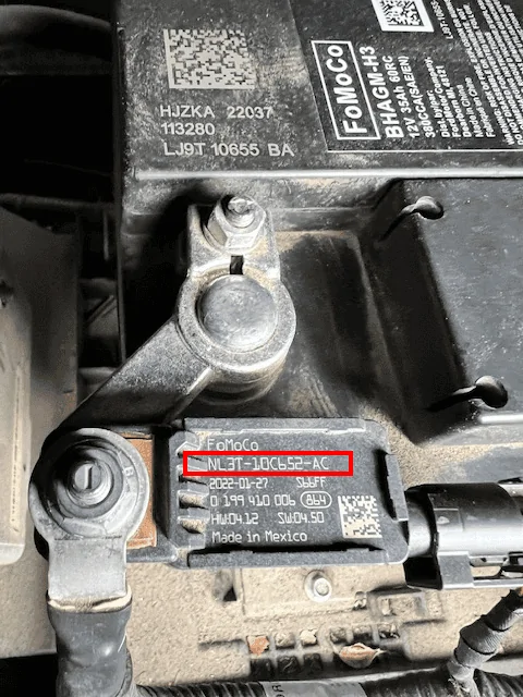

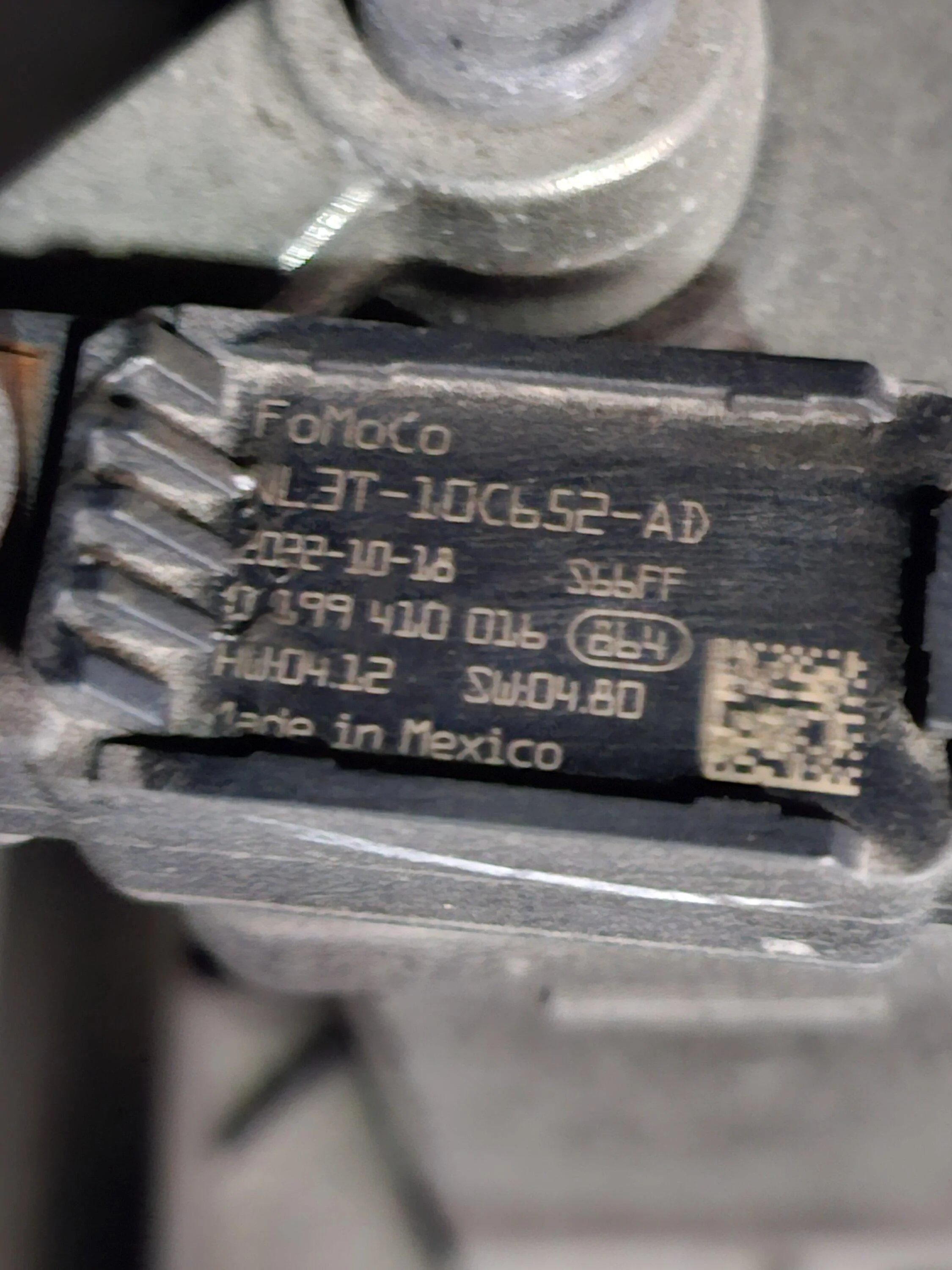

Who's affected: Lightnings produced from 14 Oct '21 thru 19 Oct '22 and '23 models produced 10 June '22 thru - -
Why is this happening: "The Battery Monitor Sensor (BMS) may randomly under report the actual 12V battery capacity during an over-the-air (OTA) software update, which means that customers might be unable to complete OTA software updates on their vehicles." Which probably has happened to most of us.
What am I looking for: BMS Sensor with either a part number of NL3T-10C652-AC or NL3T-10C652-AD.
I have the -AC version on my truck:
Contact your service advisor and reference CSP program number 23B70. They will need to see the truck to verify the part number you have now before ordering the replacement.
I've attached the relevant docs for you to reference and review.
You have until 5 Jan '25 to get this done.

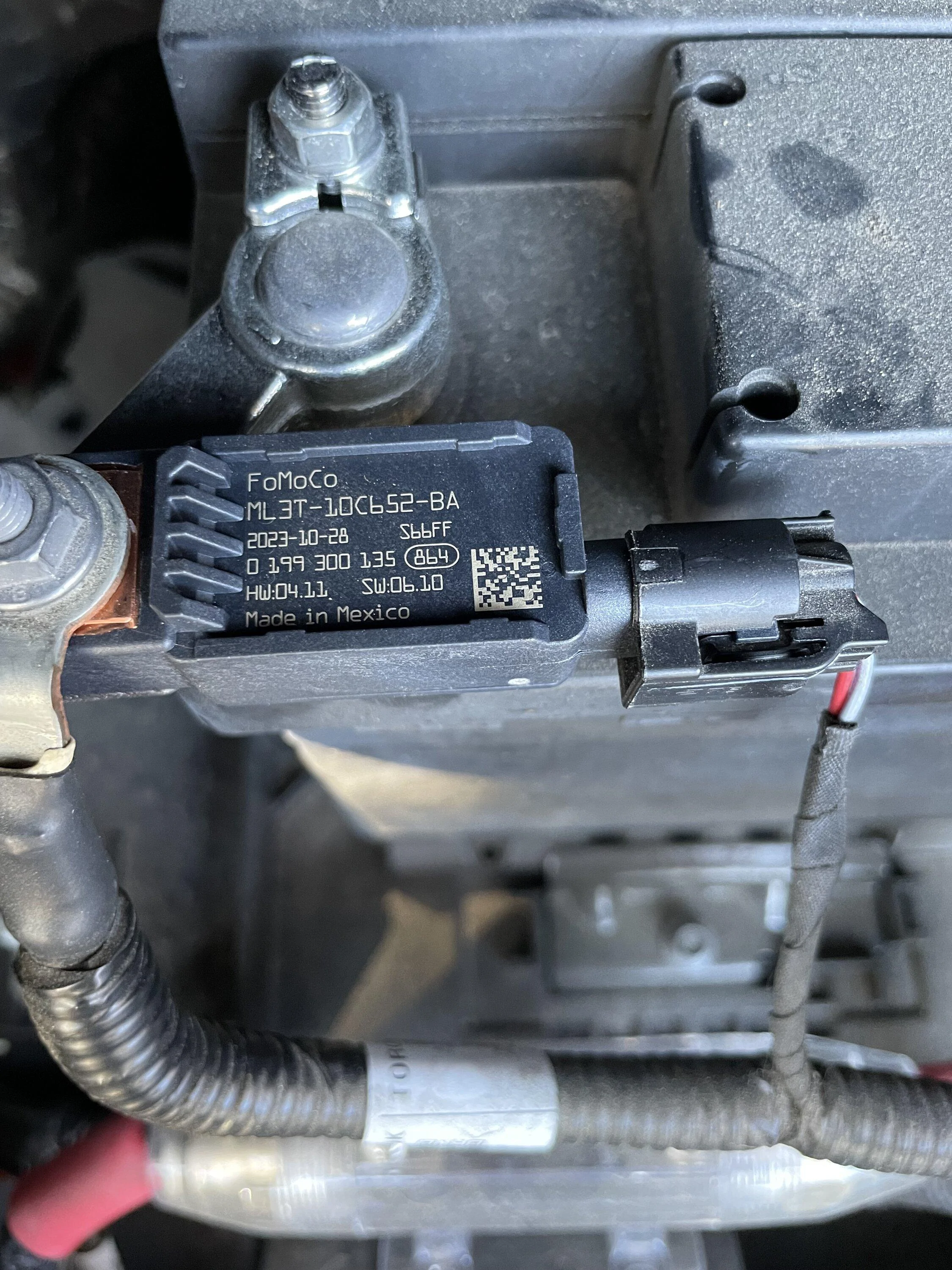

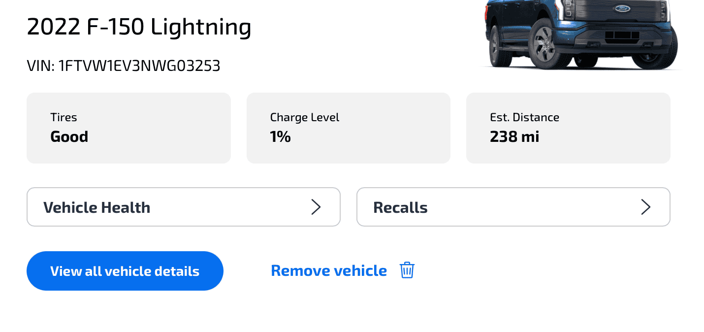

Had the sensor replaced this morning by mobile service. Total time under the hood was about 4 minutes. As normal had to close the hood manually and then he checked all of the windows - all operated normally.
I forgot to check my 12v SOC and the part number prior, however the new one is the same part number as others, manufactured in October '23, same SW version 6.10.

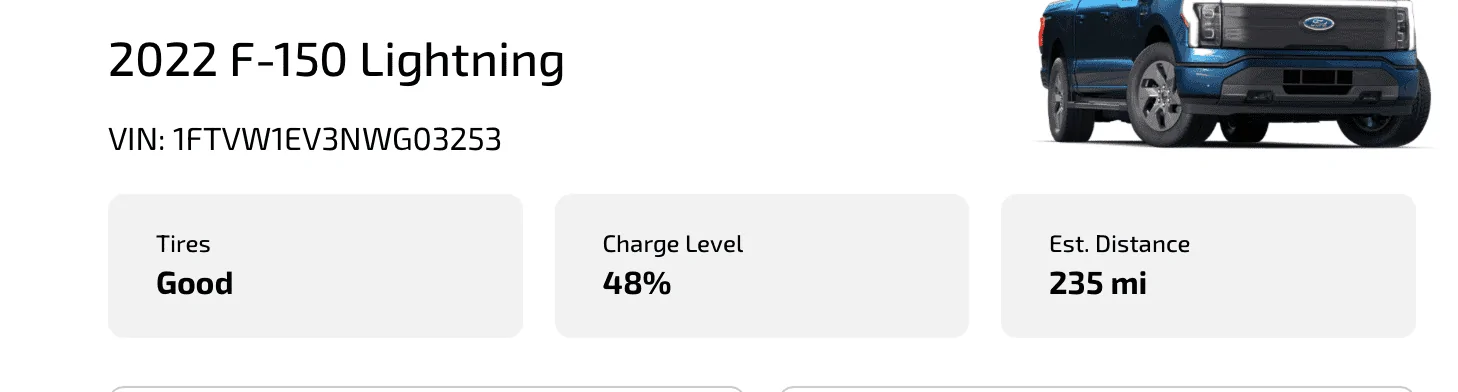

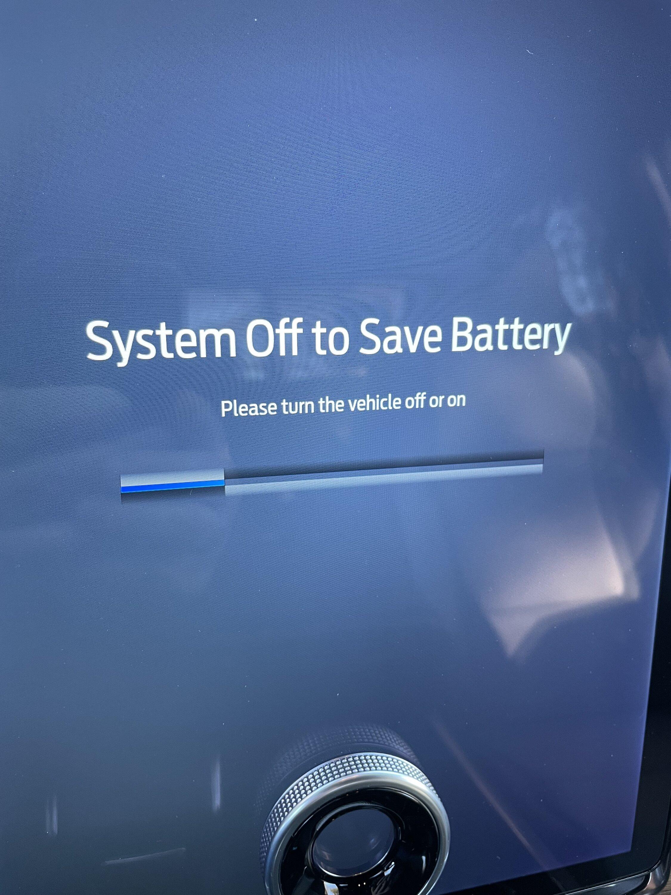

The interesting part - I checked the 12v battery on ford.com after the install - it showed 1 %. I decided I should go check the truck. Just as it did during our very cold spell when I opened the door I had no response of any kind. No dings, no graphics on either screen. Pressing the brake and the start button did bring it to life though. I drove it around the block and when I turned it off I got the "System off to save battery" message.

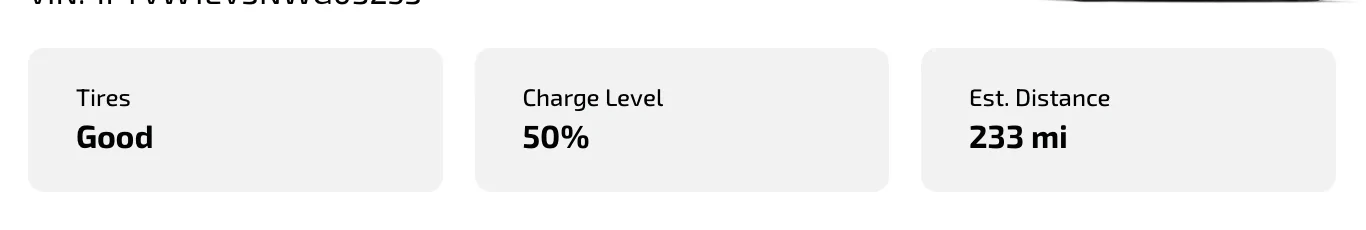

A couple of checks since then and the 12v showed the 1 %, then 22 %, then 48% and now 50%, but it seems to have stopped there, at 50% for about 30 minutes. So it did charge
Curious though, after replacement how does the sensor and the truck truly determine the SOC of the 12v and determine how much to charge?
I'll give it another drive in an hour or so and see if there are further changes.

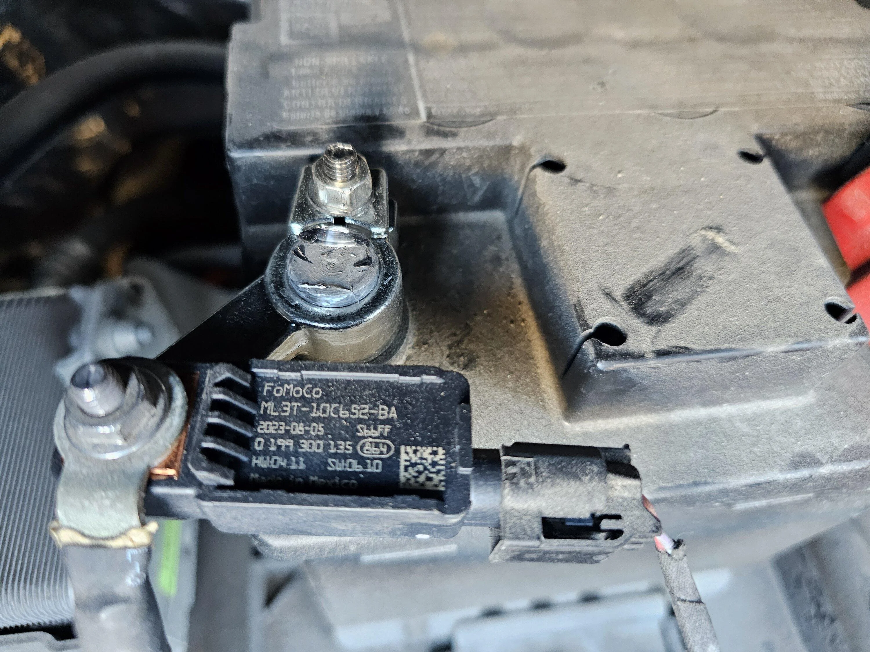

My Ford dealer already had the part in stock, surprisingly enough. They installed it this morning in 40 minutes. Attached are the old and new part.
Ford F-150 Lightning CSP-23B70 Certain 2022-23 F-150 Lightnings - BMS Sensor Replacement 20240214_132111
Ford F-150 Lightning CSP-23B70 Certain 2022-23 F-150 Lightnings - BMS Sensor Replacement 20240219_084044
For you Knowledgeable parts people out there. I see the new part in the pictures above show PN: ML3T-10C652-BA but, I have a copy of the TSB and the new part listed there is ML3Z-10C679-B. Are either OK or should I go with the one in the TSB?
