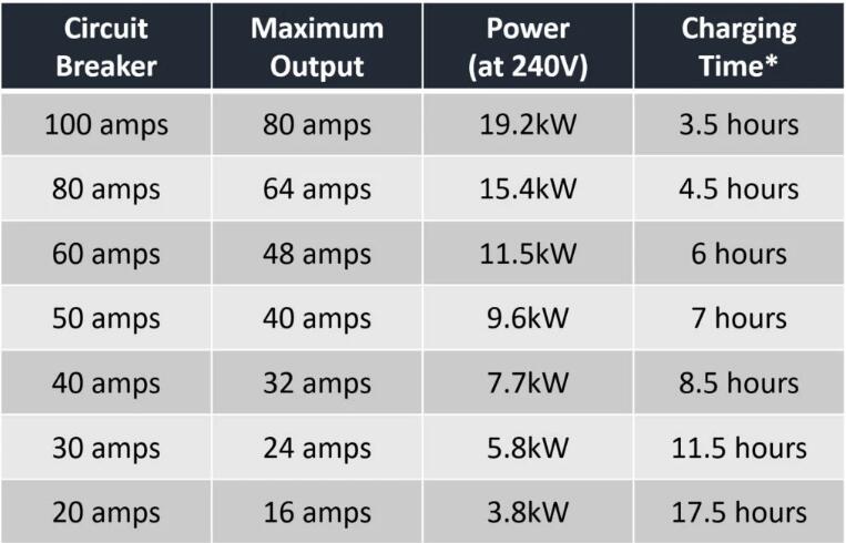

So I’m getting ready to install my ford pro charger. I will use 60 amp breaker and understand I will set the app to 48 recommended for that breaker. The charger will of course be hardwired. Using 6 -3 awg wire connected to 100 amp subpanel.
There’s a setting on the charger you set im
Assuming it may say in the directions but anyone know what setting I would set it on based on the info above ?
You absolutely MUST set the dip switch on the FCSP to match the breaker and wiring of your specific installation. You MAY set the the app to some lower level if you have a reason to.
Unless you live in Massachusetts your 6-3 on a 60A breaker needs to be MC cable, not NM. #6 NM is only rated for 55A.
