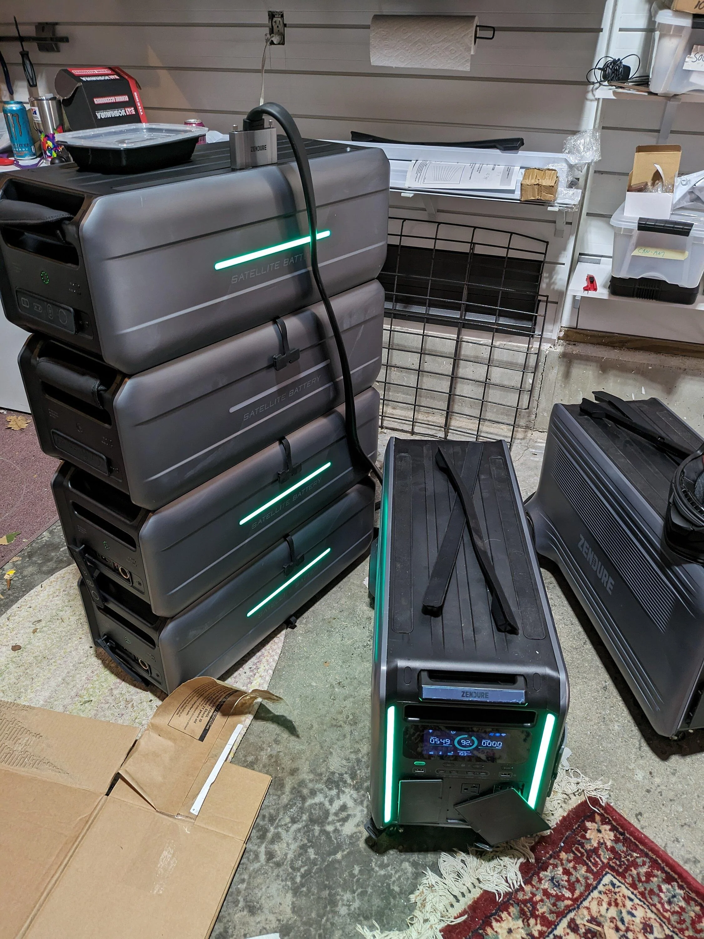

I have two Zendure Superbase battery systems. Each system weighs about 500 pounds and has a capacity of 32 kWh. I have to go on a long trip and it would be nice if I could load the bed with these batteries, plug them into the Pro Power plugs via a suicide cable, and charge my truck while I drive. Unfortunately the output of the Zendure currently isn't a high enough amperage to compete with a 1772 charger, so it doesn't make sense to use this as an overnight solution unless it's an emergency.
Has anybody figured out a way to accomplish this, or do something similar?
