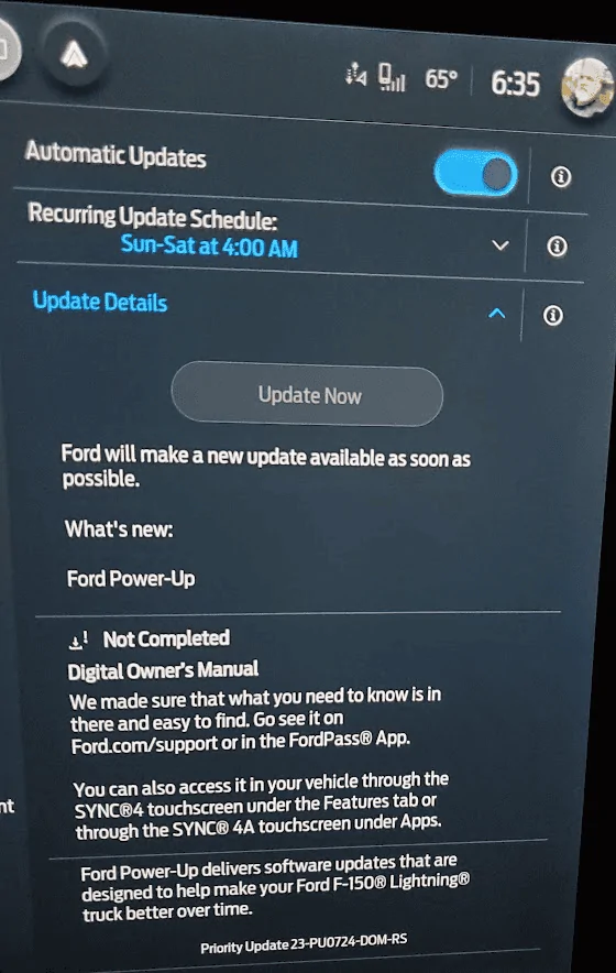

Waiting for a download to complete.
This is not the waiting to download screen. โ€œNot Completedโ€ means the OTA campaign for your truck and this update did not download and will expire without install.
Itโ€™s not clear why this happens, Iโ€™ve had it on a couple updates.
233
16,538
18,655
Thanks for the information, I likely missed the window to receive this because my AUTOMATIC UPDATE switch was off sometime after 9/15 when I got the DCFC update, hopefully this update and Presets update will recycle in the coming weeks.

If the Lightings are anything like the ICE trucks, having auto-updates on or off would not make a difference with this particular update. Auto-updates schedules are only for updates that require the vehicle to be inhibited and this update is not one of those.....most aren't. Updates that do not require the vehicle to be inhibited will download upon turning the ignition on after the OTA trigger is created an if the files download properly and the GWM signs off on the update, it will install regardless of the auto-updates schedule.
If you post or PM me your VIN, I can check PTS to see if the OTA trigger expired or not and if it did fail, the reason for failure (although sometimes, the error codes provided as the reason for failure are things I cannot make sense of).
Are you able to see if an update was even scheduled for the truck? I have not received any of these recent updates. I'm still waiting for those from summer.
Yes, up to a certain point. PTS supposedly records up to 60 days worth of history, but in the case of failed/installed updates, it can record a lot longer than that.

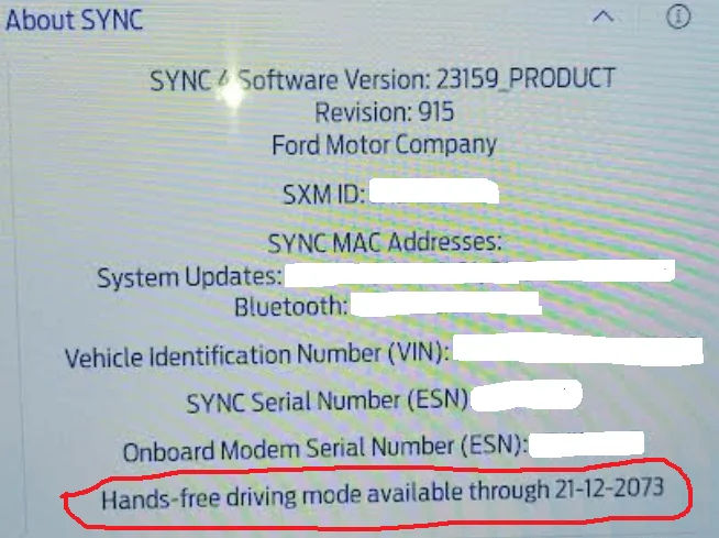

Got may update yesterday and I noticed the SYNC version as well. But look at the the date of my Hands free driving mode? :unsure:
Thatโ€™s just the map expiration date. Ford put in this long date so they didnโ€™t have to keep moving it every 6 months.

@TaxmanHog are you still in update Limbo like I am with this?
Nope, I got it to process on 10/6/23 after letting the truck idle for almost 4 hours bringing the LVB SOC high enough!
